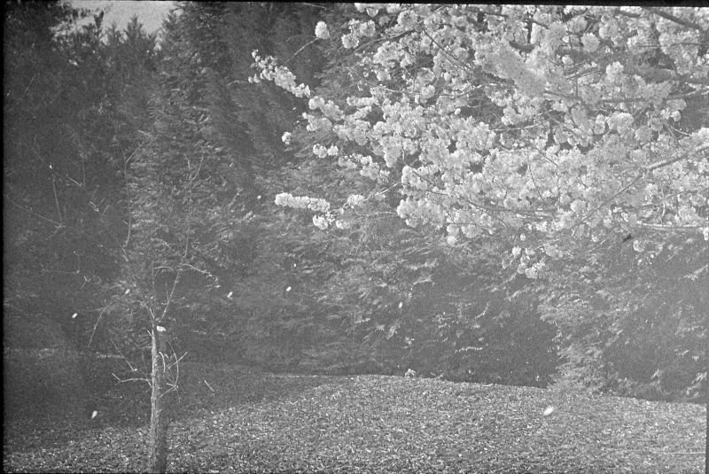

Mixed results on some trials this weekend,
Lucky 100 SHD
1. Temperature 30C/85F
2. Develop F76+ 1+4 (paper strength) 5 minutes
3. Rinse
4. Bleach 3% peroxide + Vinegar 30 minutes
5. Rinse
At this point I noticed that bleach had not done much, I could see negatives
4B. Bleach 3% peroxide + Vinegar 30 minutes
Slow bleach,
6. Reexposure
7. F76 1+9 5 minutes
8. Fix
Bleach step didn't do much, it all turned black
Double X
3. Rinse
At this point I began bleaching with top open and inspect
Kept bleaching for almost 90 minutes, until it was there
Placed the tank in hot water to keep temp up
5. Rinse
6. Re-exposure
8. Fix
Base stained to a gold/brown color and images are there but hard to see.
Double X - Cherry blossoms
Posts: 313
Re: B&W Reversal
ISTR the gold/brown staining is down to the bleach (there was a thread on APUG).
How long between the two attempts, or did you mix fresh bleach each time? What temperature was the bleach? Do you have any Rodinal or PC-TEA?
You've now made me think I need to try this again, perhaps with 120.
Posts: 779
Re: B&W Reversal
P C Headland wrote:
Wed Mar 25, 2026 3:37 am
Bleach was fresh each time, a few days passed between one another.
I began bleaching at 35C and in the 2nd attempt kept in in hot water so temperature was betwen 30 and 35
What was interesting is that there are portions that are not bleached, despite the agitation. It is as if the bleaching began in a "front" and kept moving until the are was bleached.
I do have Rodinal and F76+ is like D76 which should work as well.
I found that home depot has 12% peroxide in the cleaning section, will try that next
