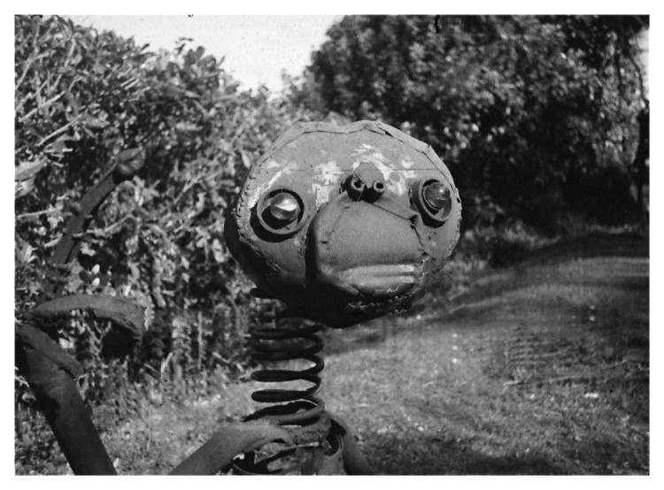

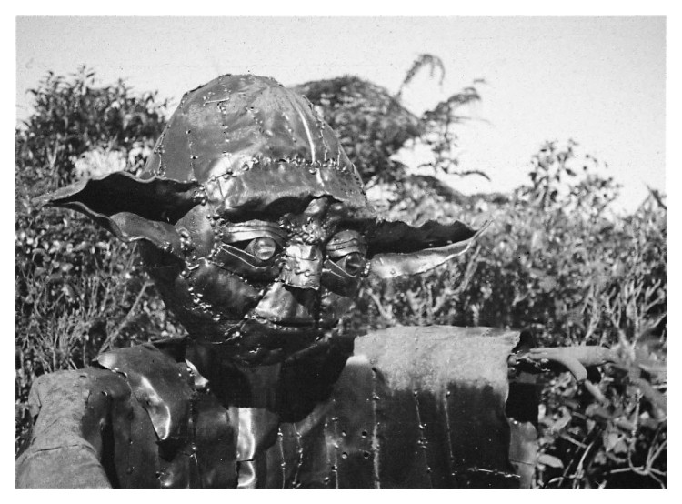

I got a couple of 3D printed cassettes & had a slitter 3D printed to slit my own B&W. I sacrificed a short roll or two of 35mm film to practice slitting and loading. The slitter required a bit of fettling so as not to scratch the film. It's still not perfect, but I seem to have reduced the scratches. I also had a 8x11 reel 3D printed at the local library that fits my Jobo tank.
I wasn't really expecting I'd get any usable images from this test roll, but there must have been some alignment in the force. There were still some horizontal scratches, but I managed to clone them out semi-successfully. Given I had some success here, that now means I'll have to try a little more seriously next time.
I meet these two chaps on my lunchtime walks, the work of a local artist who makes some interesting sculptures out of bits of scrap metal.
The film was Ilford Pan F+ developed in HR-DEV 1+49 (IIRC, I forgot to make a note). Scanned using my Panasonic G9 with 45mm macro and a home-made black card mask in a Kaiser FilmCopy camera scanning kit I picked up for a good price not so long ago. It came with a full set of masks from 35mm up to 6x9. A beautifully made bit of kit, just like the little Minox.
Yoda and ET caught on film
