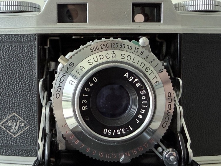

So, the camera arrived, a rather clean looking Agfa Super Solinette. Everything seemed to work well and the camera was in fine cosmetic condition. I loaded a film and wound to the first frame. And kept winding, and winding and winding. Hmm, something's not right. So, a quick look online and the top's off. The flat spring that governs the frame spacing mechanism had somehow popped up too far, so the lever would not engage in the frame counter. A bit of poking around to work out how the mechanism worked, and the flat spring-steel spring was persuaded back into the correct position. I also checked the RF and lens focus (spot on) and cleaned the helical so the focus is now nice and smooth.

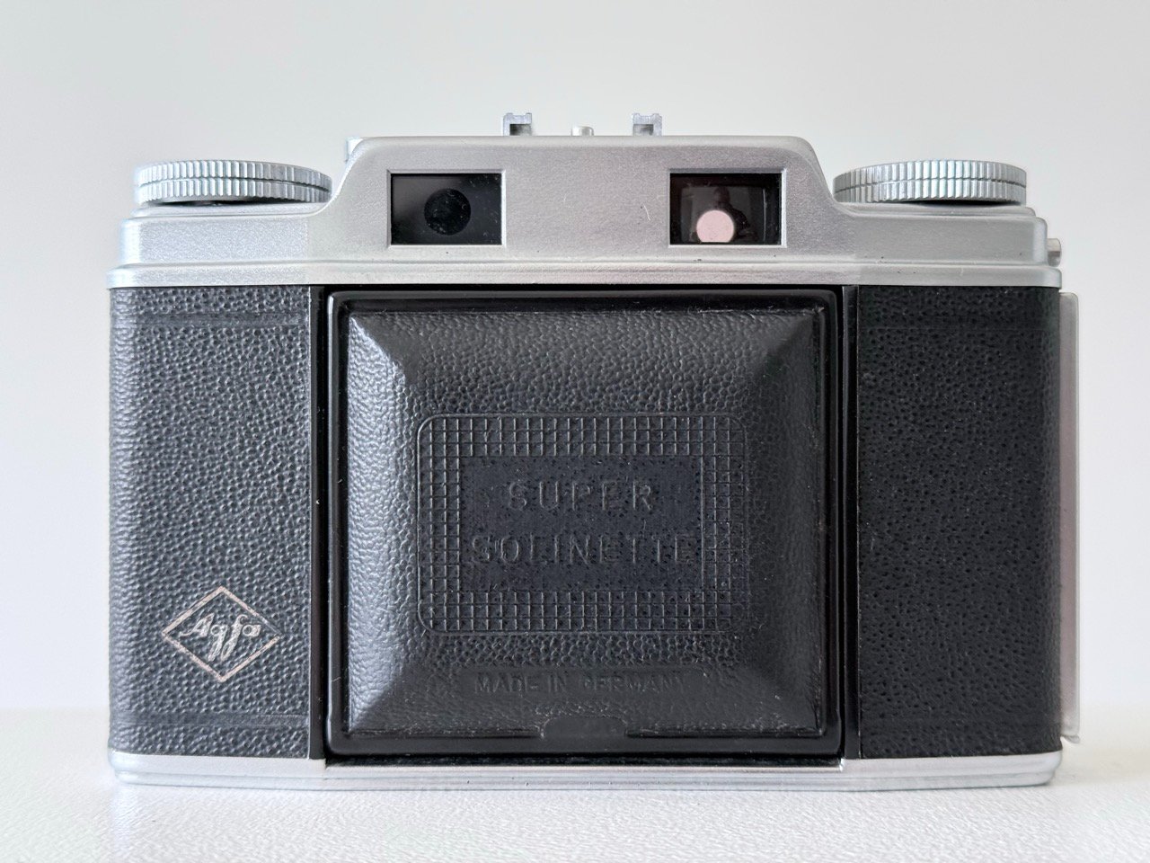

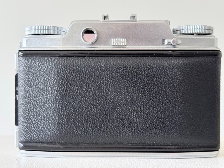

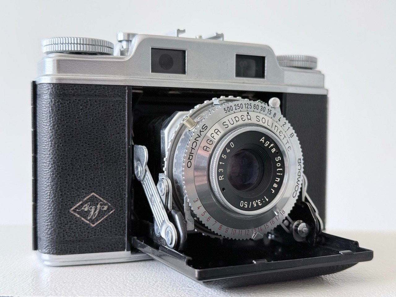

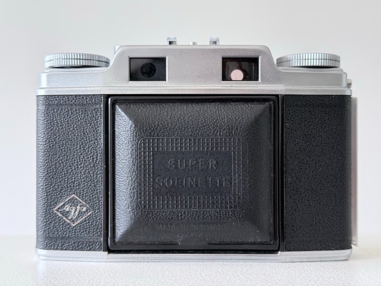

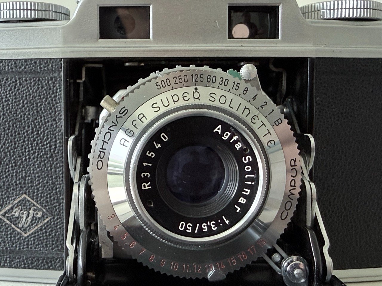

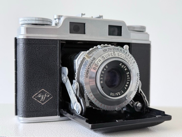

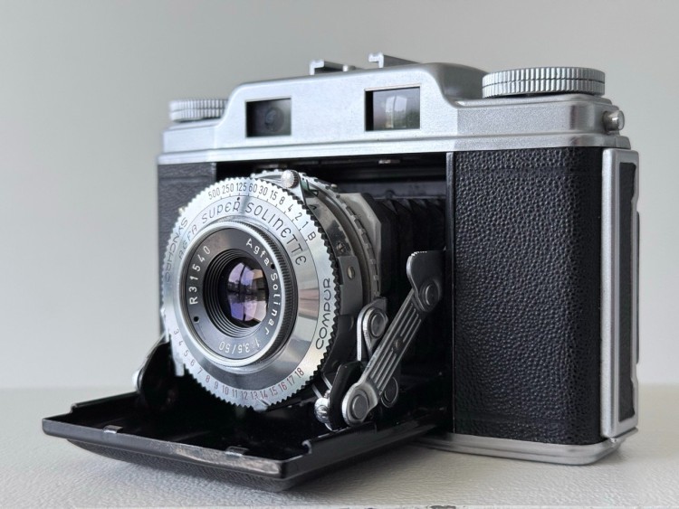

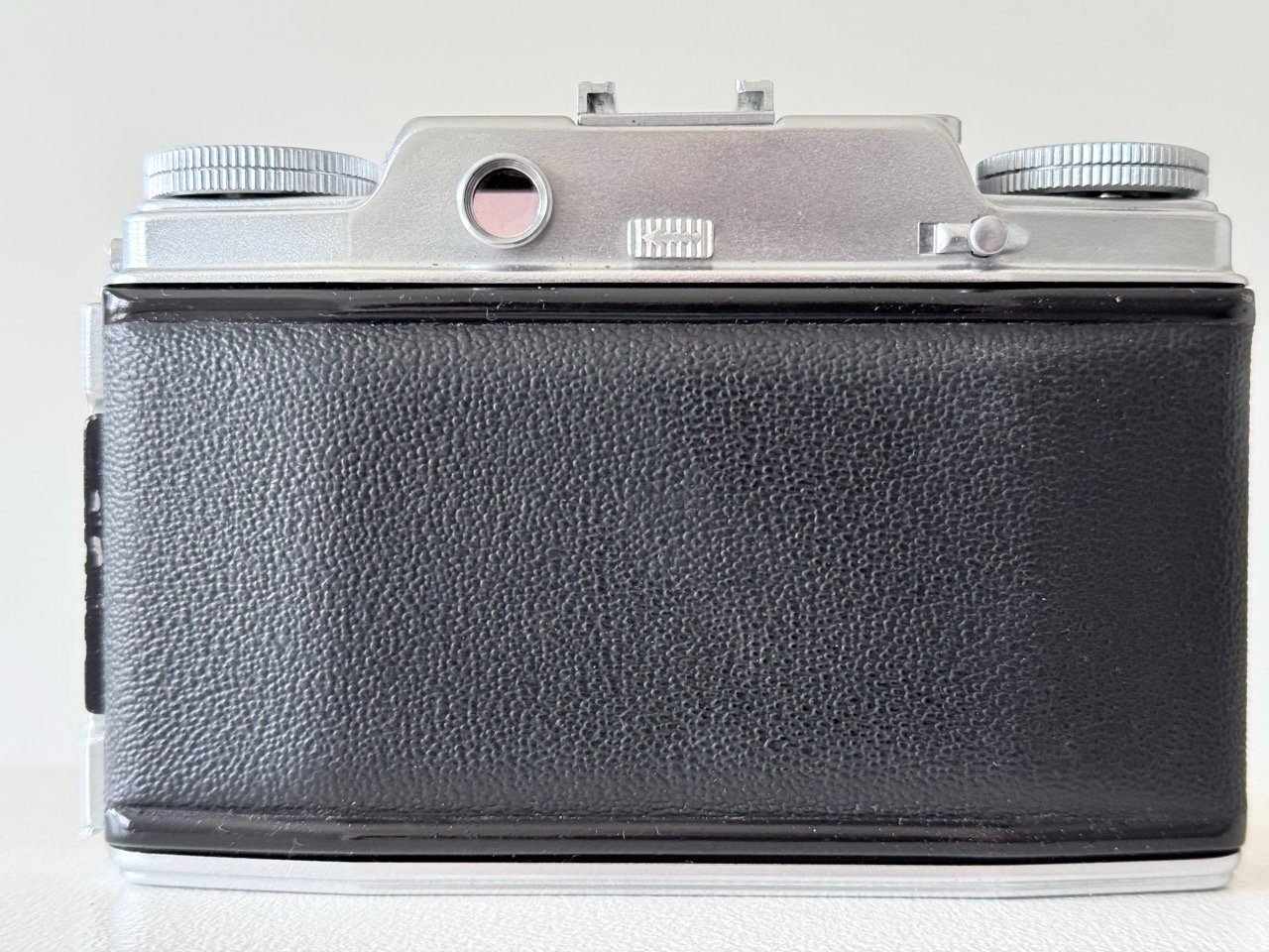

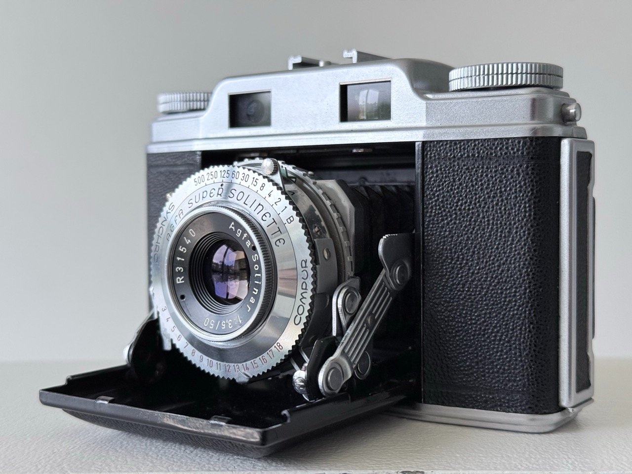

And the wee beastie itself:
