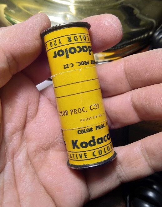

So I came across a roll of Kodacolor film that uses the C-22 process. Can I process this using standard chemicals for black and white film?
I know that I can do a Google search, and I guess that I will at some point, but I thought that I would ask what others have found to be successful for them.
The roll of film in question.

The only I have tried went fairly well...
viewtopic.php?f=13&t=1745
HC-110 dil. B 5min
I hope it helps :)
Posts: 570
Re: Processing Kodadolor film
I have done it. It worked. I just used my standard: D76 1:1. The quality was not great, but the roll had been in somebody's (Texas) garage for a couple decades...
I have had some luck with it in C-41 at room temp.
