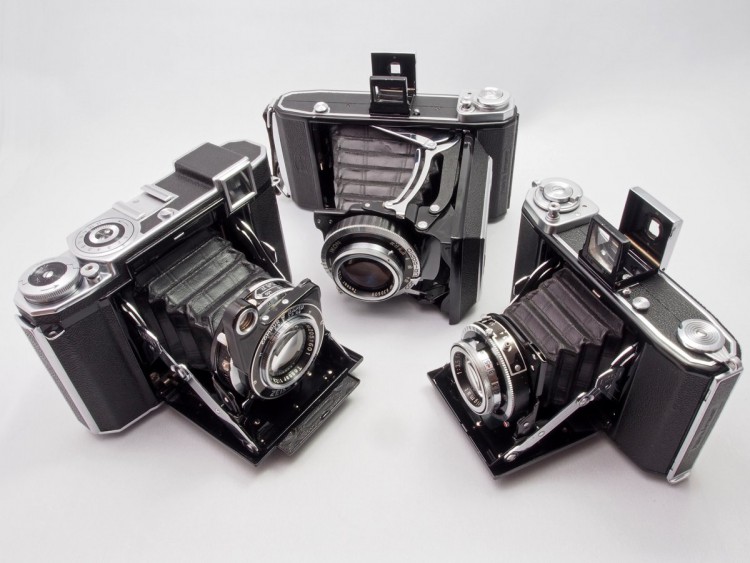

Yesterday a third member joined the Ikonta family : a beautiful 532/16.

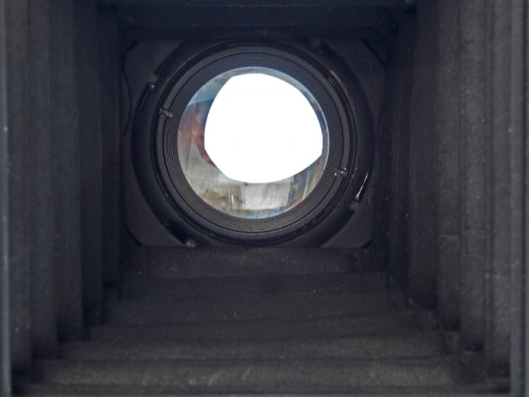

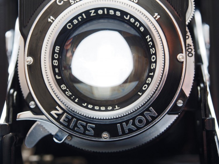

There is one problem though : the diaphragm has an odd shape (see picture) and the aperture ring cannot be turned all the way to F/2.8 - there is a strong resistance at about F/3.5

Probably one or more pins are out of their place, only opening that part can see the damage or just reposition then.
I should have spare blades for that lens if needed or just the whole back shutter part with the working aperture ring, from a 530/16 same stuff.
Nice cameras!

Definitely a beautiful group, Benny. Most likely what has happened with the 532/16 is the reason it was sitting in storage for so long. A disassembly, clean, and lube are in order.

Yesterday I carefully turned the aperture ring back and forth a few times without forcing it beyond about f/3.5 where it blocks. That opening changed its shape almost every time. Suddenly I could see one dislocated iris blade move across the gate.
I carefully screwed out the back lens and removed that iris blade to avoid further damage. That's about how far my repair skills go. The blade is semi-circular and has a few rust spots, a wrinkle and a small tear in it.
As it is now the camera is probably not going to produce good exposures.
