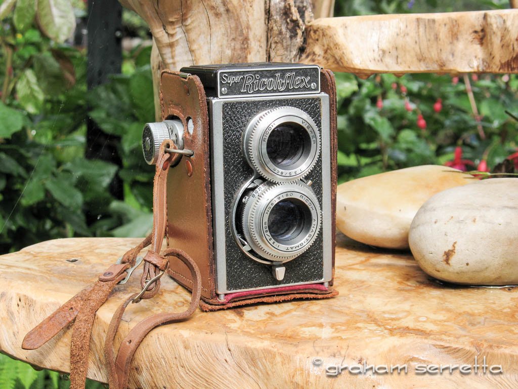

Super Ricohflex
I have had this beauty for many years. It was a charity shop find for £5.00. I am ashamed to admit that I have never shot a folm with it, as I no longer have the means to develop the film. I will put 120 developing on my to-do list for this winter. By repute, the Ricoh Anastigmat f3.5 80mm is very good. The camera has a very solid feel. I will have to service the focussing system as it is very stiff.
That SuperRicohflex is a highly under-valuated camera
I bought one years ago as well, and it is a very good TLR
You have the 35mm counter, and with an adapter you could shoot 35mm.
I made an adapter for 3D printing which works fine
