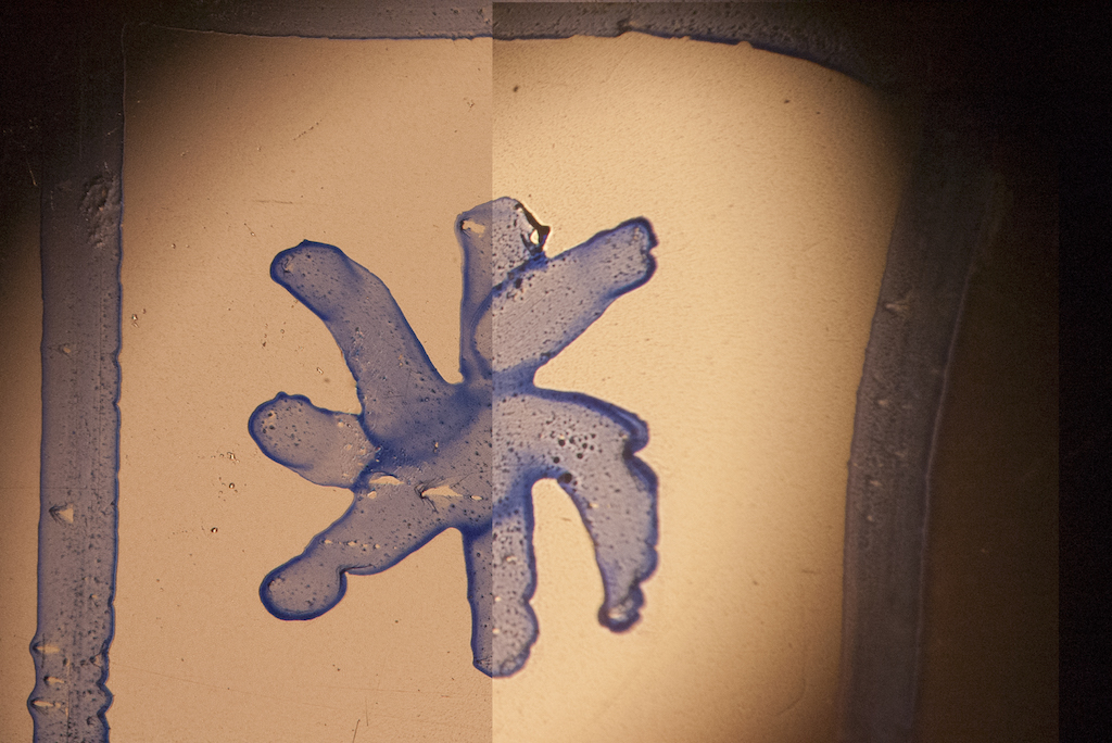

I was focusing the flag holder but the focus was about 1.5m-2m away as you can see. So I went to collimate the lens to infinity again, which one for you is well done? Left or right?
The left one is the new position, pictures were taken with the right one. I hope I did it correctly this time

As Mike describes in his web.
Digital camera with zoom, its lens to infinity in front of the test camera lens in with the door opened to a source of light, test camera lens to infinity (or what I guessed its infinity, best image definition.

I go with the good old tried and true method of focusing on an object that is a minimum of 100ft/30m away, utilizing a "ground glass" made from a broken CD case with frosted tape on the side that faces the lens, cut to size and placed on the film rails. Either way, if you make the mistake of putting the ground glass on the outer rails that help guide the film through the camera, then you will always be off a bit, as the target side would not be within the film plane.

Im happy finally, the collimation is done well (I think)
https://flic.kr/s/aHskuDNTKh
Please let me know if something is not correct for you and why, I added speed/aperture and focusing distance.
For focusing I used a Voightlander external rangefinder (I came last week) and its accurate (+- 0.5 metres)
