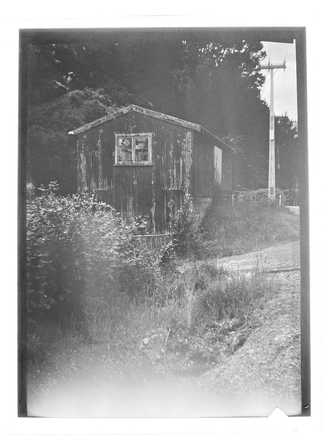

I did two sheets from the 9x12cm Zeca folder. I think I loaded these sheets more than 5 years ago, probably more like 10! They do seem to have suffered a bit, plenty of light leaks. Still, the reversal process seems to have been relatively successful again.
First two shots are after the bleach and before re-development:
The next two are phone snaps of the sheets on the light box:
I think I'll shoot a couple more experimental rolls and try with PC-TEA instead of Rodinal for the developer.

the 1st image (hills and meadow) is impressive

Well, I reversed a couple more sheets, loaded in the new changing bag. Fewer light leaks and less fogging than the previous ones. Subsequent rolls of 120 and 35mm show no light leaks from the new bag. These holders were loaded so long ago who knows how light-tight the changing bag was back then.
Anyway, better results which will give me more confidence to try some more. These are 9x12cm Classic Pan 200, developed in Rodinal 1+20 for 10 minutes, then 20 minutes bleach, re-exposure then 10 minutes in the second Rodinal 1+20 developer. These are iPhone snaps of the sheets on the light box.
