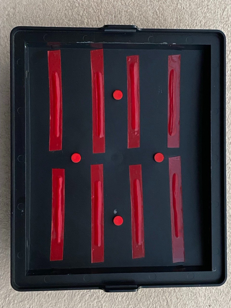

Hey, Paul - did you rough up the bottom of the tray to prevent the film from sticking while processing? I've heard that some people did that for that very reason.
Posts: 329
Re: Agfa Isolar 9x12cm plate camera
Sort of - I created some ridges by taping down some wires using plastic tape. I did this initially so it was reversible, but it's been like that for more than a decade now! I've never had any problems with sheets sticking.
I've read others have used epoxy or hot melt glues.
