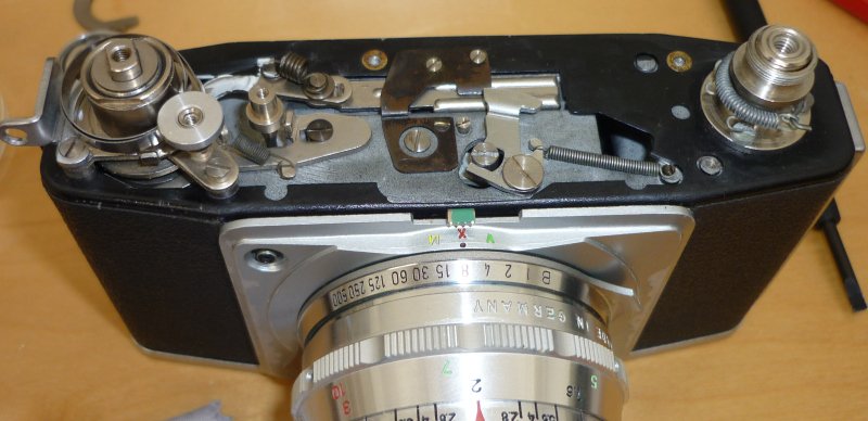

Trying to figure out why the RF was only good between 1 and 3m
At the end it was some grease (green Agfa goo) in the arm for the spli-beam mirror
Posts: 2457
Good old Bayer grease, always gumming up the works on an Agfa. But then I don't think they ever planned on the cameras not being serviced in 50 years.

Mirror return is very lazy. Let's see if I can get it to work more or less OK without tearing the whole thing down :D
Posts: 1408
Hope you can revive it. Not an easy camera to work on, according to my technician.
Posts: 252
Amen! Even if it does not "phoenix", I'll put the lens in another camera

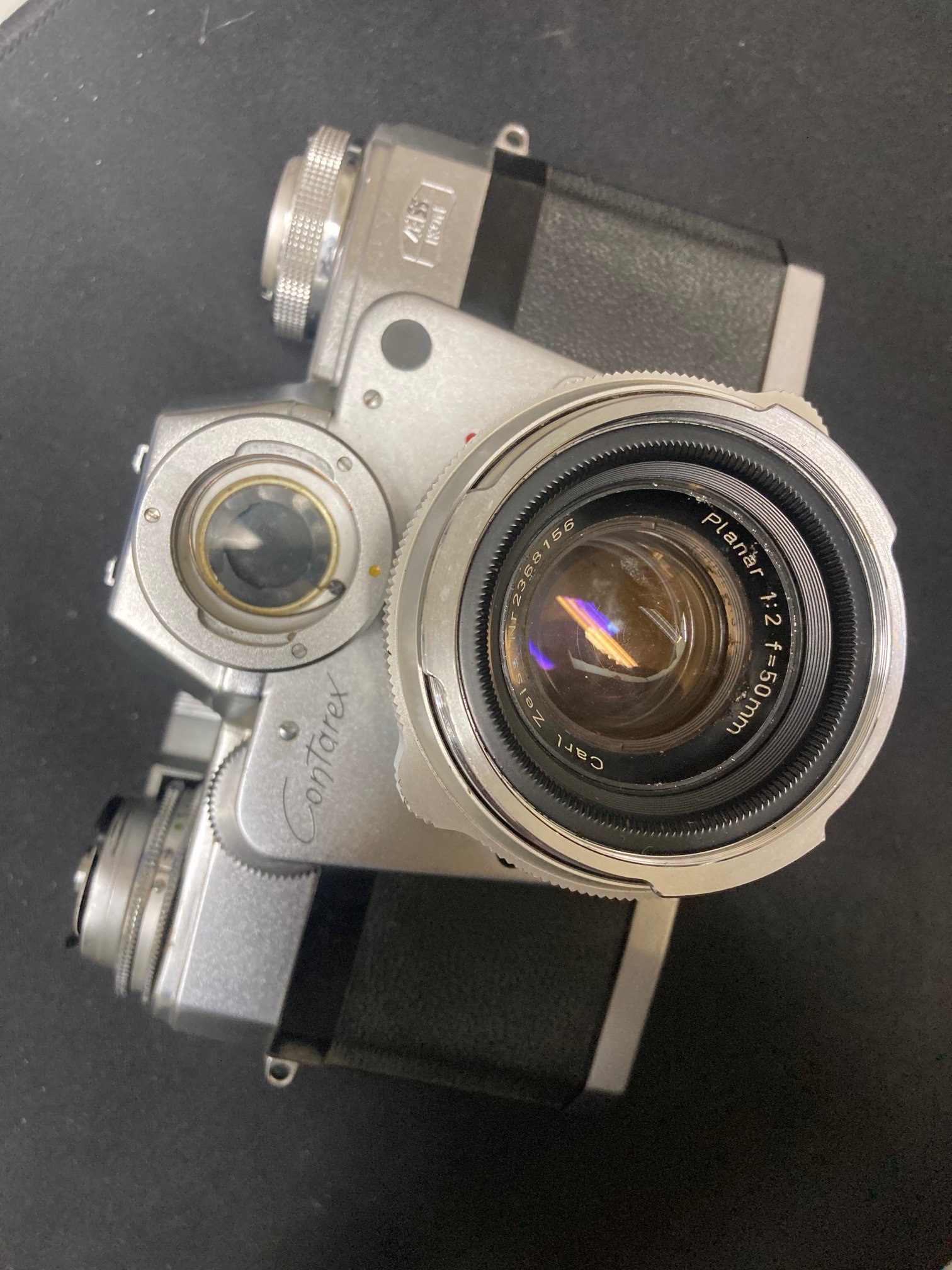

Congrats, Santiago!
I'm tempting myself with Contarex, that Planar is something extraordinary!
Posts: 252
Alex, I say go for it. I'm using it with a cheap adapter and I'm absolutely loving it.
