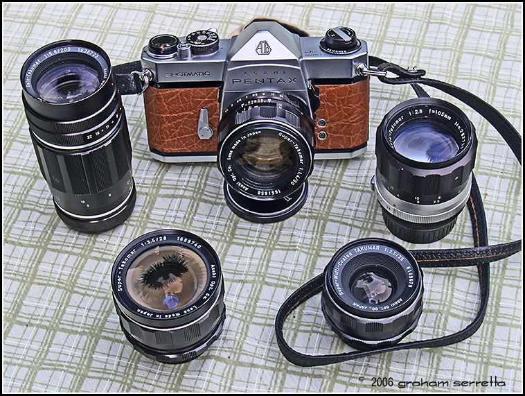

Thanks to a very good friend, I can now boast to have an Ashai Pentax Spotmatic SP in my classic camera collection. It is a camera that was purchased new by it's original owner in 1967 and who carried it with him every day for half of his life. It was retired due to the convenience of digital imaging, and came to me well used but in very good condition, apart from a sticky mirror and the two highest shutter speeds both running at 1/1000th.
The mirror problem was cured by a clean and lube of the mirror release latch mechanism, and while the camera was on the operating table, I decided to fit it with a new set of clothes to cheer it up. The material I have used is synthetic, and is all that I had to hand that was thin enough for the profile of the camera back. I may change it at a later date for real hide. I have not adjusted the shutter speeds as I do not have a reliable method of calibration yet.
The camera was fitted with a 50mm f1.4 Super Takumar that showed a slight yellowing, but which has now cleared after copious doses of UV radiation thanks to our abnormally dry, hot summer this year. I was also blessed with the gift of a 200mm f5.6 Tele-Takumar and a 28mm f3.5 Super Takumar. I already had a 35mm f3.5 SMC Takumar and a 105mm f2.8 Auto-Takumar therefore my lens collection is well represented. The meter battery is still the Wein cell fitted by my friend - I will fit a more appropriate substitute for the original mercury battery, but the meter is spot-on now. I was surprised at how relatively slow the meter is to react to changing light compared to mu Olympus OM1. Maybe it has something to do with the battery capacity, because the Wein cell is very tiny and has a plastic collar to hold it centered.
