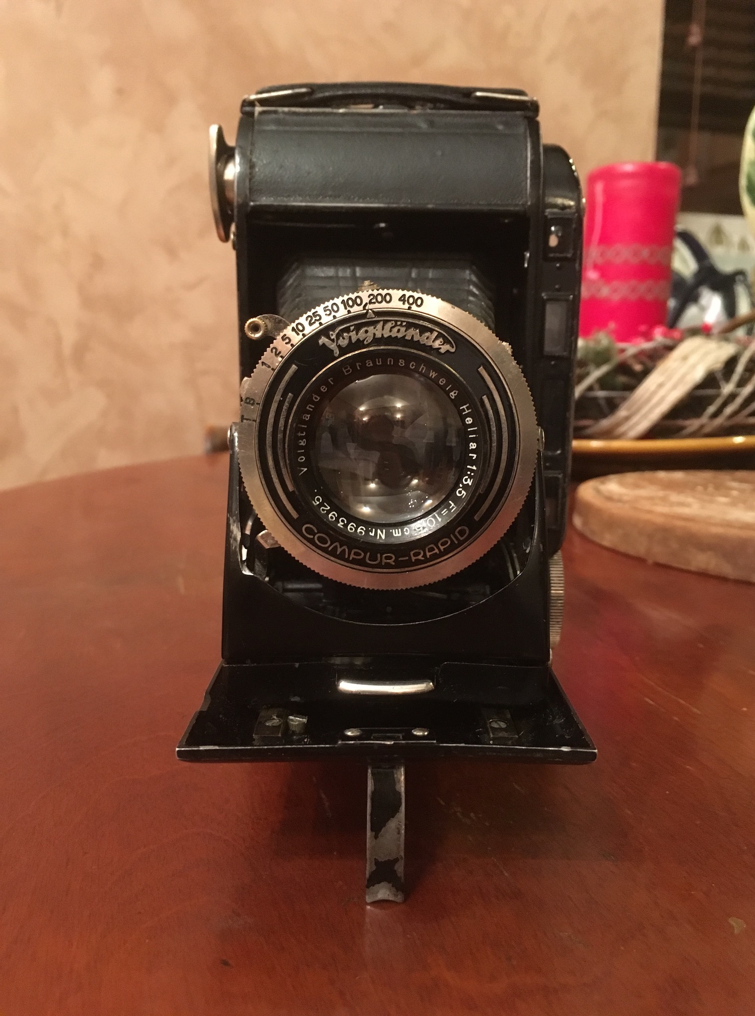

Omg, this is a non-stop and I already have in a queue the Zorki and an Ikoflex, plus the final fit for the 530...
This evening I saw an ad of a Bessa RF 6x9 for less than 100 USD, truly I was 5 minutes looking for fakes and when a friend phone the seller was quiet strange, even from being a local... So I realise that the seller was the same I took the Super Ikonta 530 (his grandpa died and he was selling his cameras). Trusted source!! I came 30 min early to the meeting reading as much as I could about that camera and how to check it...
For parts: Lenses are awesome, no flaws at all, nothing, zero, niente, nada!
Speeds sounded good, now at home I checked and 400 are 210, 200 are 125 and the rest are nailed!!
The shutter release... Goodness!! Feels sooooo good, if you never tried the side shutter release from a VG I think you are missing a lot!
Bellows, looked nice, but at home I found two tiny stars, I discovered the actual bellows are glued to the back, Im going to save some money and contact Sandeha for a quotation.
Blades: Dry, nice, all.
Rings: Smooth.
Interior: dust and a bit dirty... qtips ready...
Rangefinder: Needs to be fixed. Yay!
Leather: Dry, needs some kiwi and cocoa virgin oil :)
Im planning to do a test shoot this week, even with the two micro holes... Cant wait...
Welcome to the new lady:
Yes, that is Heliar lens ;)

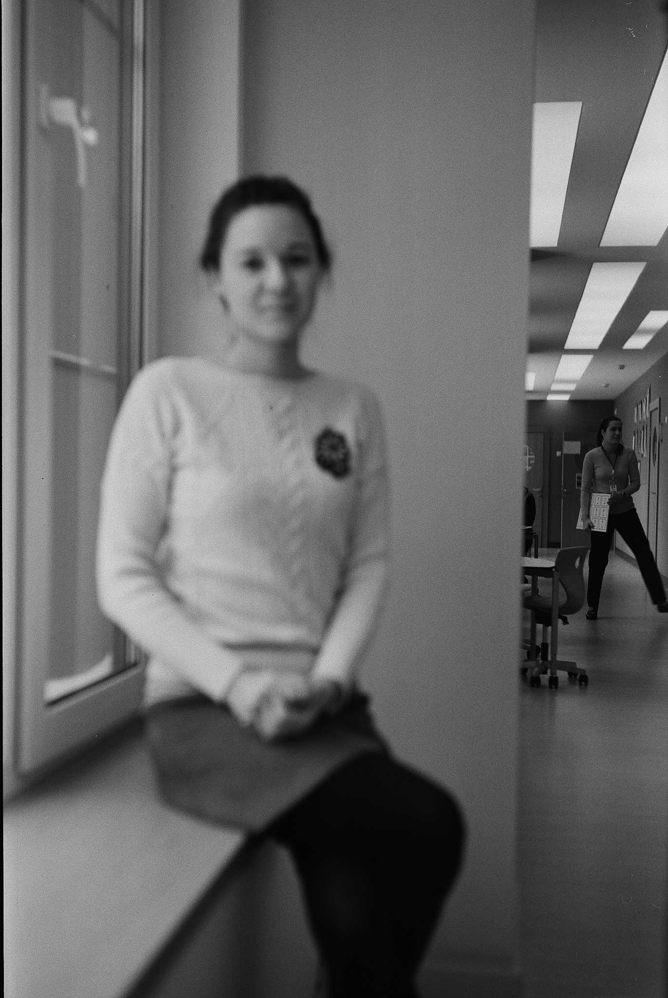

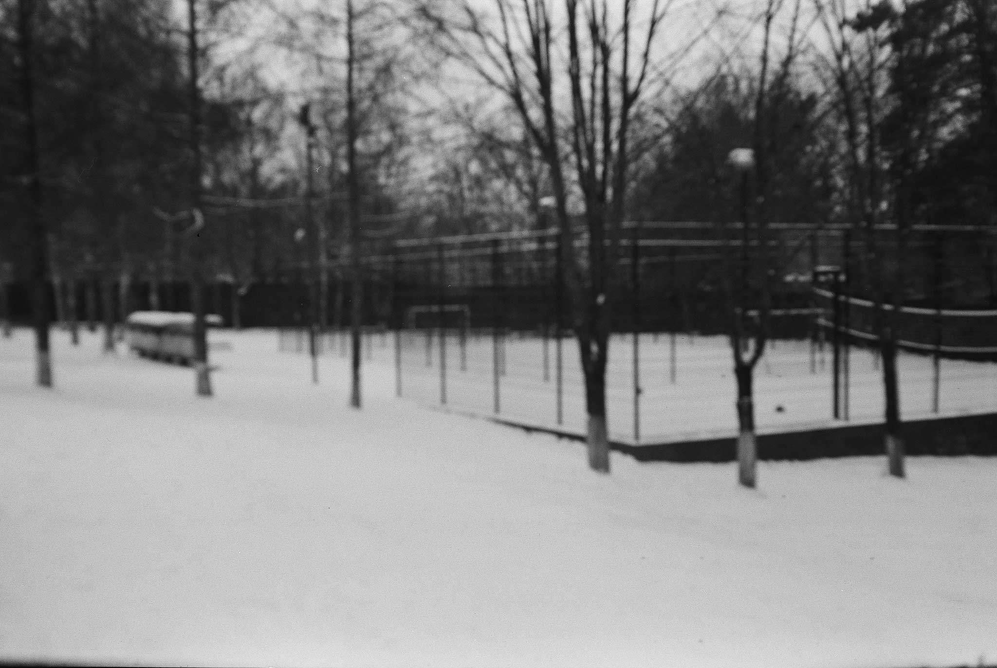

First roll on with this camera, all pics are out of focus.

In one of the pics, I was focusing at 1.7 meters and this was the result.
At this one it was infinity and this is what happened.

In the picture that you focused at 1.7 m, the main subject is off, but the background subjects seem to be quite in focus. It looks like your collimation is not correct, but the lens may be in good condition.
If you focus at 1.7 m but actually you get focus at longer distances, then you need to move your lens closer to the film. One possibility is that you got the wrong thread entry in reassembly. These lens often have several thread entries, and you have to pick the correct one.

In your picture, when you focussed at 1.7 m lens scale, the focus zone seems to be about the position of the guy in the background on the right side, I'd say about 7 to 10 m. The travel distance of the lens between those two scale marks is approximately the distance that you need to move the lens out from the film plane.

The good thing from your picture is that the lens behavior seems quite normal and that the focus zone is sharp enough, even at the side of the picture. It does not look like a reversed element. Just need to adjust film-to-lens distance so that scale distances and focus are in agreement, and then adjust RF for infinite.
