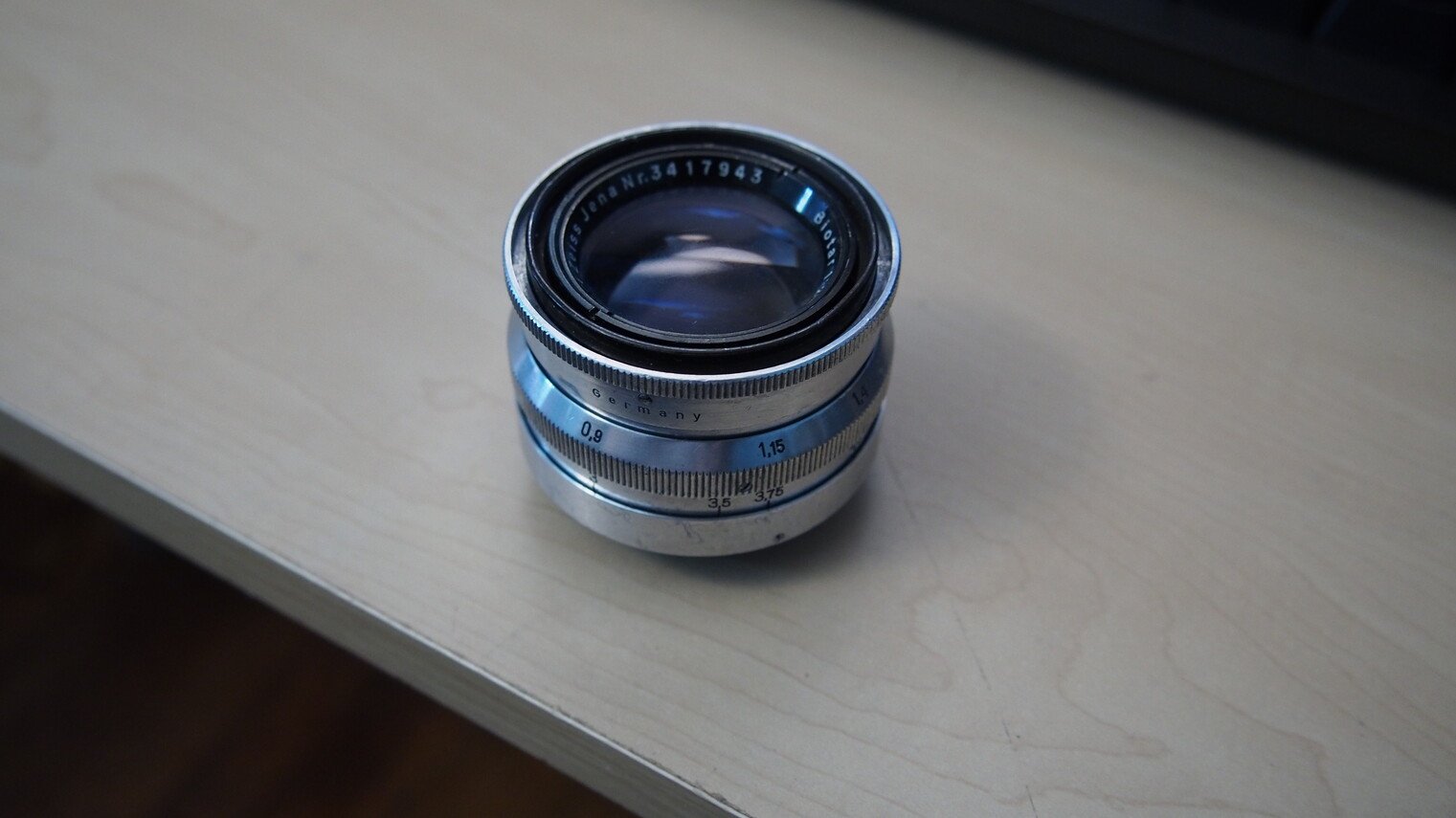

I don't know if this is the first model, but I think that it was. It's the small version of the Carl Zeiss Jena f/2.0 58mm Biotar, and it has no aperture pin. Like a rangefinder lens, when you rotate the aperture ring, the blades close.

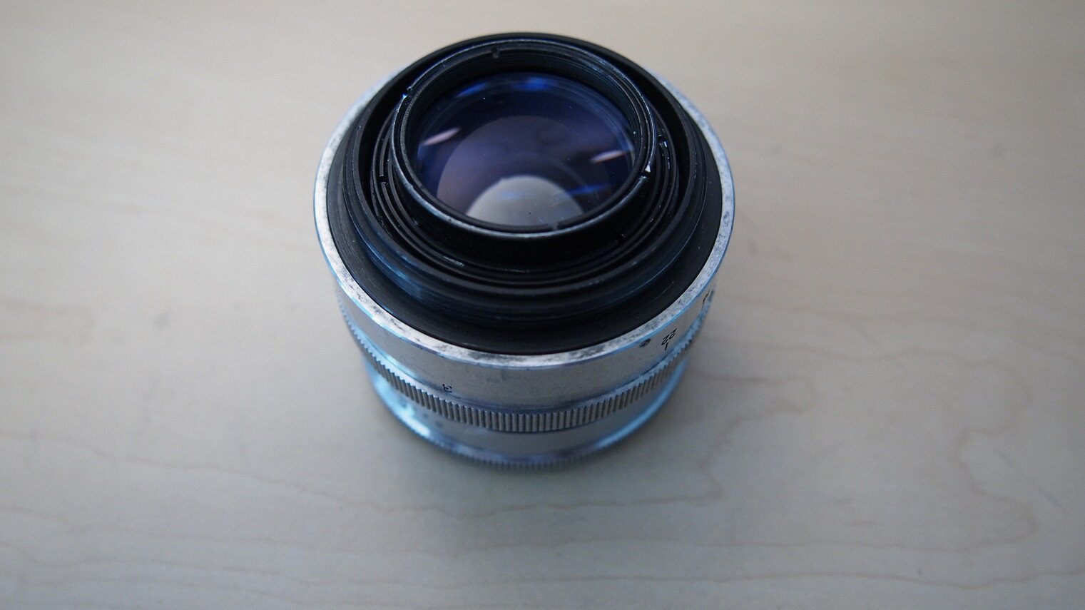

This is another camera thing that I've owned for well over a decade. It took me about two hours to disassemble, clean relubricate, reassemble and recollimate. Like many of the East German lens, the barrel and outer components are made from a light alloy, which is prone to scratching, staining and pitting, and no amount of Flitz will fix that. The photos above show it after I cleaned the lens.
Before I cleaned the lens, I could barely turn both the aperture and focusing rings. Both rotate smoothly now. There are no "click stops" for the aperture, which took quite a while for German camera makers to add.
For size comparison, here it is next to a 50mm AI Nikkor.
