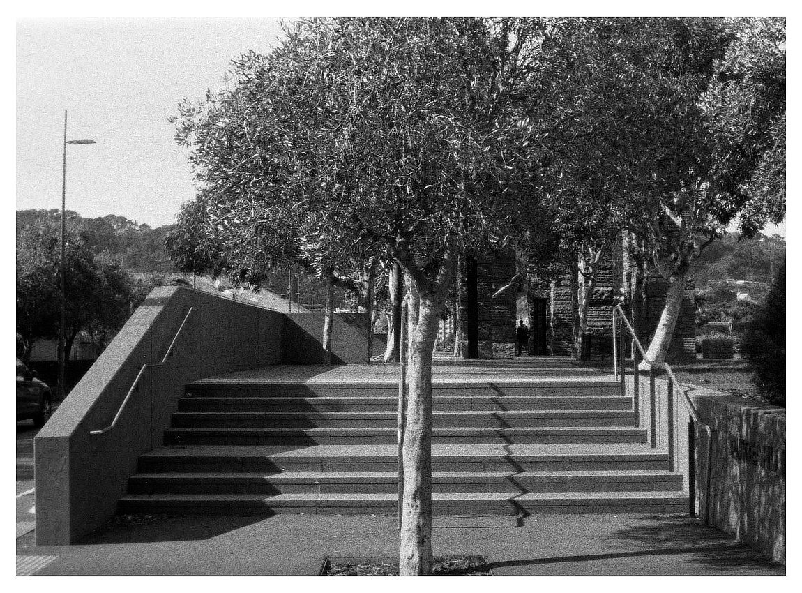

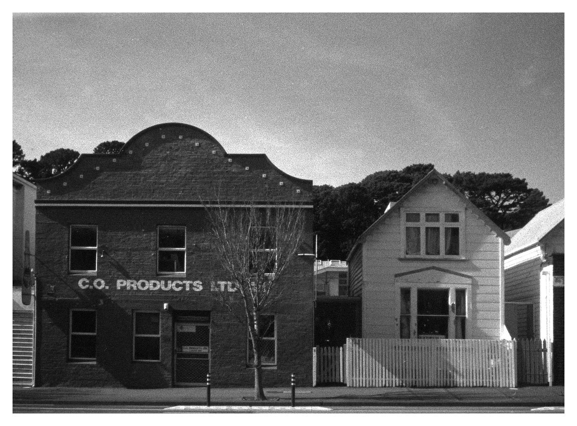

After some time and effort trying and testing I've finally gotten a roll of scratch free negatives from my Minox III.
I had some cartridges 3D printed which unfortunately were not 100% light proof, so I spray painted them inside and out with two coats of matt black and lined the inside (sides only) with some thin felt paper. I extended this a little to cover the film slit, forming a light trap. This solved some of the scratching problem.
I then turned my attention to the film gate on the camera itself. Some very careful cleaning at the leading and trailing edge, with some very careful use of extremely fine sandpaper (sounds horrible, but it's 4000 grit) and now I have a roll of scratch free negatives. Yay!
I've slit some Fomapan 100 film while getting to the bottom of the scratching, not wanting to potentially waste money on what would be finer grained but more expensive film. In fact, I went to buy some Delta 100 this weekend only to find Ilford is pushing through some 30% plus price rises. Ouch!! Anyway, the results from the Fomapan 100 in PC-TEA 1+50 weren't too bad, though I might try developing the next roll in 510-Pyro. Development is in a Jobo 1520 tank with a 3D printed reel. Scanned with the Panasonic G9 in hi-res (low) mode with the 45mm PanaLeica macro lens + tubes, using a cardboard inlay in a 35mm Kaiser fototeknik film holder and Kaiser backlight.
Overall I'm quite pleased with this test roll. I've got a couple more strips of Fomapan 100 slit which I will shoot first to confirm the scratching is gone for good, then I might try some RPX25 or Retro 80S. I've also modified the cardboard inlay / mask to reduce the film frame opening to cut down on some extraneous light which should give better quality scans too.
Itsy bitsy teeny tiny little negatives

I originally bought it as a "shelf queen", rather more of a curiosity than something I was going to use. It came with the meter, chain and cases for both the camera and meter. But curiosity got the better of me, and having previously used a Minox EC, I thought why not give it a go.
Being an older III, it advances the film each time you open and close the camera, regardless whether you fire the shutter or not. Fortunately the meter viewfinder has the same field of view, so you can "test frame" a subject without wasting a film frame. It's a nice thing to use, feeling very well engineered. The viewfinder is pretty good, especially compared to some of its 35mm and even 120 folder of a similar or slightly older vintage. It's parallax corrected too. I find it pretty easy to frame horizontally, with clear frame-lines, so easier to get straight horizons - important when you have so little negative to work with. Verticals are a little trickier as it's all to easy to have a finger encroaching into the frame.
The last two pictures are of the building previously used by our local spooks. Appropriate subject to use of a Minox on I think!
