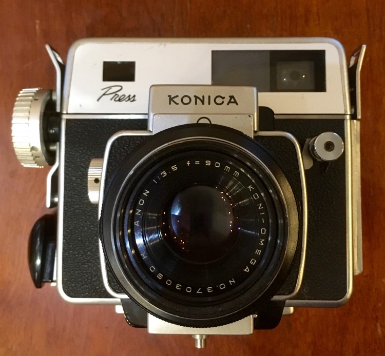

In my search of a 6x7 camera I had the chance to have one of these in my hands and I bought it at first sight, it's massive and super cool!!

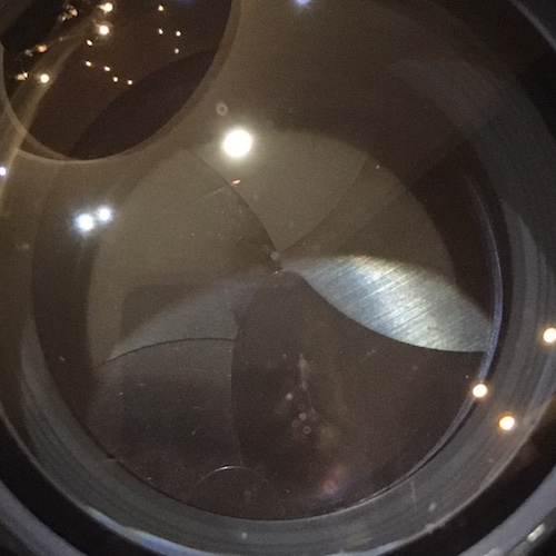

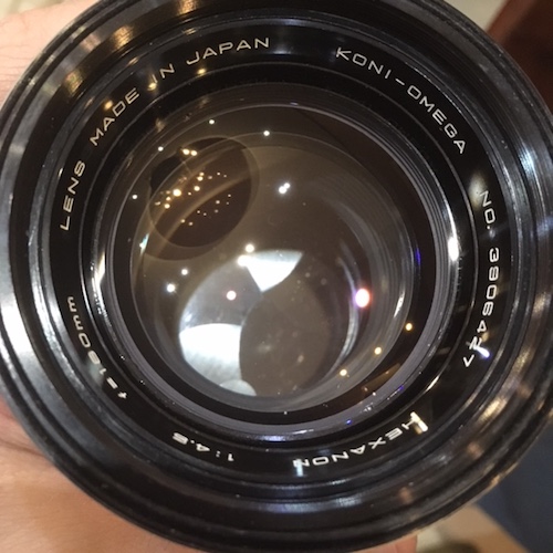

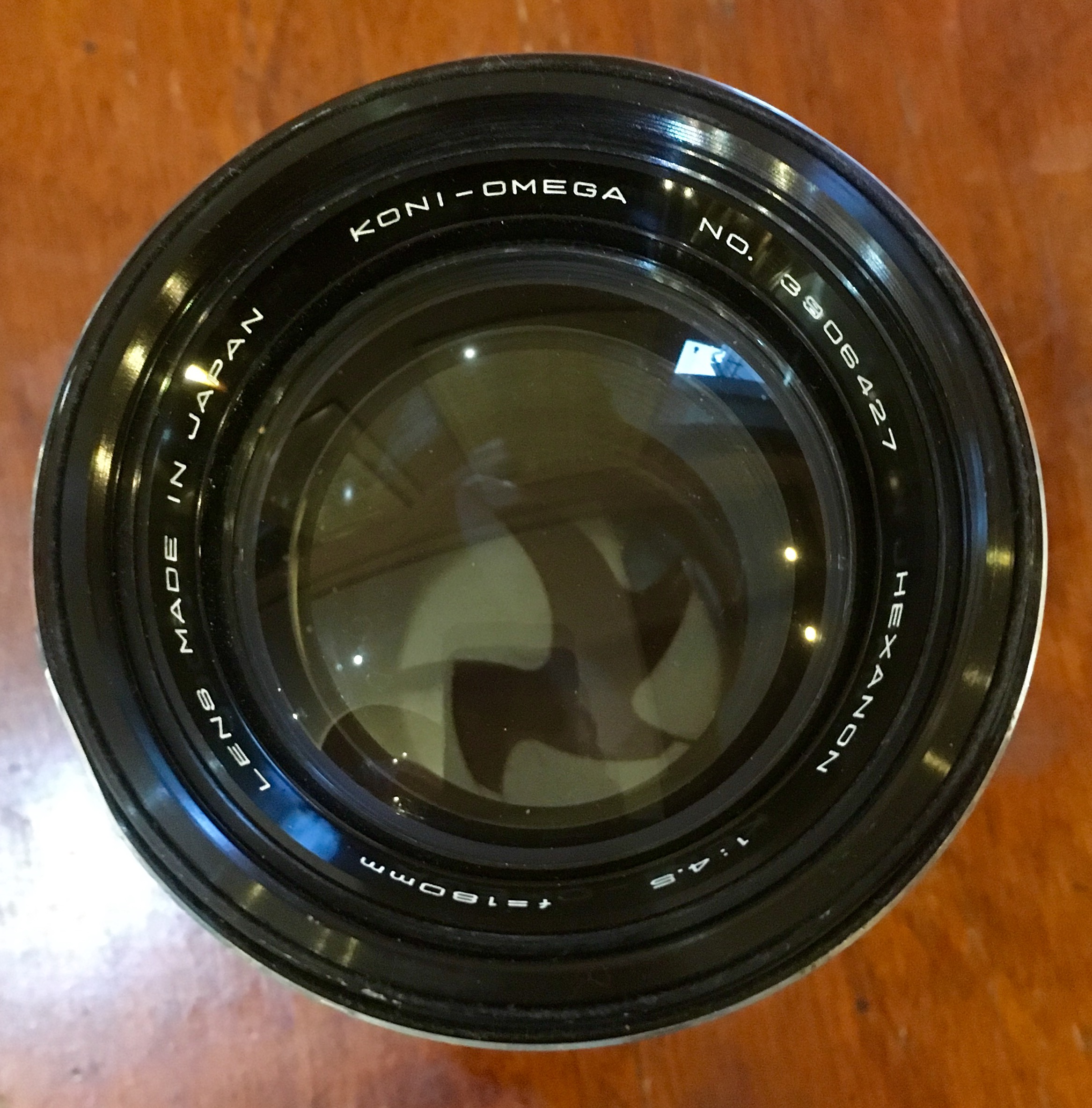

It came with the 180mm tele, sadly cleaning it it felt to the floor (credits to my left elbow) and the shutter blades went out of place... I have the service manual and I have written it down in my to-do-list.
I took the test roll today and Im waiting the results (done with the 90mm). I think nothing outstanding will come out but it was to check speeds, rangefinder, parallax, etc...

Its the equivalent to the Koni-Omega Rapid but was sold in the Japanese market.
No left handle but I saw one from Mamiya/Bronica that I plan to convert somehow.
Btw, I thought this camera was going to be a Japanese camera but reading its story it seems it's not, after checking the inner chamber and how its done its pure American, it reminds me a lot to the Medalist about how its done and the easiness to understand its construction, opposite as Voigtlander :lol: My second American and I like it too, I need a third guys, which MF is in your list/self worthy to have? :)

I'm on it already, I got stuck due lack of instruments for big lenses, I will pay a visit to my colleague here...

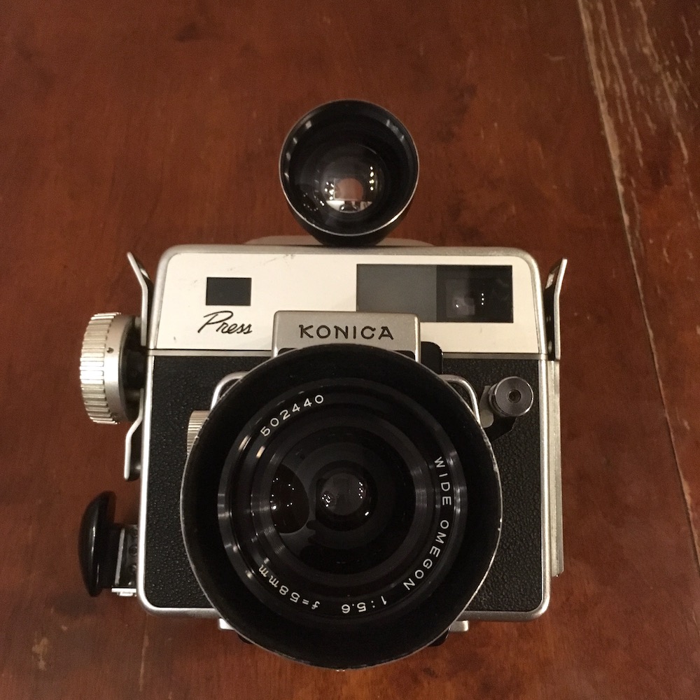

A new addition to the collection.
Speeds are great, only 500 is a bit shifted (350 actually) the rest of them near to be nailed +-10%
Lens is great.
Only the viewfinder is a bit dim but pretty usable, I will open and clean it.
Now the 180mm has to be repaired and the only left is the 135mm which I have never seen any yet :)
Camera is loaded already :D

Good news, I fixed the 180mm, lenses with leaf shutters are 90% from behind and I found they way in...
Tomorrow I will finish mounting it and I will post some fixit notes.
