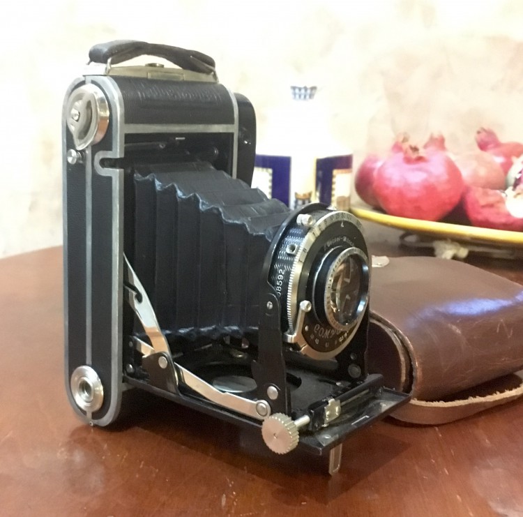

Here is Clarovid II, this example was made in 1935, Trinar-Anastigmar 3.9 105mm.
Only a couple of micro holes on the bellows due age, I will check overtime I put a roll on it. Rangefinder ok, shutter correct, lens as well, only mini-cleaning scratches.

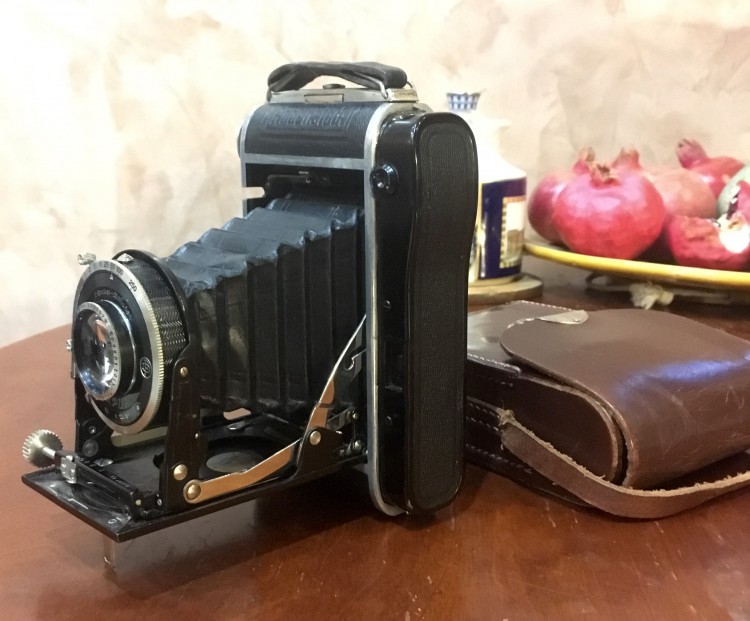

And here its the camera.

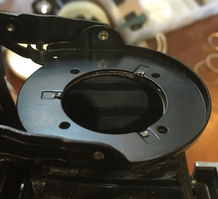

This camera holds the film flat but not absolutely flat as the Inos II does, there is an small gap(0.24mm) at the back than you can push, happening on the right side precisely.
Bigger issues are found here.
First this three bellows holders are some 0.xx mm above the shutter plate, left is 0.25mm and two other about 0.09mm.
Second, the shutter plate doesn't stay parallel to the film, I measured the three next to bellows holders points to the film plane (with film loaded) and there is a difference about 0.40mm (left side higher) so I added two quarter shims to te right side and I put the shutter back.
All these things could be the reason of the problem, my Inos II had the same issue and I solved this way.
Tomorrow I will adjust the rangefinder to be sure that goes equivalent and I will do another test roll shooting twice (one pressing the back door) the same subjects.
If I see the problem persist I might remove the bellows holders to have a more accurate measurement to the film plane. Im this case the bellows will be holded by the shutter retaining ring.

There are a lot of factors to consider when trying to get a folding camera film plane aligned with the lens. Sometimes more than one issue crops up, or fixing one introduces another. You just have to keep chasing them until it all comes together. Possibly you could grind down the tabs, then paint them black again.
Re: Rodenstock Clarovid II
Grinding the tabs is better than cut them, one needs to be repositioned coz its doing an small arc (left one).

So I did it, the tabs were reduced to the shutter plate and I added shims as I thought they were necessary, here are three photos.
I dont say anything, please compare with the others and let me know (I can't be objective now)
Waiting comments...
Thanks!!
Looks good corner-to-corner, Alex. Plus exposures, and compositions.
