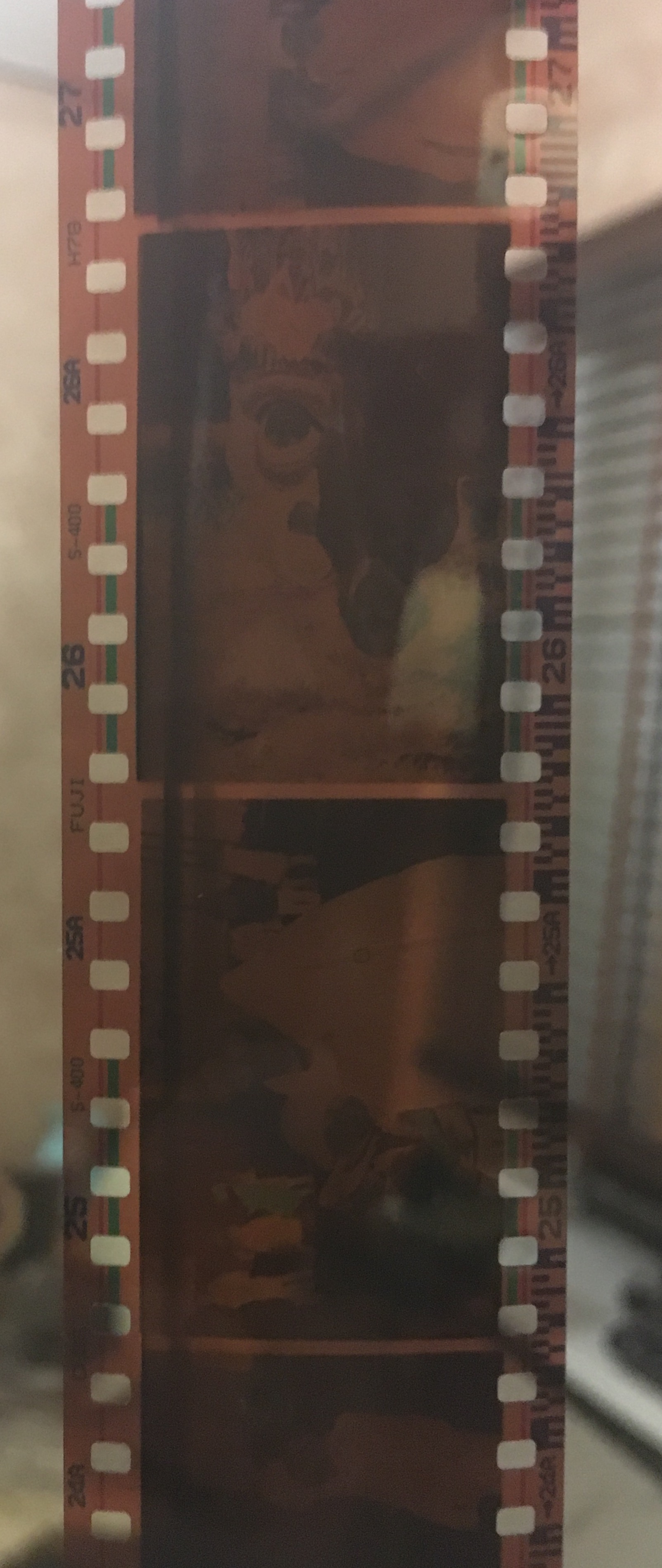

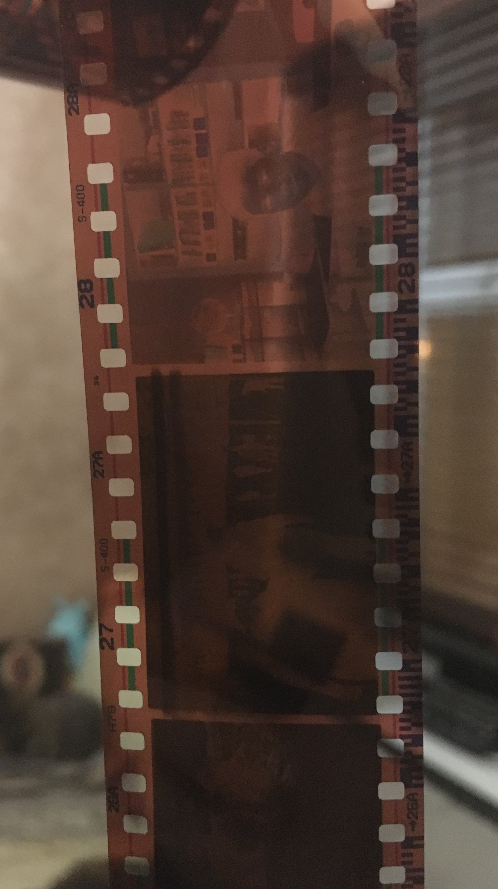

Sometimes it the line ends a bit further the frames, sometimes it crosses from frame to frame or they join together from both frames.
Here example:
As well you can see how abruptly end when the next photo is inside.
