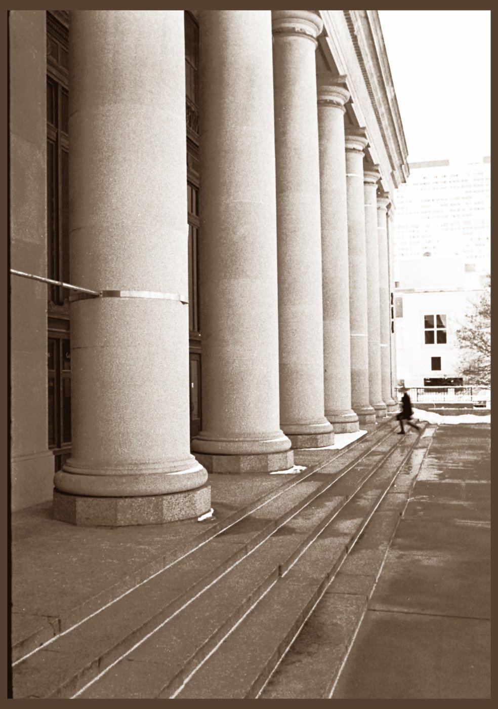

Are filters for black and white film used much any more? Working on some old negatives I came across a few frames from about 15 years ago that were taken on an Olympus Pen W; the old note said that a G filter was used. I had (and probably still have) a pretty complete set of filters of the drop-in style of Kodak Series 5; they work nicely on the smaller diameter lenses of HF cameras. I like the effects of the old filters and am sorry that I didn't use them more than I did. Here and there I've seen "click on" modifications that do something like filters, but they seem to affect the whole image more than glass filters did. Anyway, here's the example mentioned above: Union Depot in St. Paul, Olympus Pen W with 100 speed film developed in D-76 1:1 and scanned at home, sepia toned.

Nice photo.
Yes, I have yellow filters for some cameras, thee must useful, series V and series VI plus 32mm slip-on.
I use them normally when shooting anything but portraits.

G filter, do you mean green or the orange?
Re: Filters for B&W?
It was an orange filter that I used. The other two that I used quite a few times were green and yellow. The only ones I used for color film adapted slide film to lighting other than what it was manufactured for-- e.g. tungsten or daylight.
