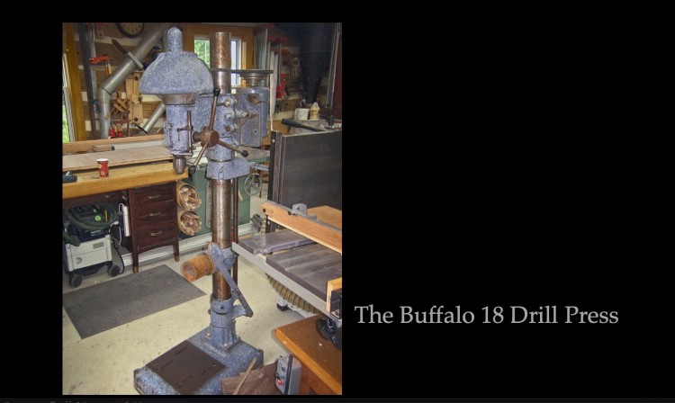

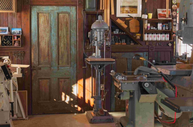

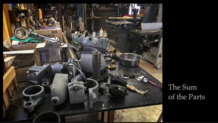

This is a little off topic but here’s some pictures from my latest project, rebuilding a 600 pound, 60 year old drill press. It’s a beauty. One of the nicest drill presses ever made with a rising head and table, and a foot feed that controls the quill for hands free drilling. If you look closely you will see a Time-O-Lite darkroom foot switch sitting on the base of the drill press. This foot switch turns the drill press on and off giving me hands free start and stop. The drill press is a 3 phase machine so I use a variable frequency drive (VFD) to create 3 phase power from my shops single phase source. The VFD is controlled with milliamps of current allowing me to chose any on off switch for the drill press regardless of the machines motor current. It means I can add super cool steampunk like electric controls to all my old machines.
Before
Before
During
During
After
After
