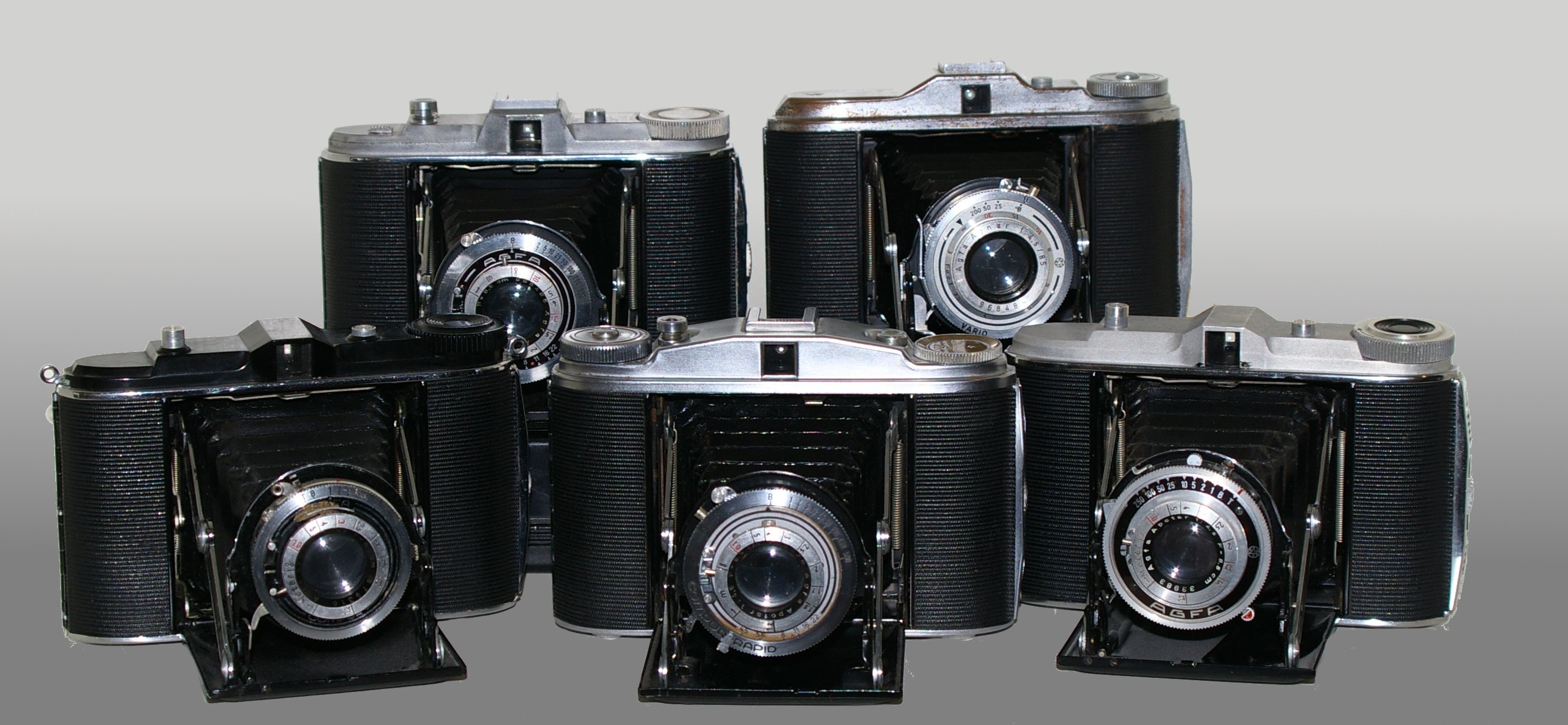

Alright, after PBBlaster magic I have 5 Isolettes!
3 are in good shape and 2 have pinhole bellows
Will keep applying liquid tape and see where we go
Family portrait to come later
I was surprised to see that AGNAR and APOTAR lenses were almost identical, I always thought they weren't
Re: Fixing Agfa bellows
And here are my 5 Isolettes
Front: Jsolette 6/6x4 - Isolette II - Jsolette
Back: Jsolette* - Speedex*
The two in the back need bellows repair/replacement
I'm also tempted to polish the speedex to brass since the chrome is pitted all over.
Polish, and cover with some spar varnish to keep it shining... any other way?
