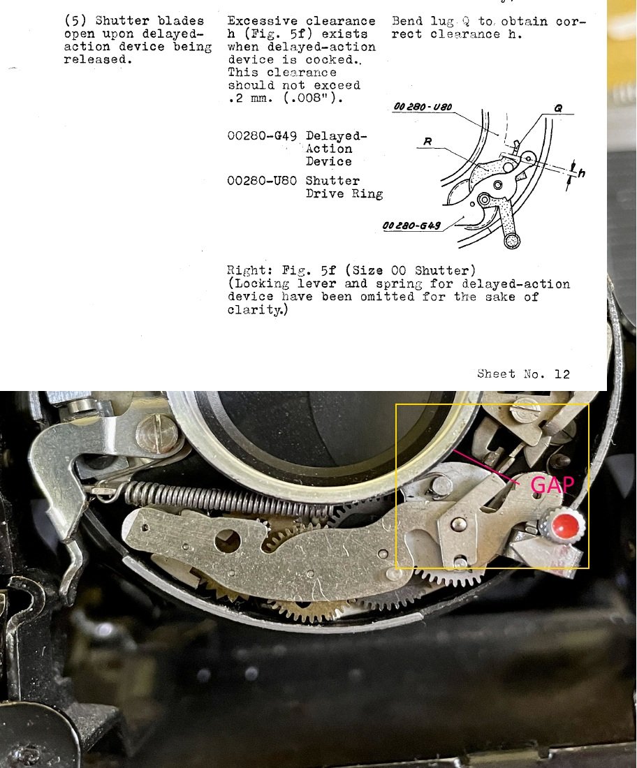

I think one of the hooks either for the delayed action of the shutter is bent. T he gap between the end of the cocking lever and the pin on the main cam should be <=0.2mm. (page 12 of the repair manual)
SOmething like this
SOmething like this
