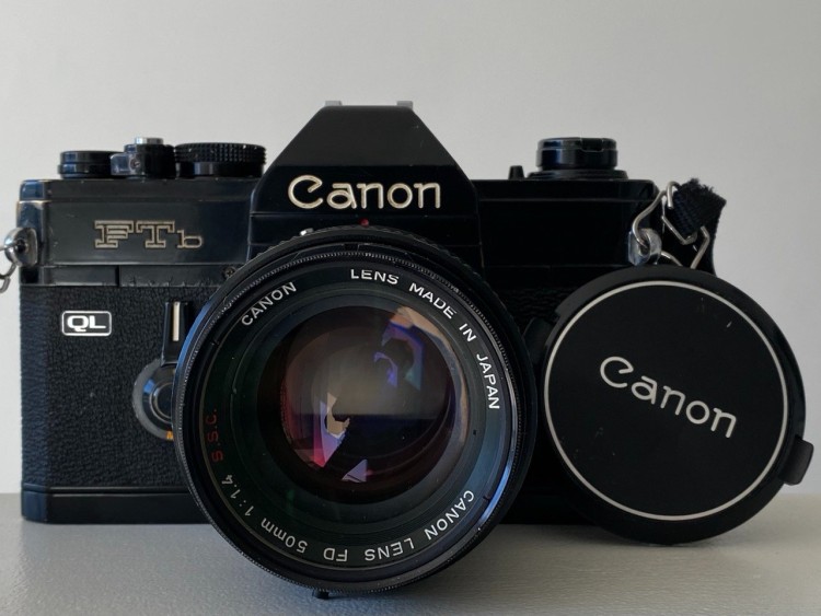

It's funny, you read about a camera model, then you start seeing them "everywhere". Probably because you're looking for it! Anyway, there were several of the older, less popular Canon SLRs being offered up on our local auction site (TradeMe). I watched a few to get a feel for the local prices, and spotted a black FTb QL with a 50mm f1.4 lens. Offered what a few others had recently gone for (with the standard f1.8 lens) and the transaction completed. A few days later the black Canon FTb turns up.

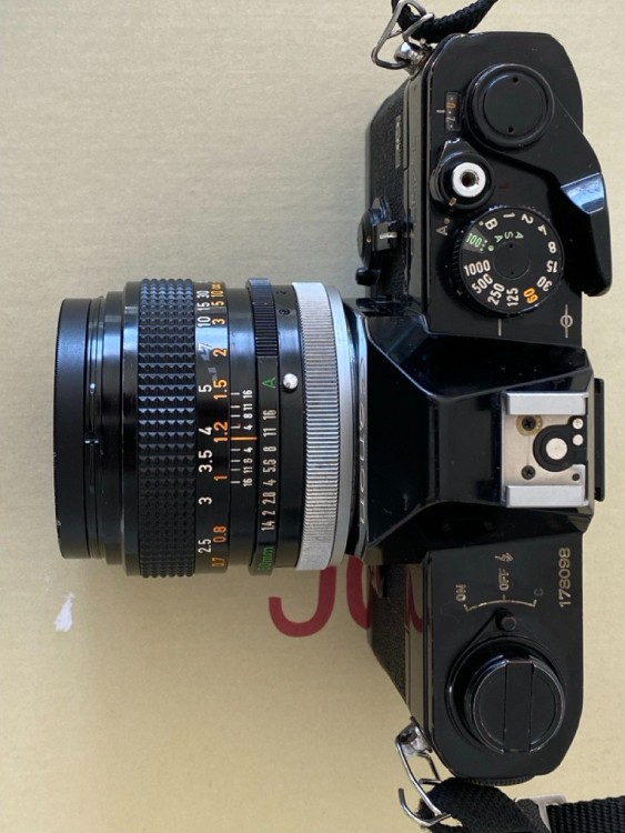

It's not been used for a while, so needed a bit of cosmetic cleaning to the outer body, plus some stick grease leaned from the mechanism under the bottom plate. The lens is nice and clean with smooth focus. The viewfinder has a couple of spots in which I'll address later. Meter seems to work fine, as does the self timer and mirror lock up.

Well, it was sort of working just fine.PFMcFarland wrote: ↑Fri Mar 15, 2024 10:59 pm... Yours is working just fine, Paul, and the photos are lovely.
The shutter doesn't always full open, meaning a random chance of a random format picture - sometimes full frame, sometimes half frame, something no frame. It's a bit annoying, but given what I paid, I'm not too put out. The lens alone usually goes for more.

And what to do with the black body? I think I'll try and strip it down and service it. There are a few online videos showing a full tear down, it doesn't look too scary

Sounds like some of that goo leaking out from the bottom was lubricant. You're looking at cleaning out the gear mechanisms and re-lubing to get rid of that intermittent shutter hanging. I forgot to mention that what you have is an FTbn as it has the newer self-timer lever. It's a great camera for a three-lens kit (wide-normal-portrait) to carry around, especially since Canon made such good glass for them. The abstracts look great.
