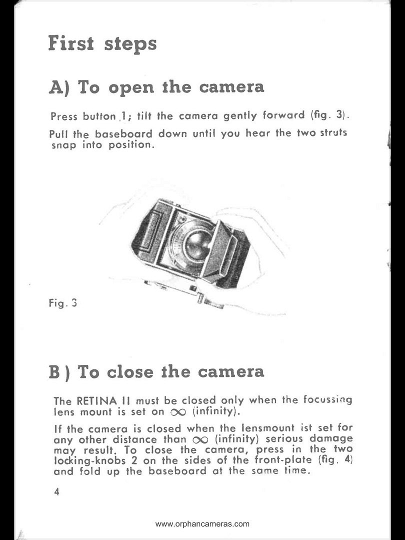

My two Retina II’s have never snapped out, either the first one that I used as a boy, or the one I have now. They just open a bit when the bottom button is pressed. I found no spring linked to any part of the bellows or the folding mechanism. On the other hand, every 6x6 folder that I can remember has snapped open, as Scott mentioned.
Maybe the Retina II was not designed to snap, just to release the front door for a careful amateur to open fully until the mechanism clicks. From the instructions in the manual It looks that is the case (thanks Butkus!!)

Well, hell - that seems pretty conclusive. Exactly how mine works. I feel better - thank you for posting this!
