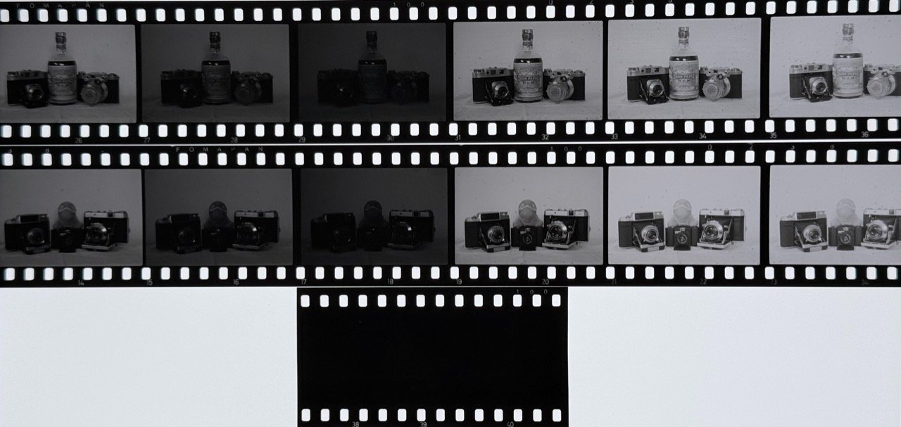

I shot two similar scenes. I metered using the camera's in-built meter and compared that with my phone light meter app, and they both agreed. I shot the scene at 0, -1, -2, +1, +2 and +3.
Here's the slides on the light box, shot with the iPhone:
Slides on light box
Slides on light box

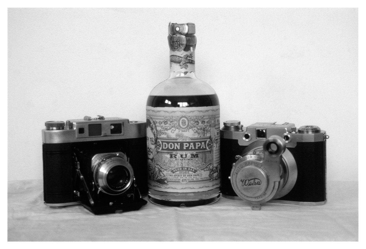

Frames shot at 0, +1 and +2 all looked usable, 0 and +1 looking like they'd project well, +1 and +2 scanned quite easily. Ignore the background lines on this first set, that's down to me being a bit clumsy...
metered (0)
metered (0)
+1
+1
+2
+2

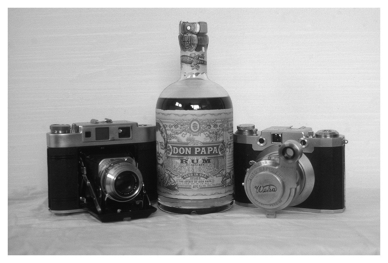

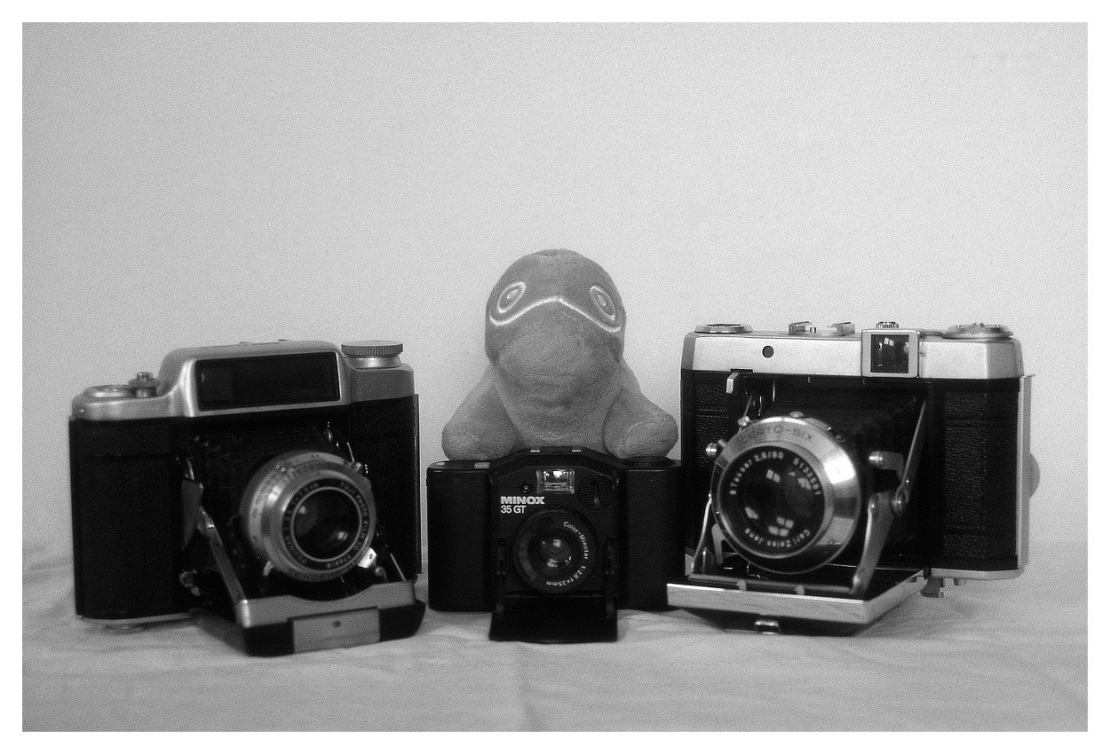

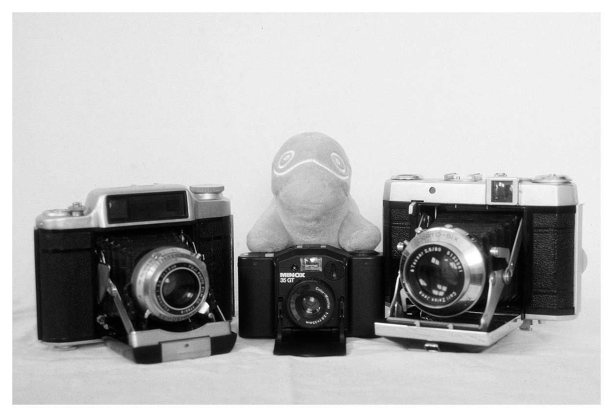

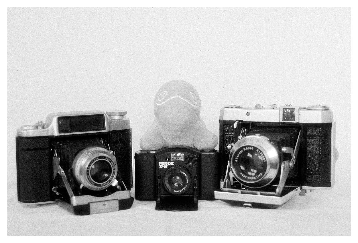

And the second scene, which I shot first:
metered (0)
metered (0)
+1
+1
+2
+2

Another fun experiment! Hard to be sure, given the paths these images have taken to my screen, but looks like an "ideal" exposure might be somewhere between +1 and +2? Depends on how you want to show them, of course.

+1 would be EI50, +2 would be EI25, etc. Given the rather extreme scenes - blacks and shiney chrome, I'd probably rate this at EI50 or EI64 for normal scenes. The stuffed toy is light green (SuSE Gecko). I was quite surprised at how well it held on to both shadow and highlight detail.
