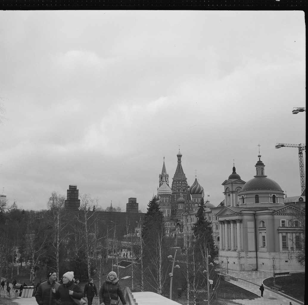

Well, I was lucky to get a Perkeo II is mostly perfect state (the minus is all speeds are the half in every setting), lens ok, bellows ok, etc...
These are the results of the first roll
What I liked:
The contrast, for a Moscow cloudy day results are promising.
Image definition, good enough for me.
Small, in a pocket you have a 6x6 camera.
What I did not like:
Not a camera for winter, can't be managed with gloves, so even at 0 degrees as It was you want to finish to put back the gloves :)
Need a rangefinder (its coming)
I lost the paper with the setting for each photo :( (how do you manage on this stuff?)
Slow handling, measure the light, composing, settings, coking and shooting, I think with practise will be quicker. (Winter is getting colder here)
Conclusion: Its a keeper!!
As usual comments and advices are very welcome :)

That is not bad at all! In my limited experience of Voigtlanders, they are very well made and handle like mechanical silk.
Does your Perkeo II have a Skopar lens or a triplet? (I'd bet on a Skopar after looking at your high resolution scans).

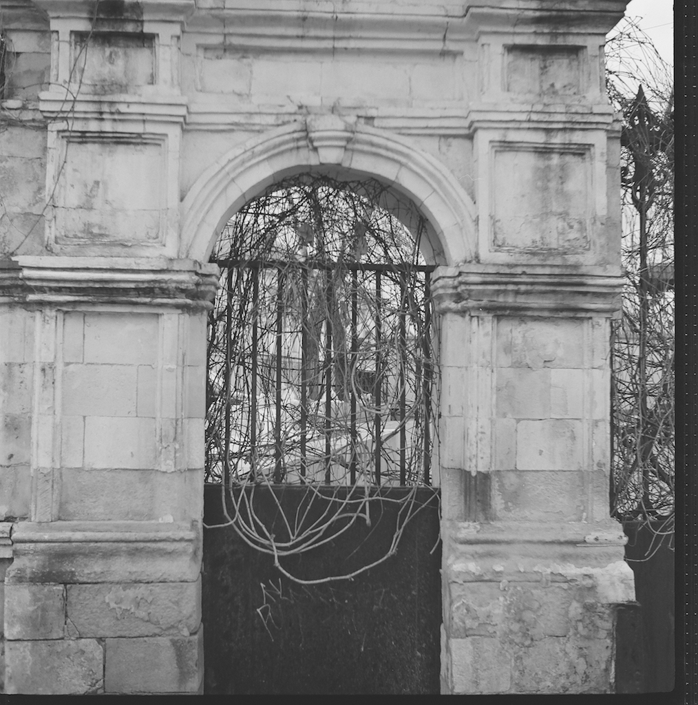

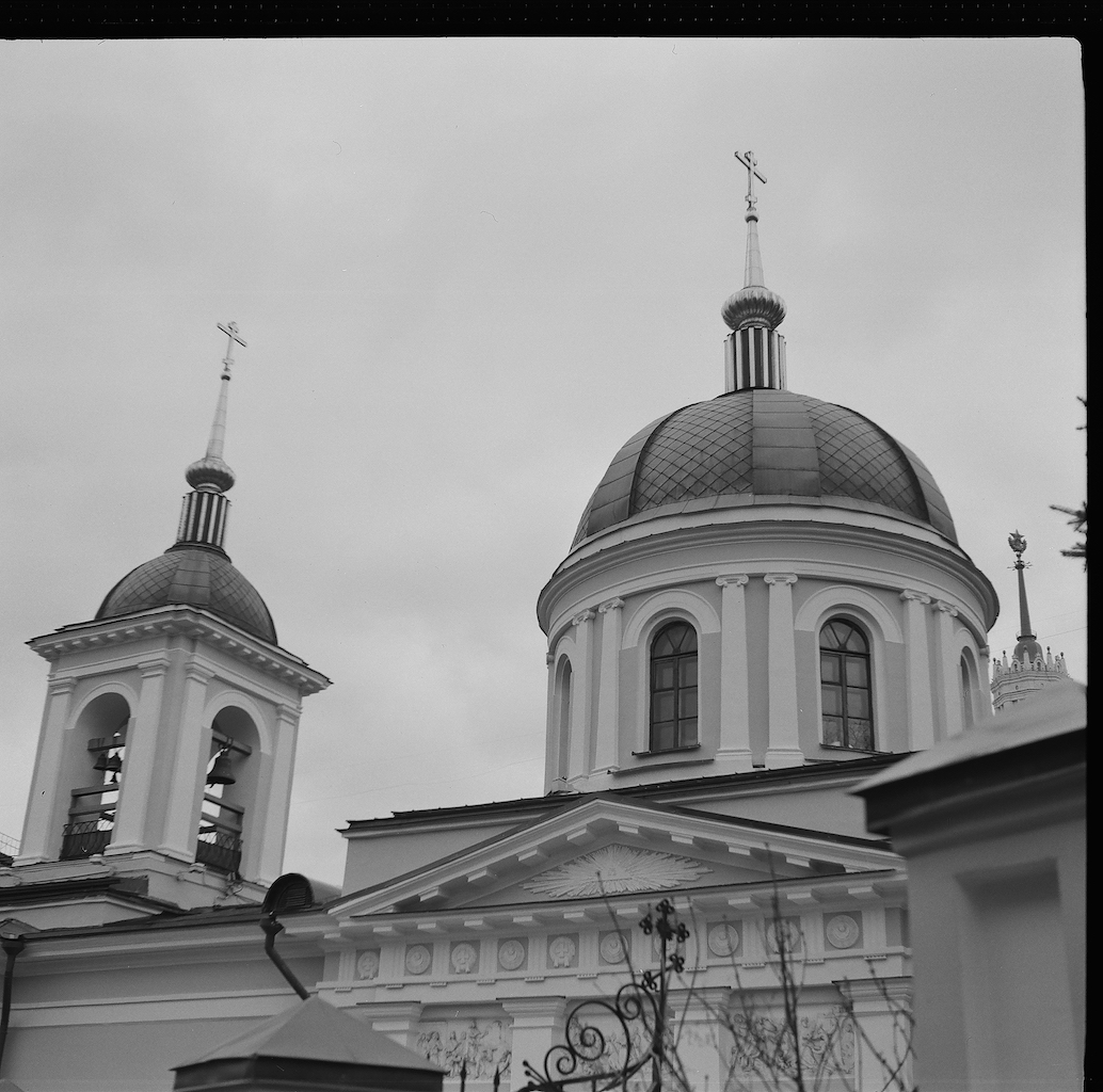

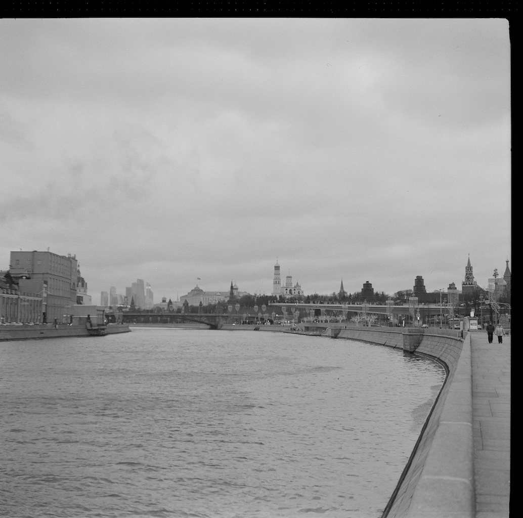

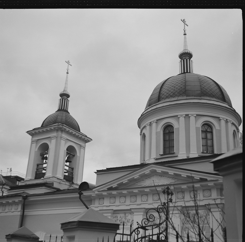

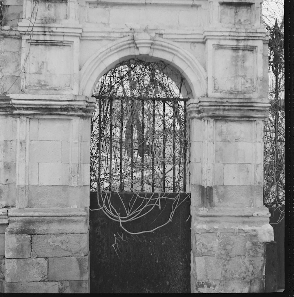

Maybe the left side of pictures in this roll is not as sharp as the right side. This may happen because of a slight misalignment of the folding structure which tilts the lens a bit, or it might be the pressure plate, or some other issue. In any case the camera is a keeper.
Probably you were shooting at 1/100 or 1/50, from the movement of walking people. Must be tough to handle the small controls in your winter weather; I feel cold just from looking at the pictures!
You estimated distance quite well; most people can be accurate enough from 2 m onwards if they practice, and it is faster than rangefinder operation (although not so nerdy).
My Perkeo I, with Vaskar triplet lens, is a favorite MF travel camera because of light weight and small size.

Alex, my Perkeo I does the same trick on different left and right sharpness,and that is why I went to look for it in your roll! If you find the cause I will be most interested.

As for the left/right sharpness thing, I believe I have your answer: Don't wind the film until you are ready to expose the frame. When you open and close the camera, which I suspect you were doing between exposure pairs, the air that rushes in when the bellows expand can draw the film away from the pressure plate. So what I do if I am going to close the camera is to only wind the frame halfway, so that 1) I don't double expose the frame, and for 2) it tensions the film across the pressure plate when I wind the rest of the frame after opening the camera. In other words, I set my sequence of action to where winding the film is not done until I am sure to be taking a photo at that time. Usually that means I will scout a scene until I settle on the framing I like, then wind, set aperture/shutter, focus, and shoot.
