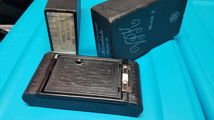

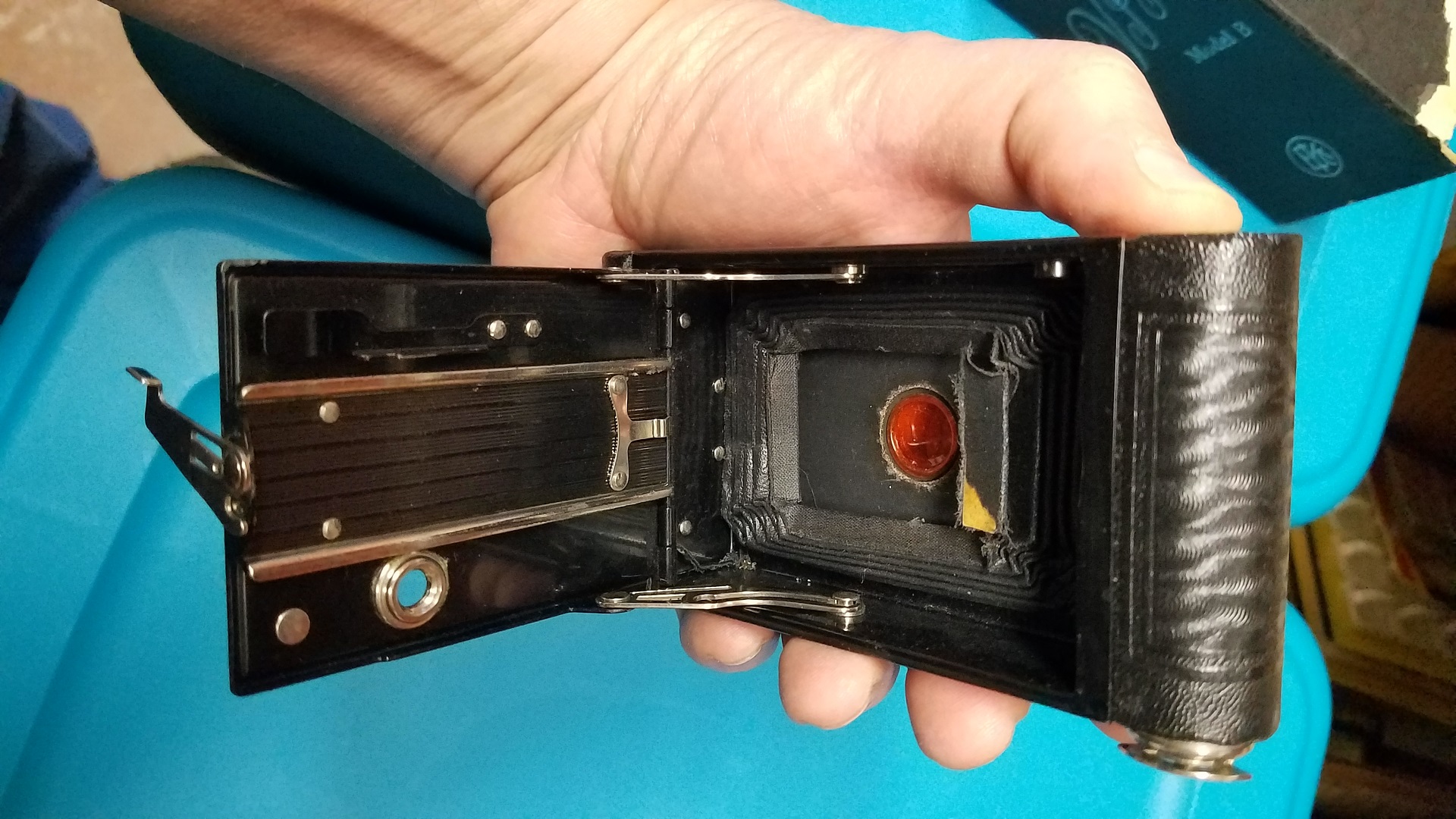

For my first camera restoration of 2018, I chose a Vest Pocket Kodak Model B that I found on eBay. The set included the near-mint camera, its manual, and a fairly complete original box. Although nearly new in most respects, the camera had a completely hardened bellows that had already separated from the front standard. This had to be rectified either to shoot with or ever sensibly display the camera.

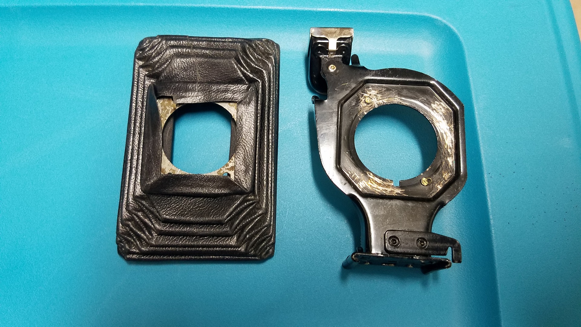

I found a similar new-old-stock bellows from another eBay seller. The front ring was different, so I pried off the front flaps of the NOS ring and glued in the original front ring. With my screwdriver-turned-tab-lifter tool, I replaced the crappy bellows with this modified as-new bellows.

As received. Nice on the outside.
Inside, the bellows was stiff and fragile.
Put the original front ring on a similar but not exact New Old Stock replacement bellows.

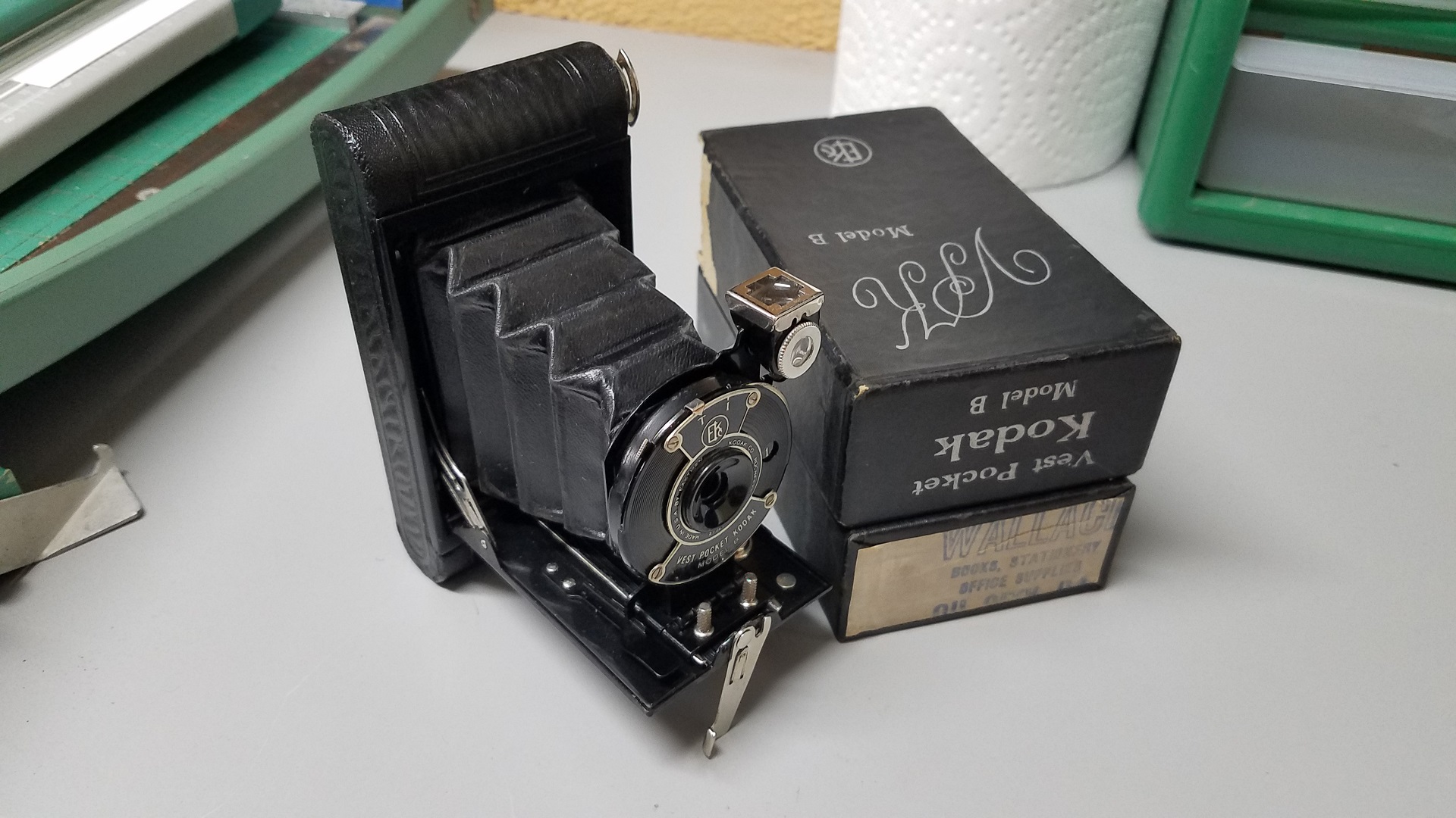

After replacement, nearly good as new.
