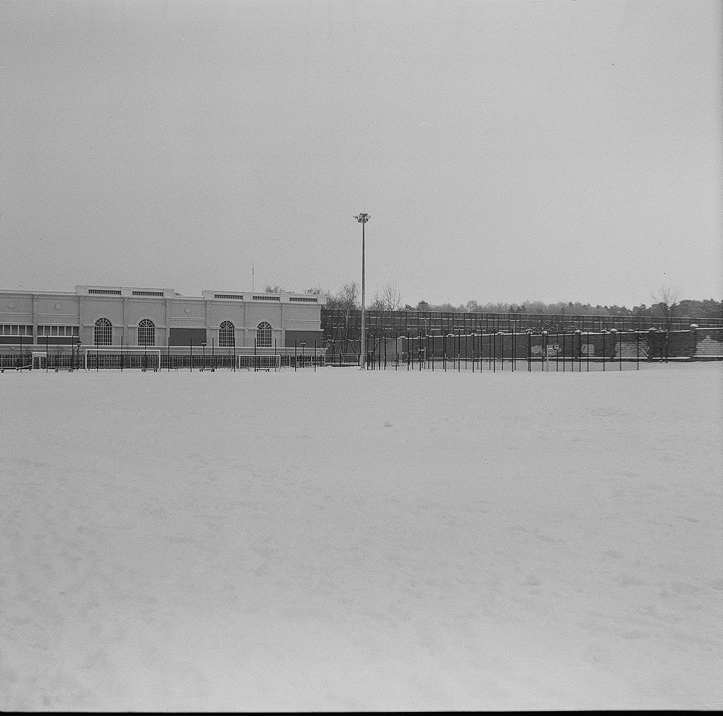

About the light, I have a goshen digisix and I never did pics on the snow, I measure ambient light and because the snow I read some stops could be done, to avoid this I also read that putting the hand or whatever bellow the light-meter would get the correct light. So I did it this way, I got good results as you can see in the first picture (200 at f8), I took two other more pics using lower speeds (100/f8 and 50/f8) and the pics are too washed (dunno if this expression is correct).
But anyway the snow is no white as it should.
As final conclusion is, yes this camera is a keeper, I like a lot how it went, it easy and straight forward, zone focus and shoot.
Ideas about a whiter snow are welcome :)

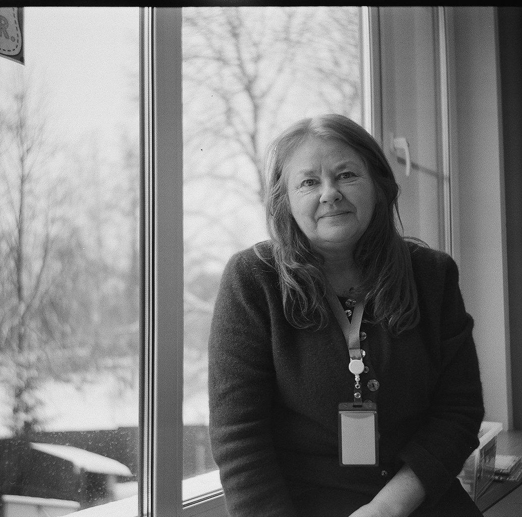

The last image is a superb portrait. Well done!

Excellent portraits there! The OOF areas of that lens are quite nice, and you nailed the focus very well!
As for whiter snow, I believe that you are measuring light correctly. If you want whiter snow, you could underexpose the meter indication by 1 stop or so; depending on your development you might get less detail in the snow.
But I believe that you could also correct levels in scanning, to get the results that you want. This is similar to what one used to do in enlarging, with exposure / development control on the print. The idea is to get white in the result what was white in the scene (or, better said, what one wants to be white).
I copied your first image to GIMP and got the following histogram in Colors / Levels. You have plenty of room to correct in the highlights, on the right side:
This is why your snow looks grey. If you correct levels to move your lighter highlights to the right end, you'll get whiter snow.

Thx all for the compliments about the portraits, its them, not me who do the job.

Alex, my previous post is in error. To get whiter snow you should overexpose (not underexpose) with respect to the meter lecture.
Re: Nettar on the snow
So if exponometer says 200 f8, I should go for 100 f8 or 200 f5.6 or ...
Posts: 1400
That is correct. Alex. You may try 1 or 2 stops overexposure, and determine what works best.
I still believe that you might need corrections in scanning for best results. This usually happens with sand or snow scenes. The auto-scanning gives sand / snow a light gray tone.
