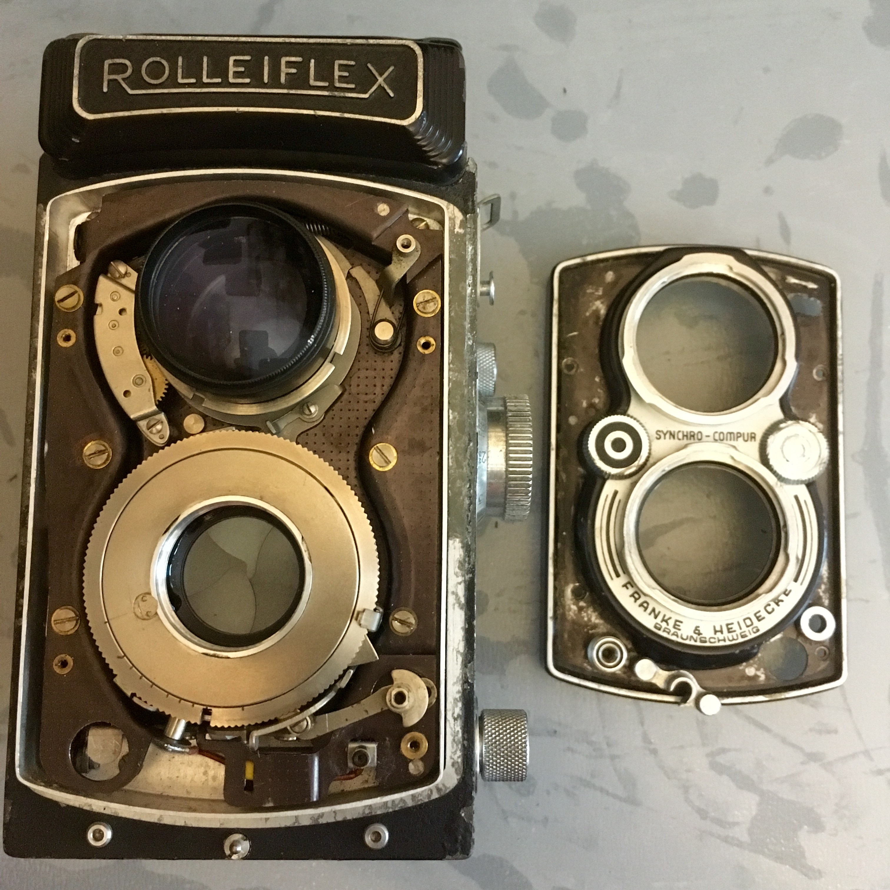

So even if I can't put it back to like the lens fits Ikoflex II (checked) and atm my Ikoflex is on stereoids with a coated Tessar

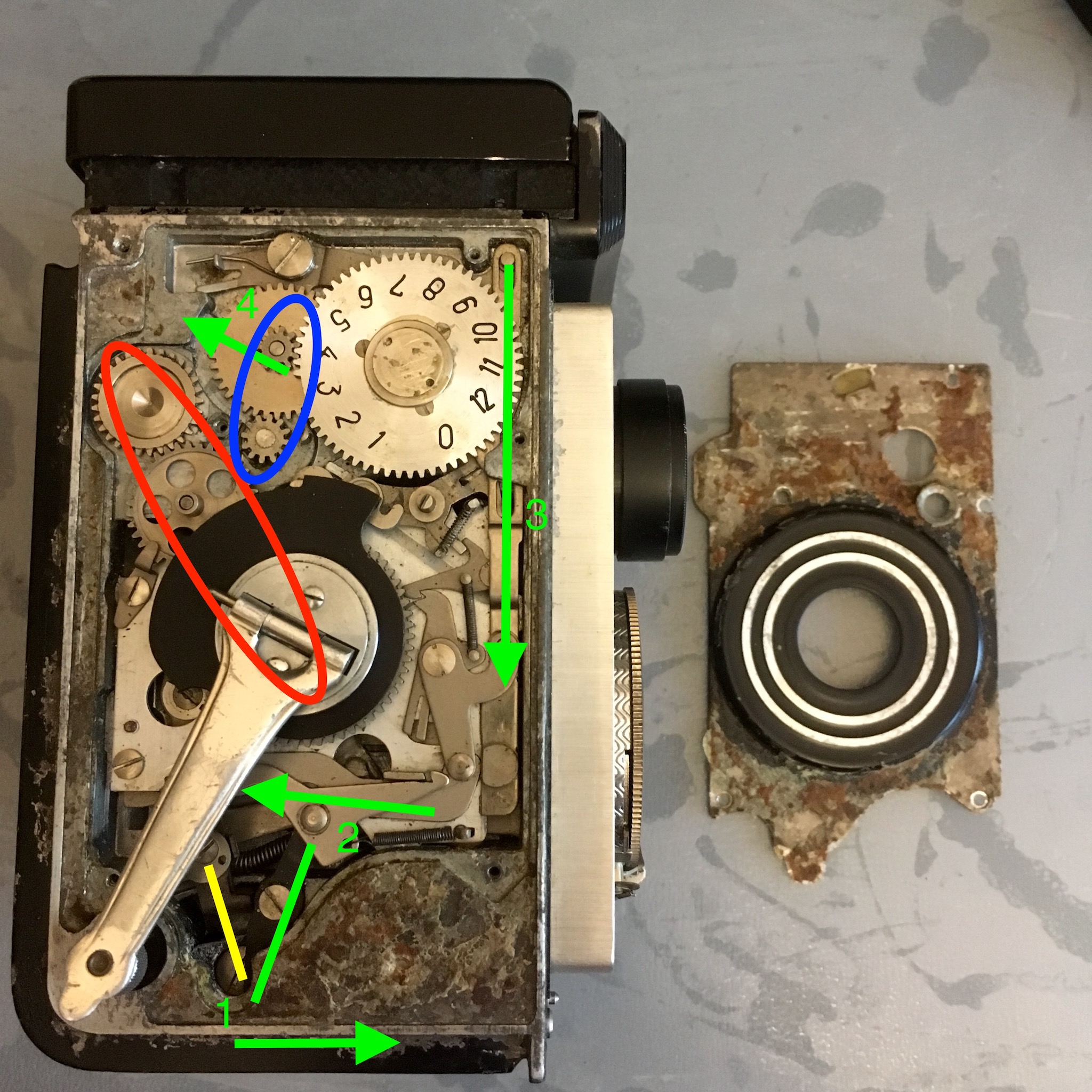

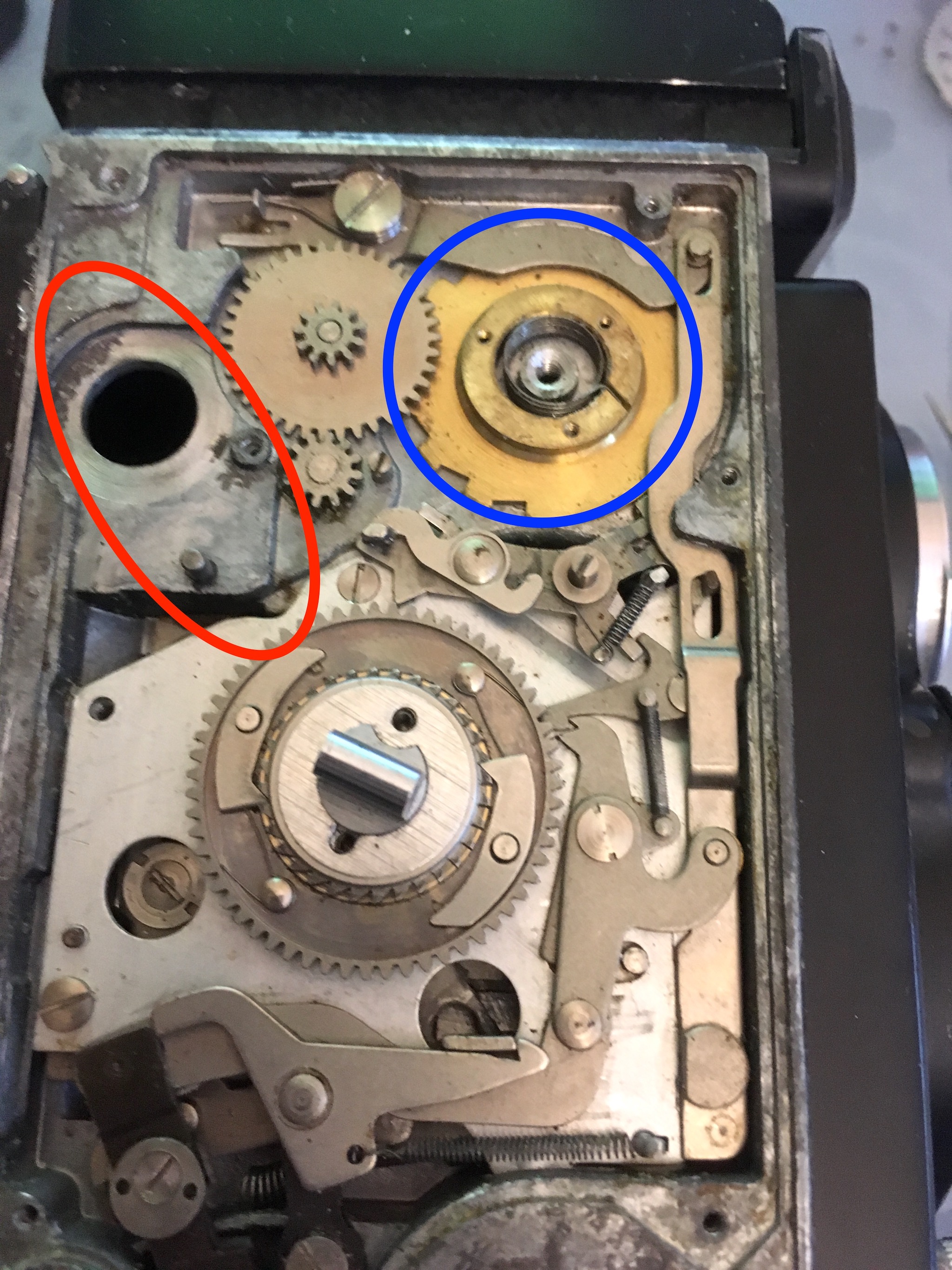

Green: What happens when the door is closed, the "tab" from the film chamber moves to the left and moves the counter wheel from the taking up spool mechanism (in blue) and reseting the counter to 0.
Red: Simple winding mechanism, it will be locked if new exposure is ready.
Yellow: Film detector, this is why Rolleiflexes are loaded this way, please RTM.
Blue: As long as you take up roll this works. 4 screws, remember their position. 4 screws, 4 washers. Film detector.
Now the door is closed but no film.
Counter is reset to 0 and the counter wheel is separated from the winding wheels which make the counter more to the next number.
In yellow is the film detector, as soon you wind the film, when the backpaper+film passes between the two rolls in the film chamber, this leveller will push right and it will free the tension placing back the counter wheel to the winding wheel, so the counter to 1 will begin from there, when 1 is achieved it will stop the winding mechanism, and you have to place the outside crack leveller in resting position.

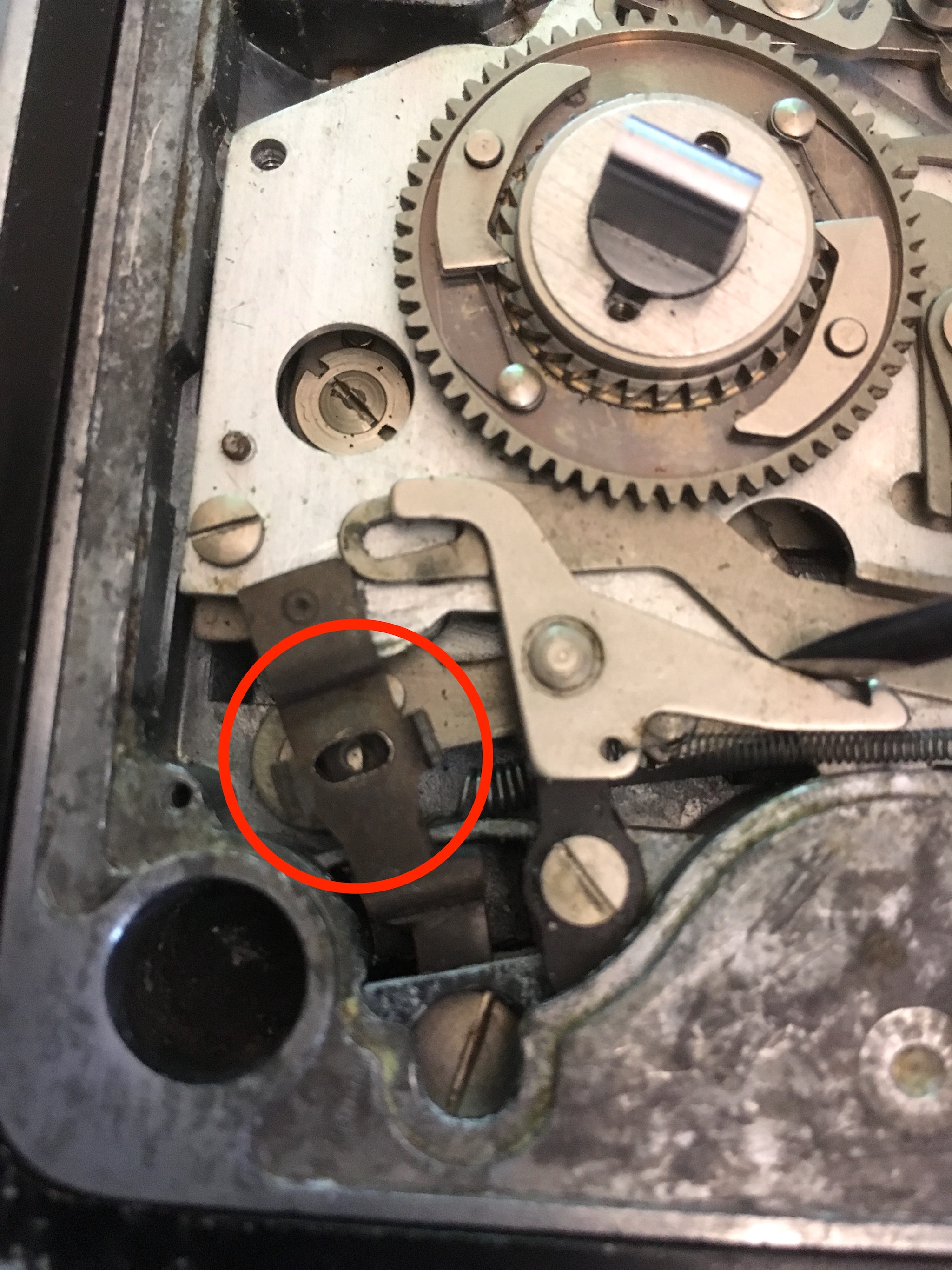

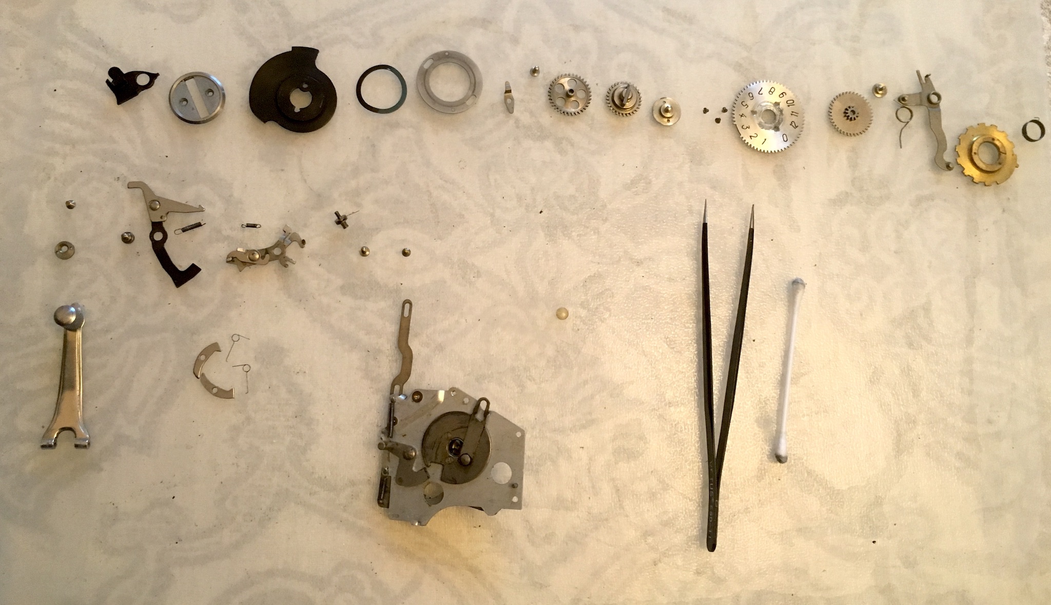

If your camera has problems detecting the film start, unscrew a bit this yellow screw and move with tweezers CW or CCW until works, as I read this is a common problem in these cameras and easy to fix. Winding and counter wheels off

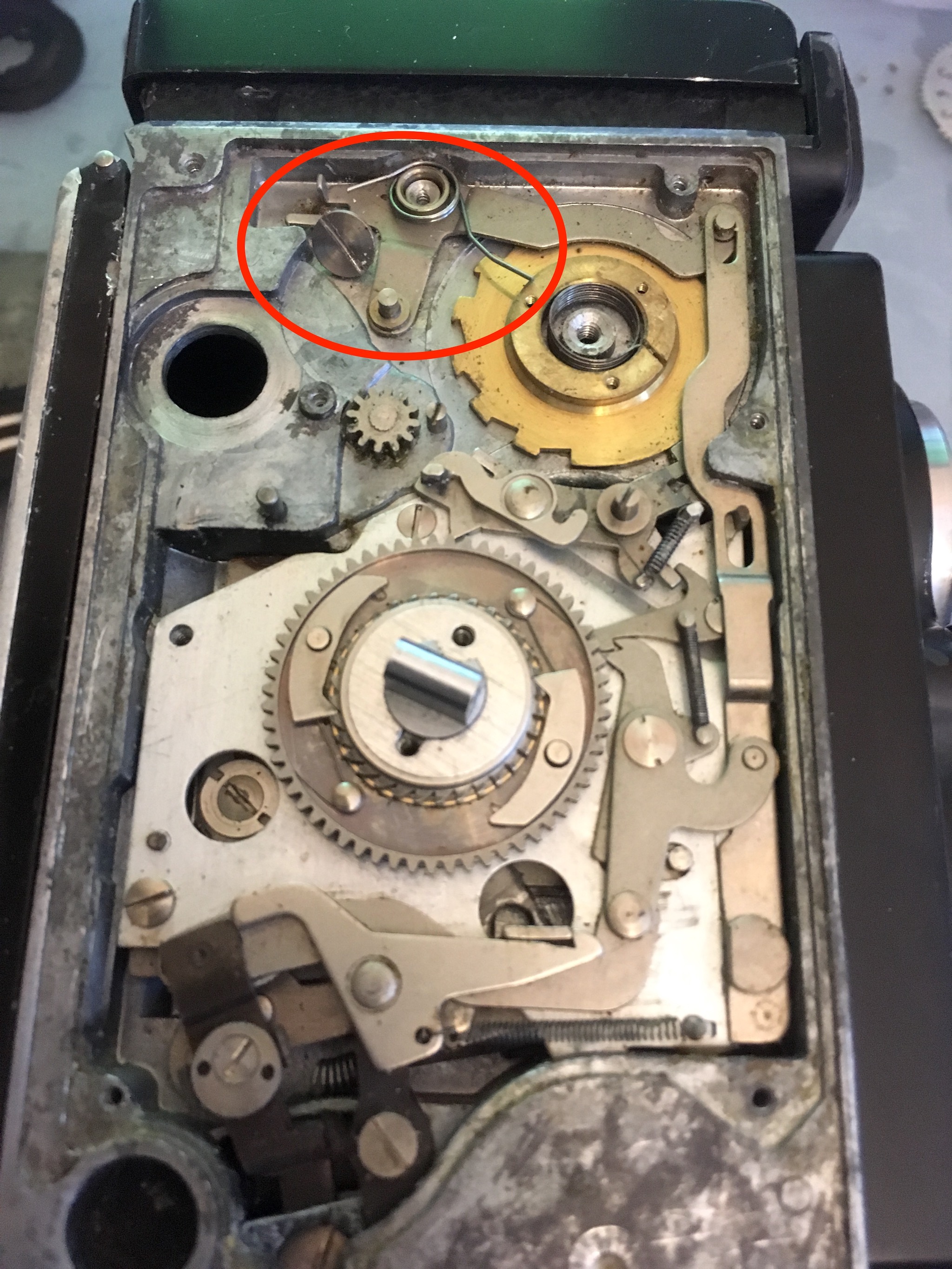

About the counter wheel, remember the position of this brass plate, now the wheel should mark 0 when its screwed back. Taking up spool wheel off.
Now we see how its moved to the left. Unleash the beast!
I mean loose any spring before unscrew anything connected to it.

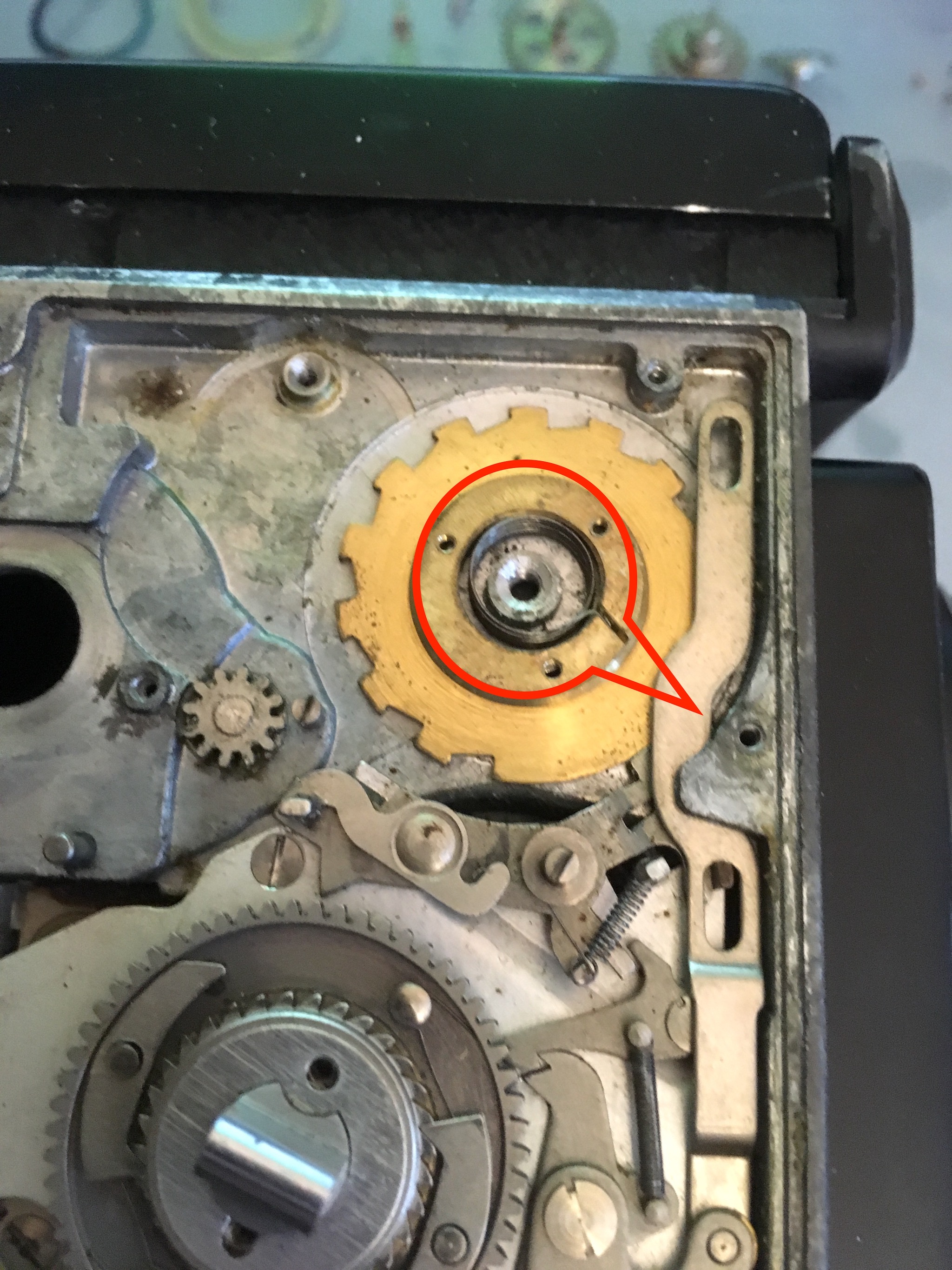

You don't want to loose 5 minutes (if lucky) finding out where it felt with 2 dogs doing the same as you. Reset to 0 spring.
Mark, take photos, whatever but leave a trace where is everything back in place. Reset to 0 spring part II. Mark-mark-mark.
Before remove it mark it. Film detector leveller. One side of the spring. Both sides of the spring.
Keep it together with the main piece. Taking out the close door tab.

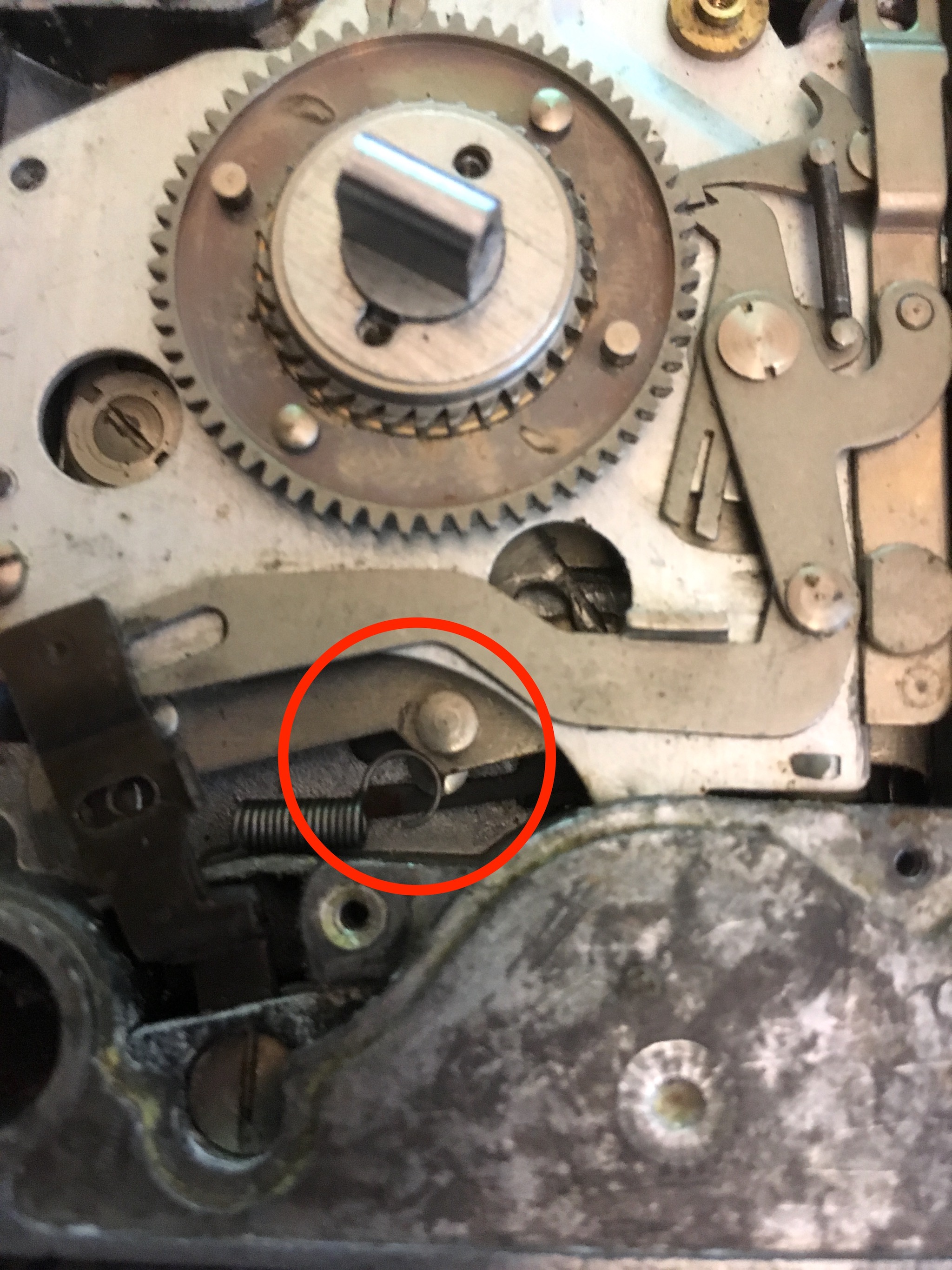

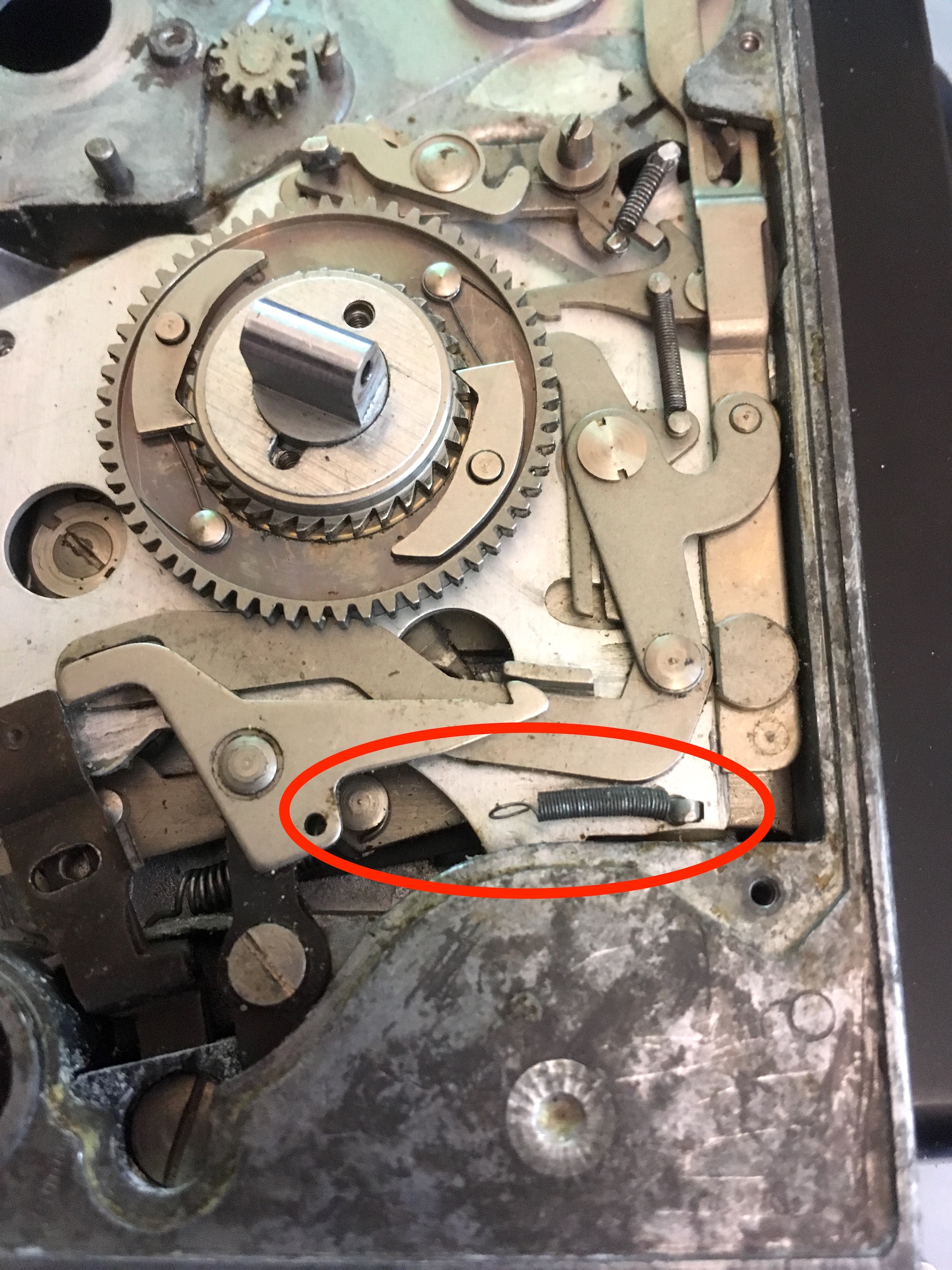

This mechanism stops the winding wheel until a photo is taken to prevent blank frames.

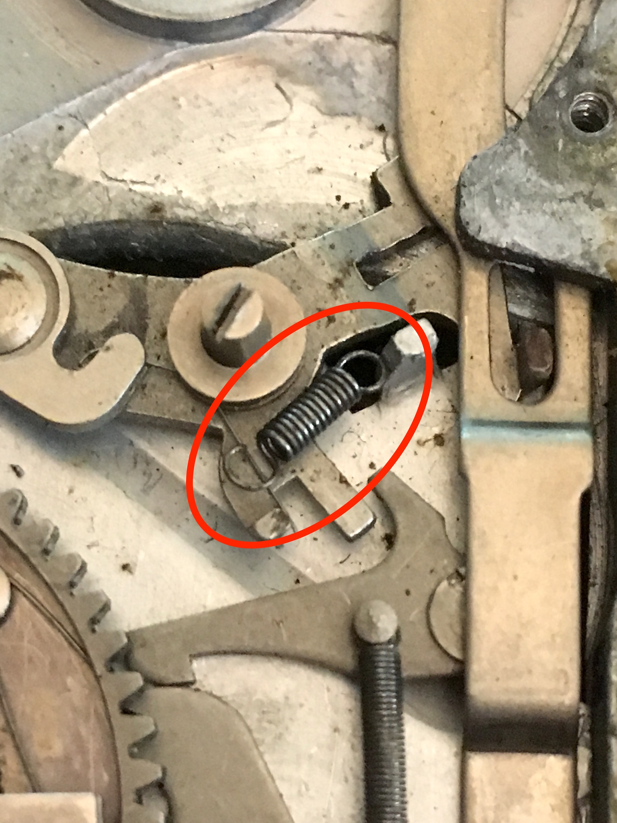

In red the small spring and watch out this even smaller hair spring, that is its position. Remember which side is correct. Unscrewed.
Dont even bother to take the spring from there!! The twins doing click-click-click.

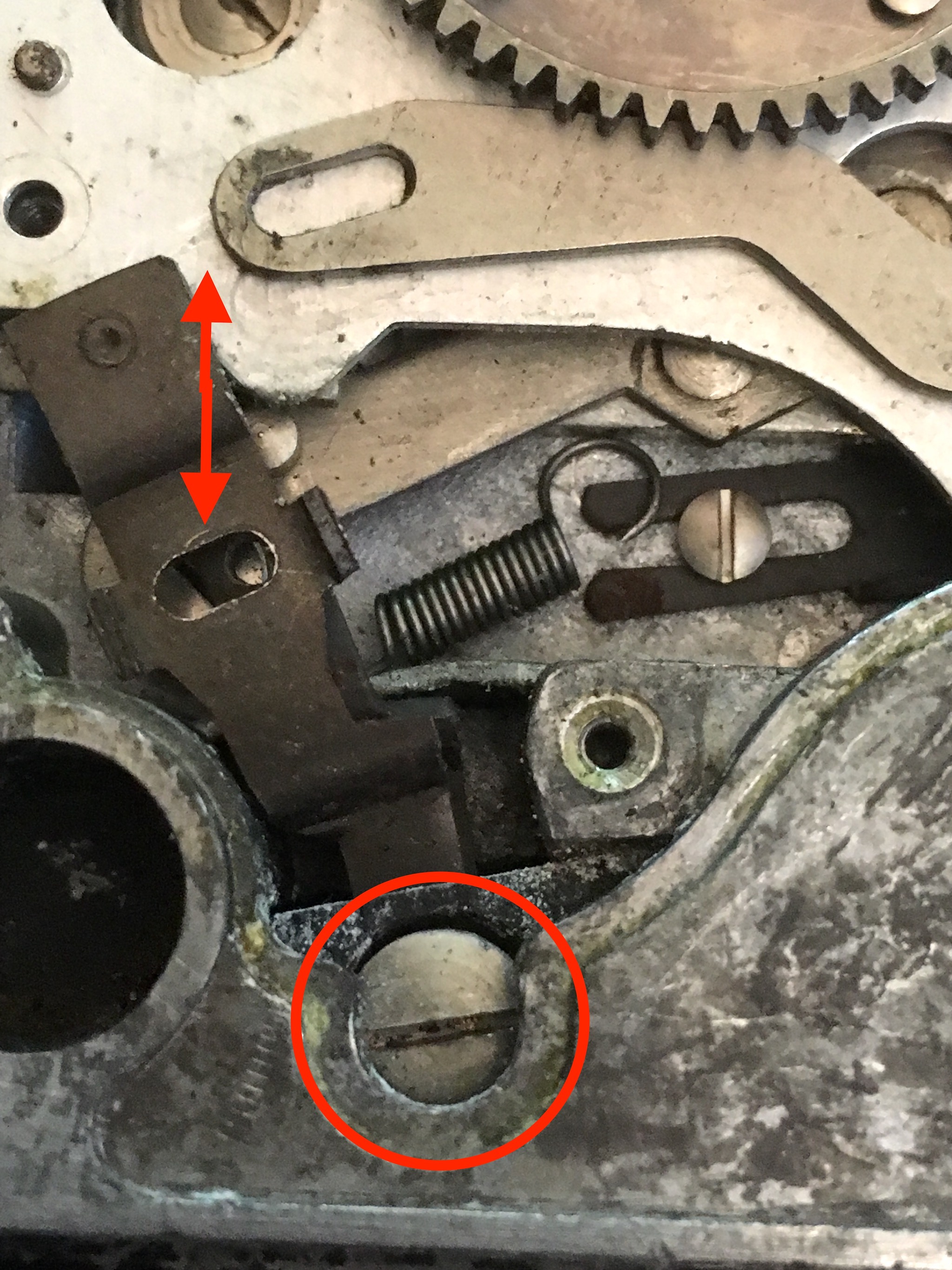

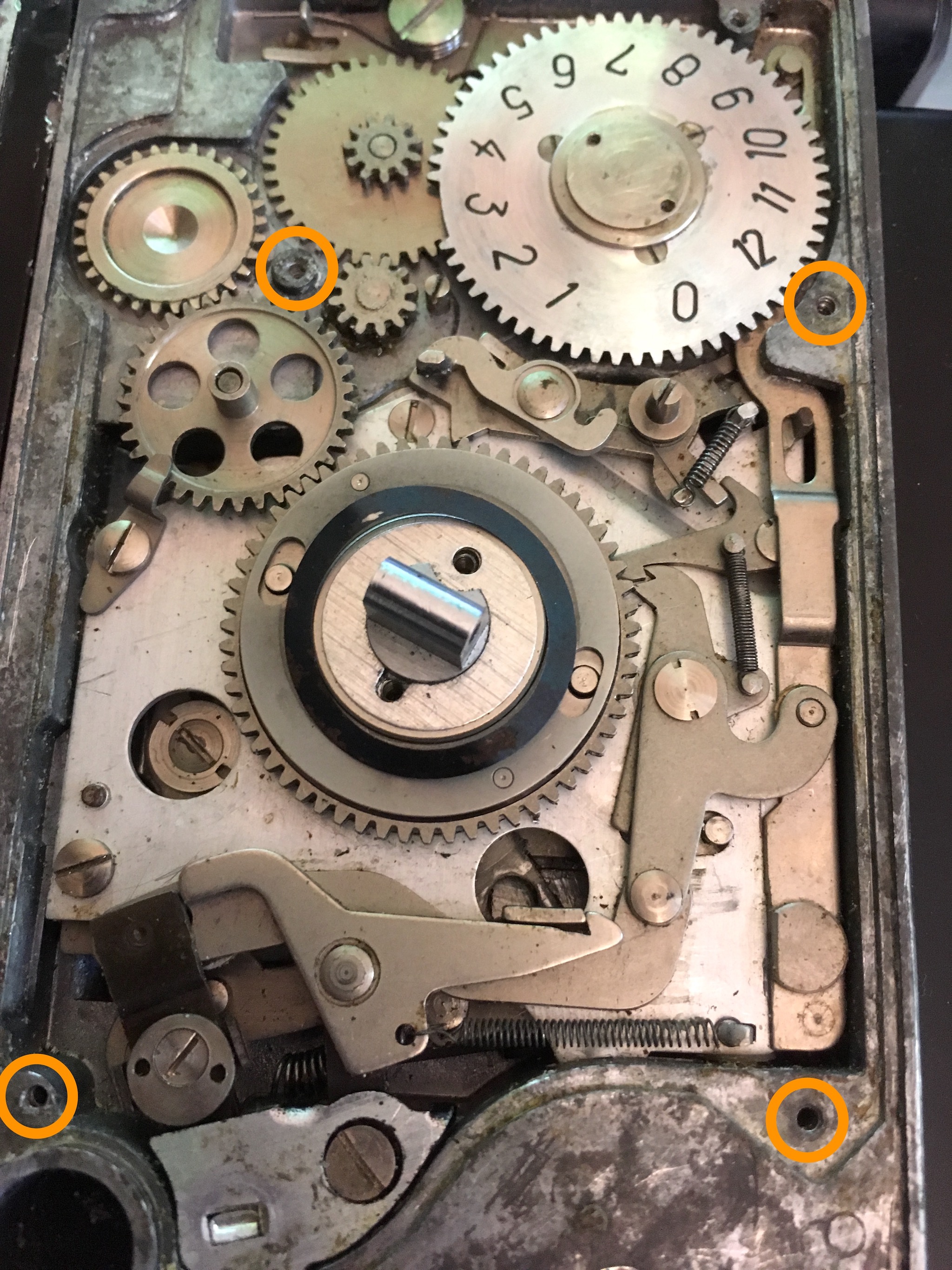

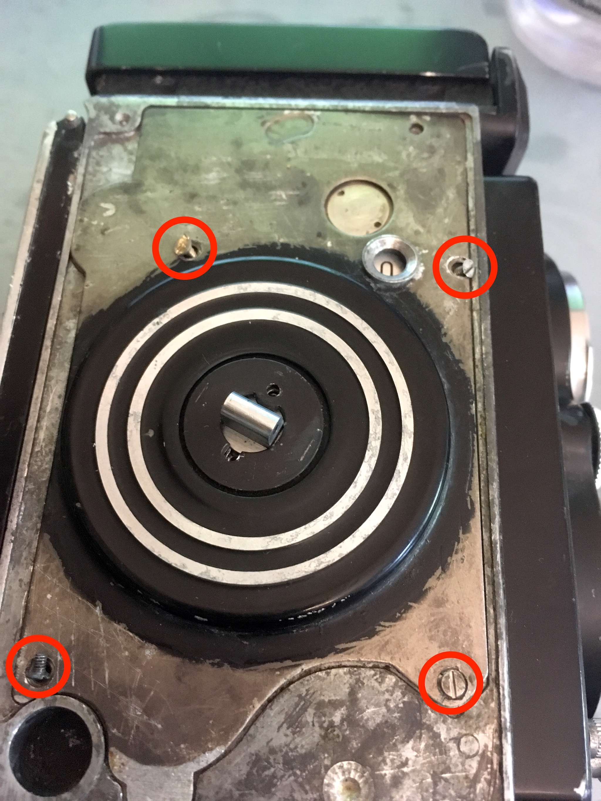

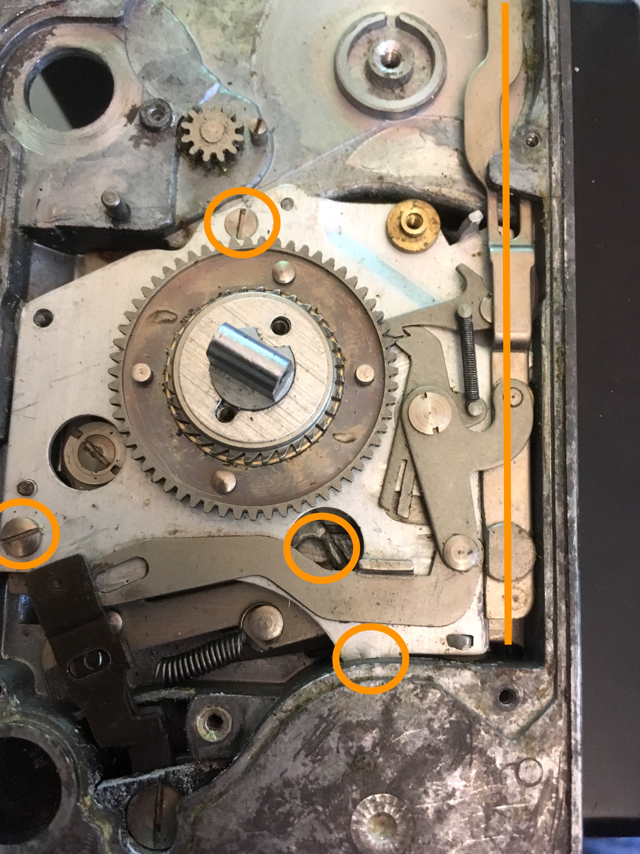

You can remove them from the beginning, their springs and very easy to jump off, guaranteed! Marked are the points holding the plate in place, two screws at 8 and 12 o'clock. Small tab going inside the aluminium case down. Right bars blocked by the case and bellow the plate in the centre, there is a hole where you can see the mechanism that cock the shutter everytime you wind on and wind off. Before removing the plate #1
Loose this spring, only this side, I can't see how is connected the other side so I leave it.
Also it will be necessary to move the cocking shutter arm freely later. Before removing the plate #2.

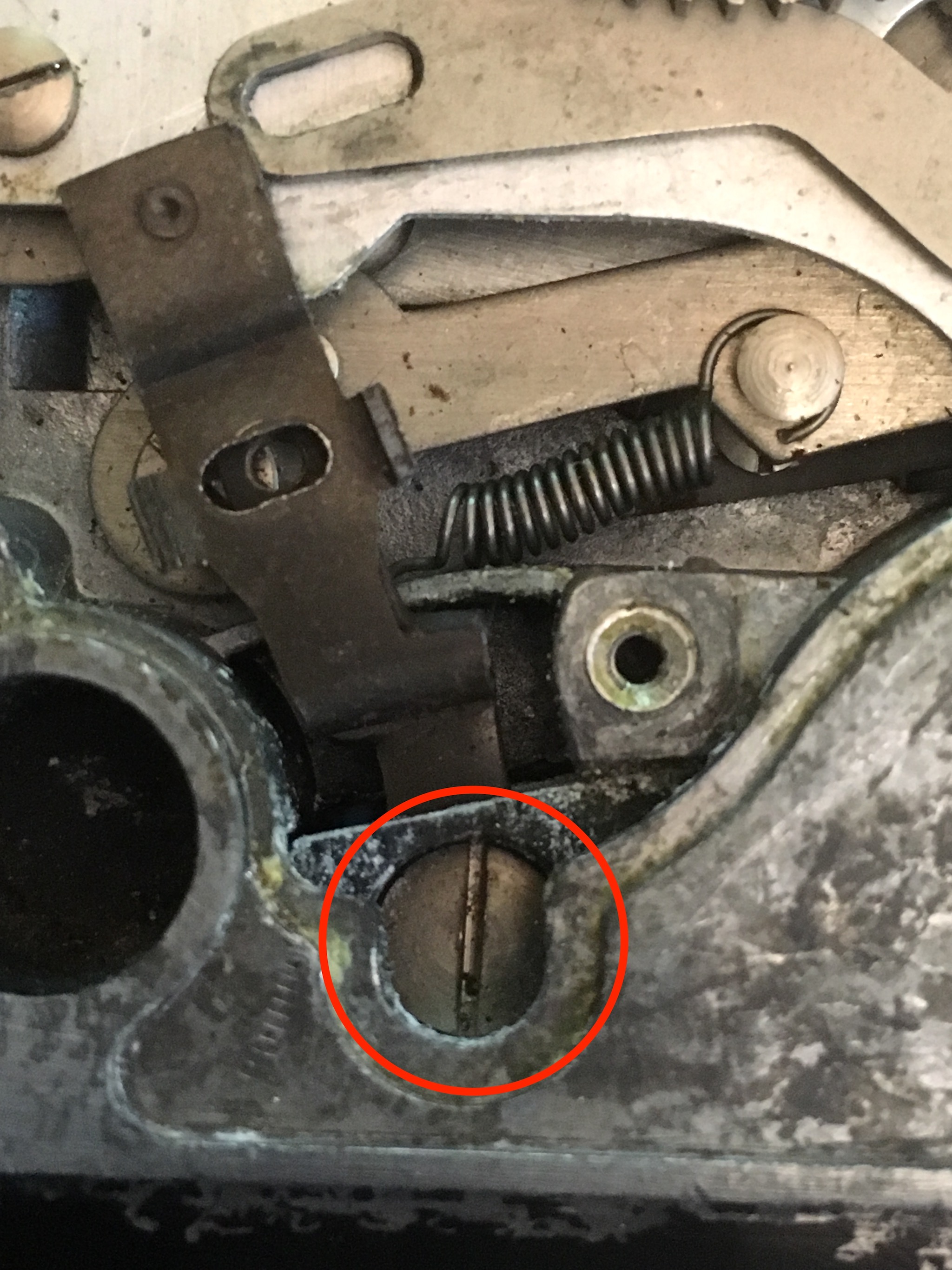

Get ready the right bar to unlock its movement, this won't bend anything if done carefully. Before removing the plate, #3.

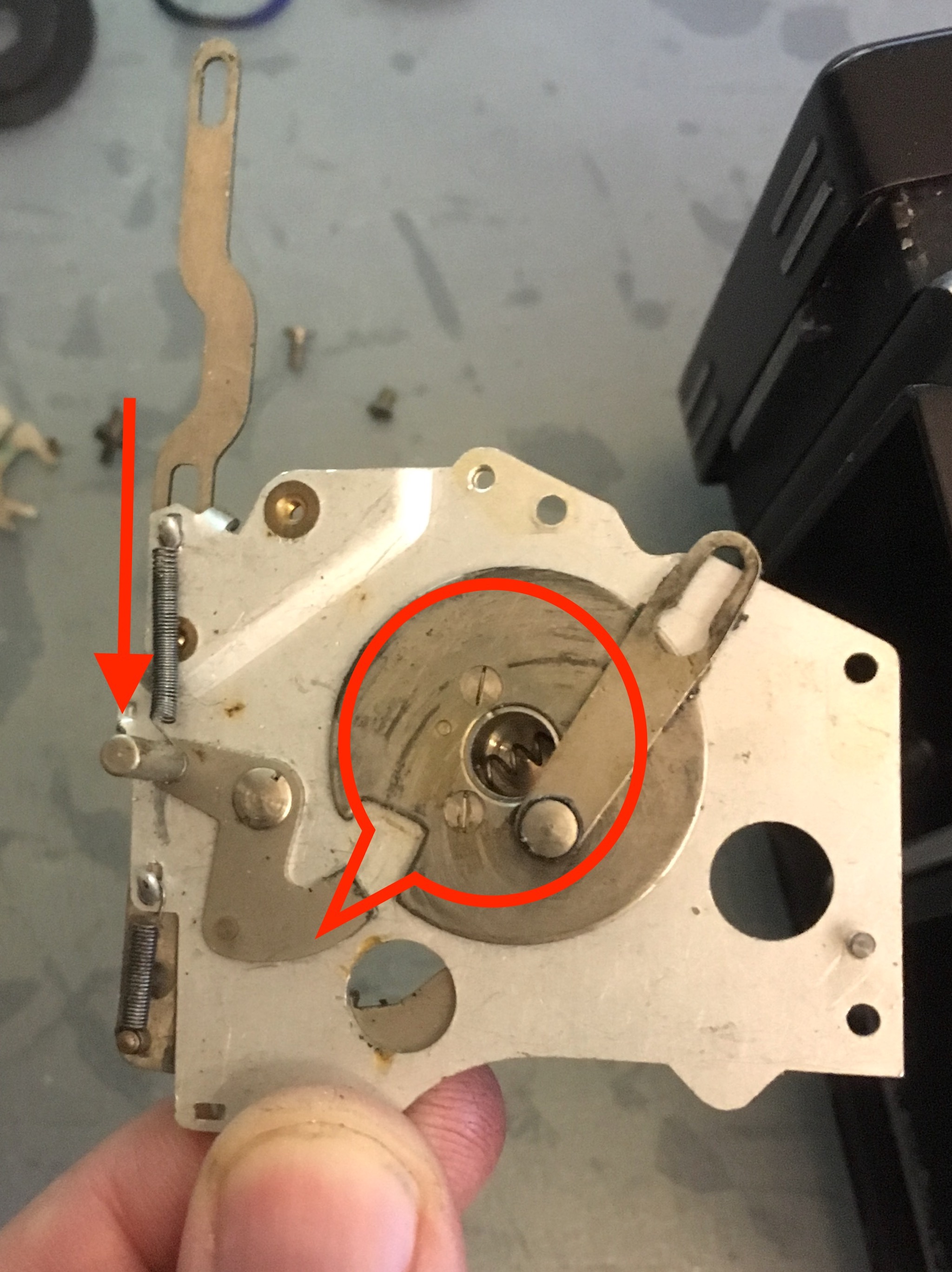

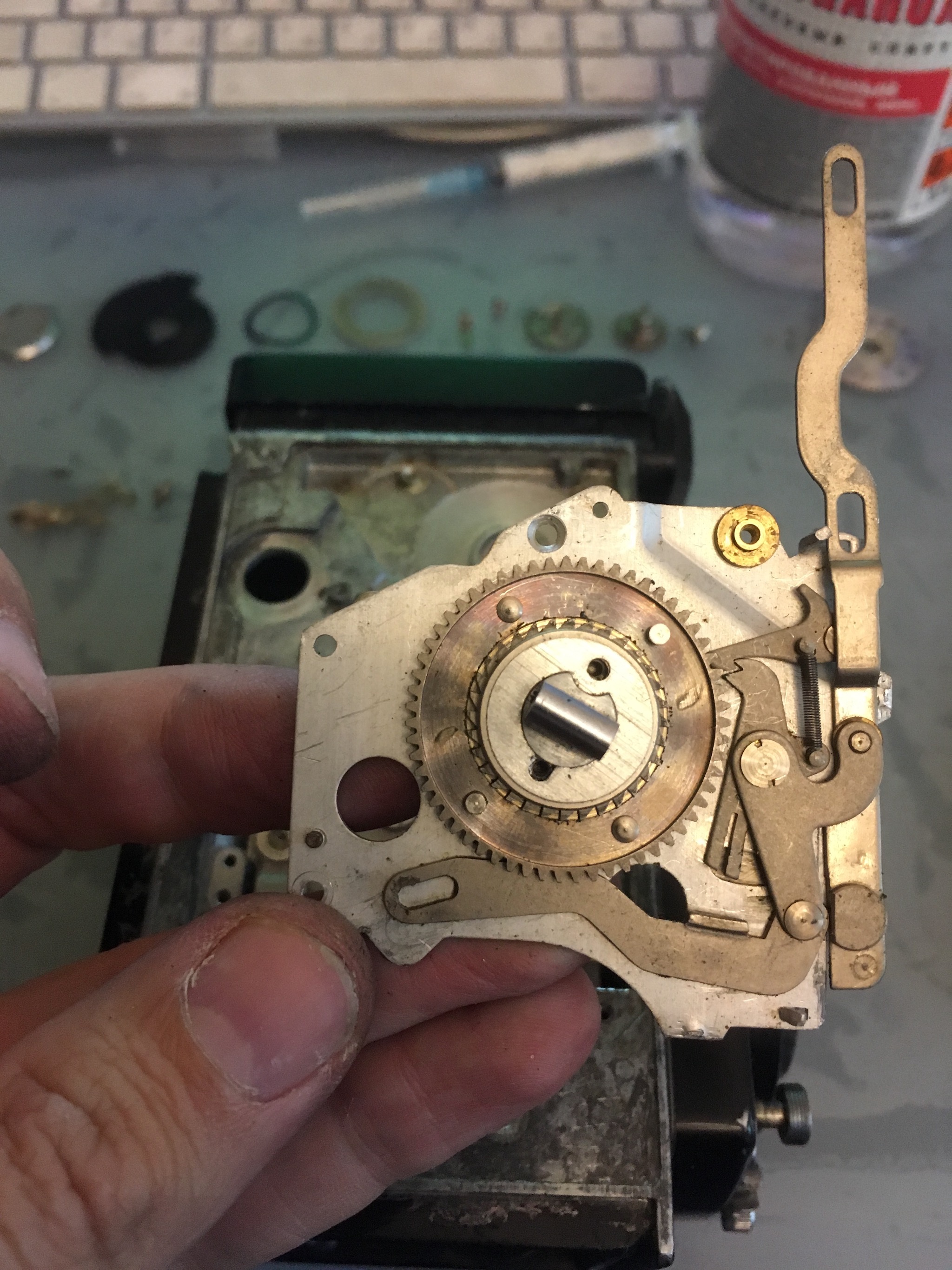

This screw won't take out but it leaves us enough gap (up-down arrows) to take out the plate. Removing the plate step by step.
1. Push up to unlock the bellow tab.
2. from the left side start pulling out until you have an small gap.
3. Push left to release the right bars from the camera case and..
4. When doing point #3 find out the coincidences between the pin of the cocking shutter arm and the inside leveller from the winding mechanism so we can finally free the plate. Focusing system and others.

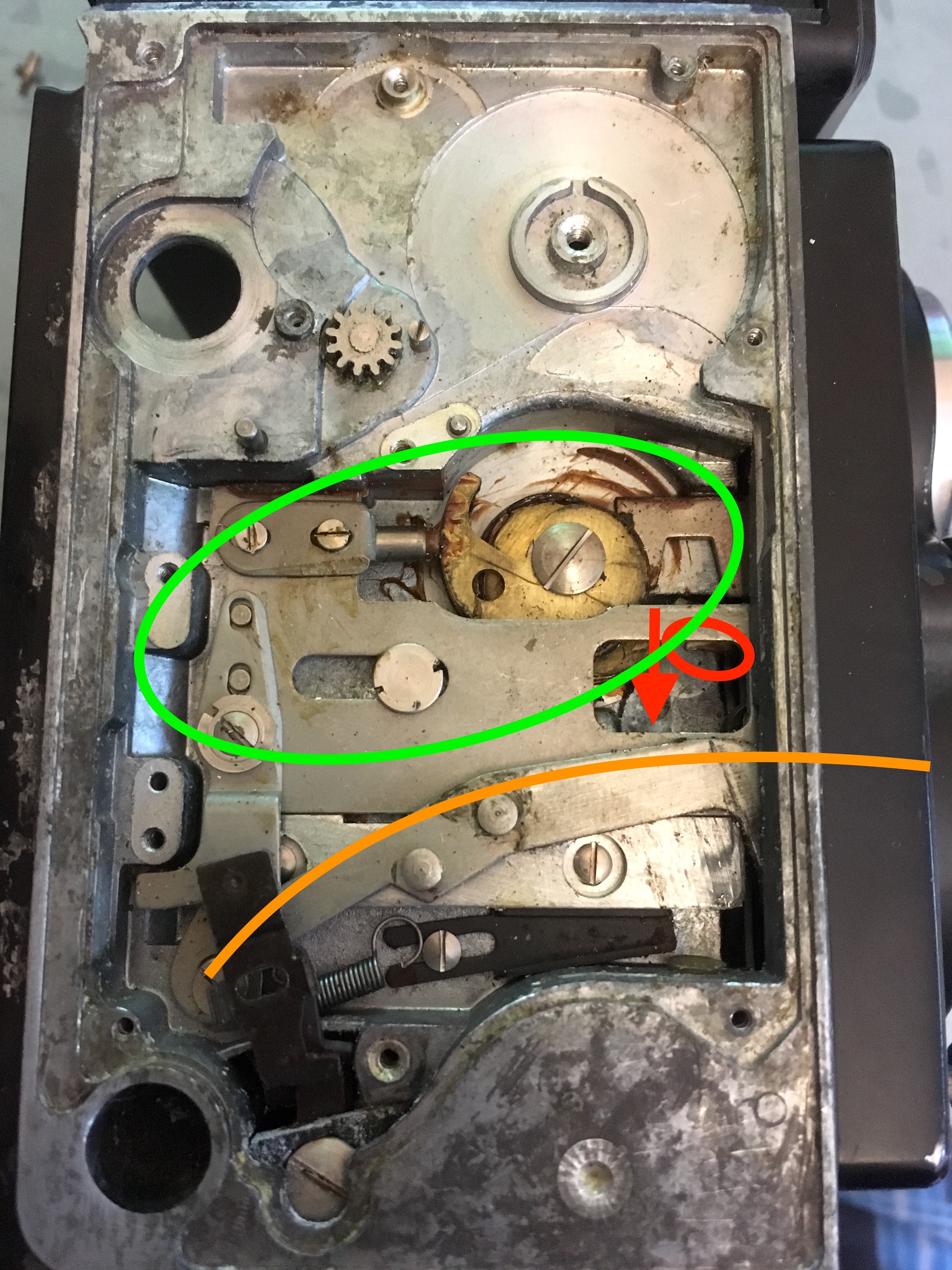

In green the focusing system, it works very smooth so Im not sure if I will touch it.
Orange the shutter cocking arm.
In red the shutter release, it does a up-down movement and it moves... next pic. Continue...
Re: Rolleiflex Automat 3.5 model K4A
Resume...
Reverse.
The shutter release moves the red leveller from the previous picture and here is the reason you have to place back the crack before doing a photo, if not in place the shutter release is blocked. Front. Time to clean.
