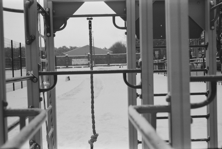

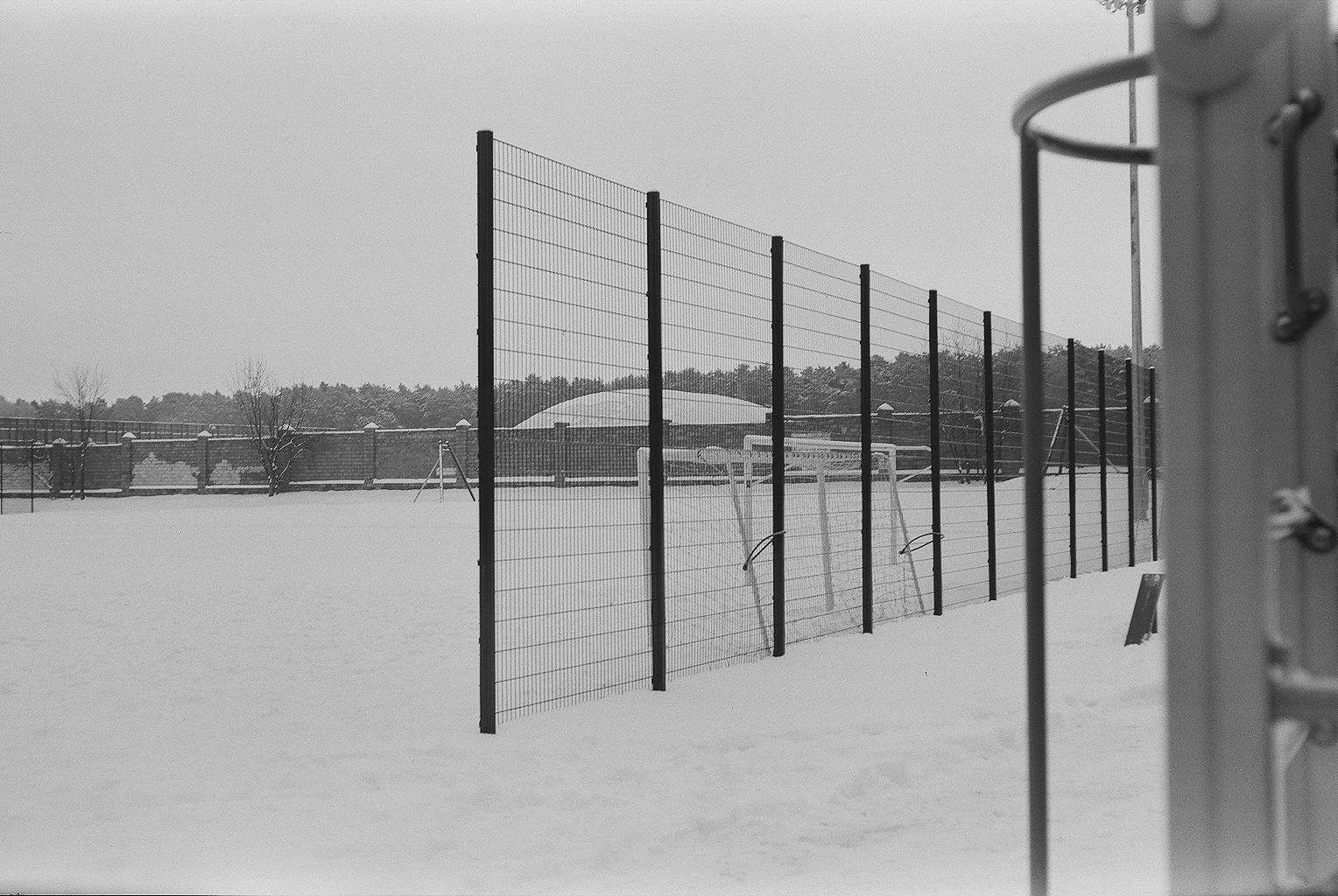

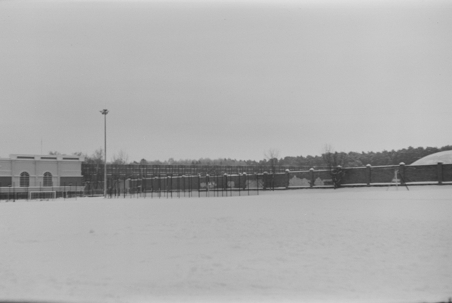

Well another roll.
Setting on the three first pictures was f8.
This one is infinity setting, out of focus (or without the definition that it should) This other was 3 metres focus, same thing, focus object : the rope Here at 7 meters focus everything seems to be in place, focus object: the fence. And here (forgive me Lisa) all good at 2 meters focus. Another issue is those white band along the up and down borders, they were not before in the last roll.
Everything was shot in 5 minutes and the last one 10 min later, I followed as PF says, just don't wing all the film, open and then position the new frame to expose. The camera had the case put, so light leaks from back are not probable, could be light leaking when the roll is exposed and rolled when I delivered to the lab?
So I continue with focusing problems, but I guess I'm nearer than before (could be a solution take out the shutter to quit or put spacers?)
And light leaks, just checked the bellows and they are fine, if any they are super super small.
Ideas welcome

Well, it is converging! Much better! The 7-meter shot seems quite right to me. I think that your focus is right enough now.
I have got similar light leaks from not-enough-tight rolling of the film into the take-up spool. If the leaks increase as you go from the first frame to the last, that is a probable cause. You could also have a leak on the back of the camera, in that case the leaks would be irregular depending on the time between shots.
Was that roll really tight when you opened the camera?
I am not familiar with the Bessa, but usually there is a spring or device in the take-up spool, that presses against the paper to make sure the take-up roll is tight. The spring might need a little bending to to a better job.
- Posts: 2461
Re: Voigtlander Bessa RF 6x9
Loose rolls are the bane of all 120 users. Like Julio says, check the tension spring to see if it is against the film roll. Don't know what to say about the focus, except to keep working at it. It will be a fine camera, Alex, once you get that sorted out.
