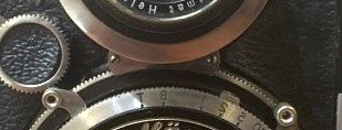

I have a Superb with a Heliar lens and I'm doing an overhaul myself. The helicoid is super stiff and I follow your steps but I couldn't remove the shutter in order to clean the helicoid. I removed the screw under the focus knob but seams is stuck and doesn't come out. I think I must remove the lens cup inside film chamber but I can't see any holes to fit a spanner. Am I correct about this? The rear lens should come out too?
Another question is about the viewing lens. How can I remove it? The explanations are not that clear. I removed the distance ring and then I tried to unscrew anti-clockwise but I couldn't. Is there a particular way to do it? I noticed 3 very small screws around the front ring but I presume they are for removing the front glass to clean it.

Ok Alex. Meanwhile I send you two photos, one from inside film chamber (you can see the lens tube pipe) and another from the front. I can't go further from this point and the helicoid just barely start to appear.
I can guess the rear lens pipe should come off. I tried but seams very tight and I don't have any holes to put on a spanner. Someone told me all unit (tube pipe, rear lens and shutter) comes off together after removing the helicoid or just turning the shutter to 10 o'clock position. I tried but seams not work for me too.
I will be waiting. Thanks.

Ok... first hint... have you removed the small metal plate between viewing and taking lenses?
Edit: Yes, I see from your photos you did....
