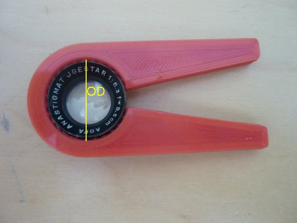

So the 3D printed wrenches just arrived. The stuck cells have been soaking in Goof-Off for a week. The wrenches fit perfectly, and with quite a bit of effort, the cells came apart! Woot! Can start moving forward with this project again. Thanks Pablo!

Absolutely, let me know the diameter of the elements (xternal) that the wrenches need to grasp.
That way I can personalize them for you
I sent Scott a few since I didn't know what size element he had but the Ikoflex might be a bight larger than AGFAs
3D Printed Lens Wrench measurement
