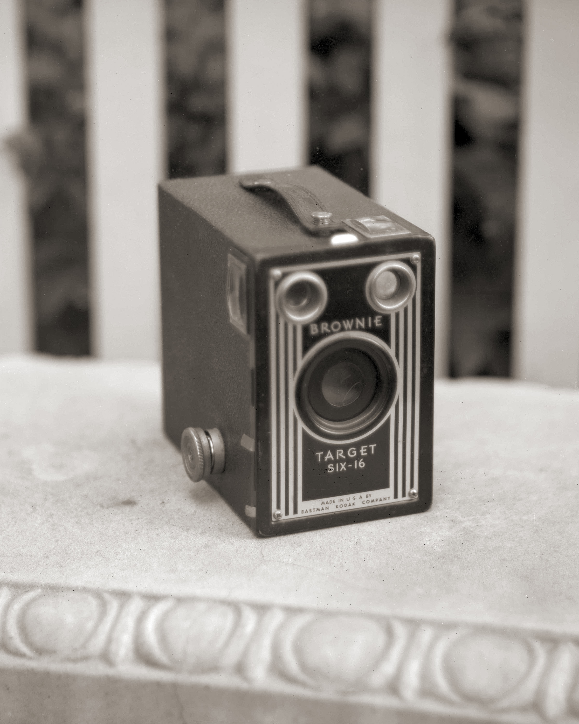

These are the ortho film equivalents that I'll be comparing the tintypes with (the sensitivities being very similar).
Ortho test shot 1:
Ortho test shot 2:
