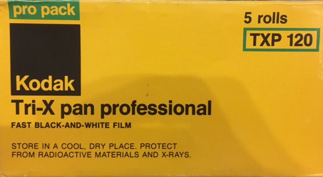

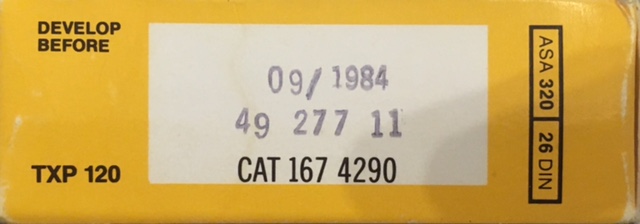

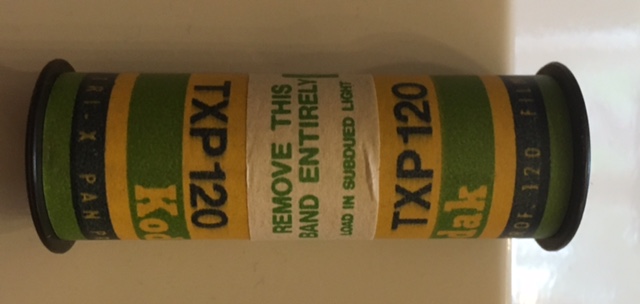

Hello,
I got one roll of this:
Which I shot wrongly at 125 (I read on internet before I read the box).
Shows different tones on the borders of the film, as far as I know it was kept on a freeze.

Fog would be the main problem, with that film age. It may be corrected (somewhat) when scanning, but the negs must be showing quite a bit of fog.

Give it about a 15% contrast boost in post processing, Alex. When I saw these on Flickr this morning I couldn't figure out just how you could get such results, but as soon as I saw the film roll shot I knew. I think the rule of thumb is a stop for every decade out-of-date, so you needed one more stop. Great details with that lens. It shows why people are willing to put up with how the camera handles.

So 4 decades already, 4 stops down as the film(320) was 50? 25?
These ones I shot them thinking it was 100ASA.

Tri-X Pan Professional was 320 ASA for normal development. I would rate your 1984 film at 200 as a starting point.

If the starting point is 200 the ASA I should shoot it is 12!!
Around speed 90 - f4 in a sunny day.
