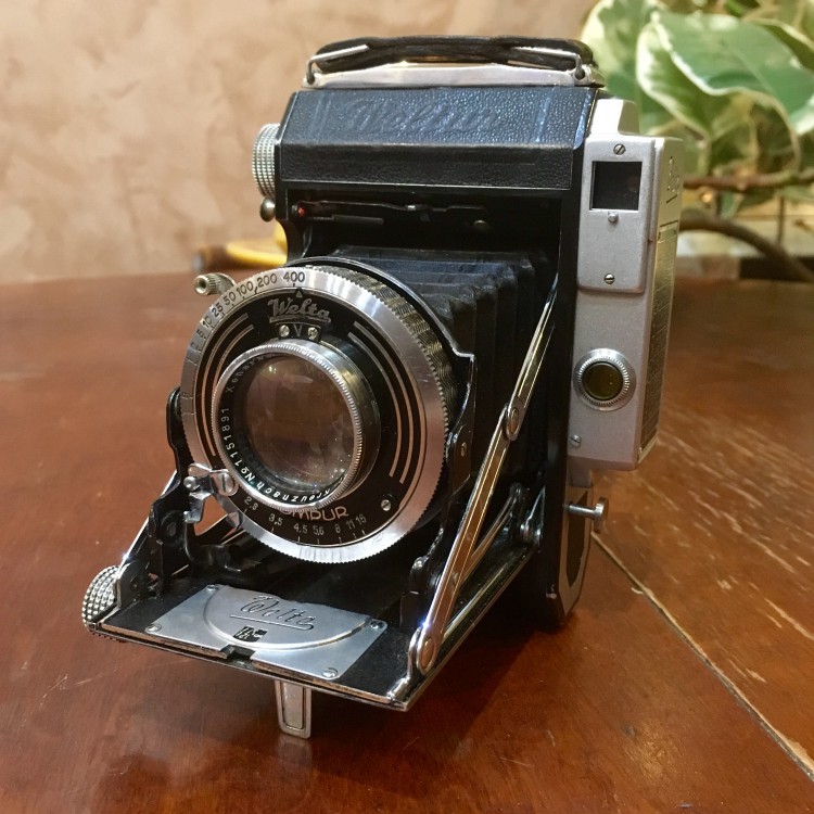

Month ago at my "dealer's house" I found a Welta, model Weltur 6x6 6x4,5 (no mask), after a quick check I saw the wind know was not the original (it could be winded in both directions) and the hand strap was missing so he gave me permission to try something with it...
At home I saw some bellows problems (one crack on a side and some holes near the front lens), I used the Liquid Electrical Tape I have for this moments and after 24h drying I tested them back and everything was fine.
Next was the wind knob, lucky me there was a local auction of a "Welta Weltax"
Very "original camera" AS-IS its not enough, the price was around $15 shipping included, because after doing some digging it seems Welta used the same know for every camera of those times and hey! there was a leather strap there as well! The best use that camera could have is the one I did.
As soon the camera arrived I took out what I needed and trashed the rest (the lens Kodak 10.5 I kept it)
Now the problem was the Weltax knob was CCW and I needed CW for the Weltur, so thank you very much to the german engineer who though a system that changing the inside spring up side down this can be achieved.
