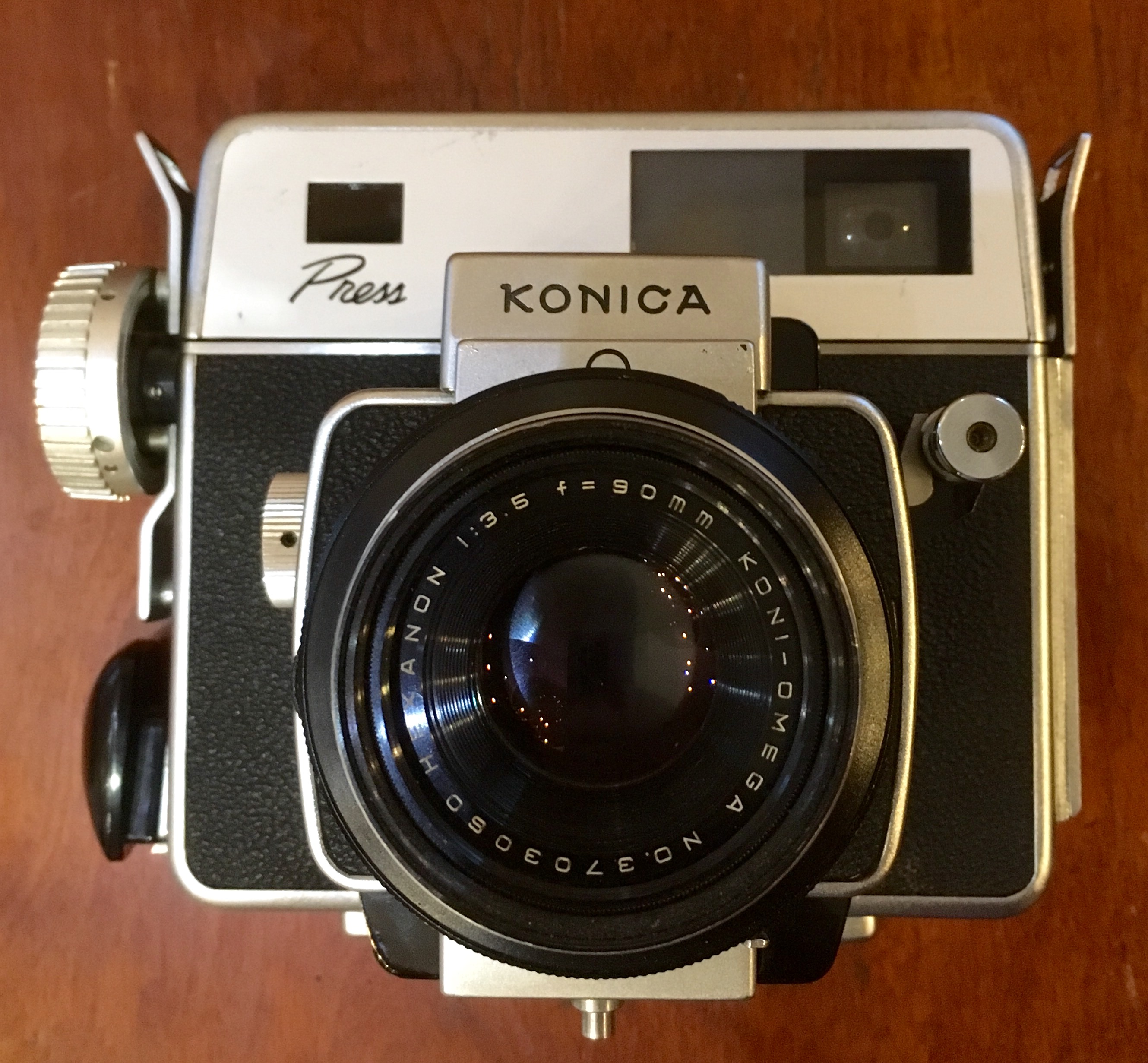

In my search of a 6x7 camera I had the chance to have one of these in my hands and I bought it at first sight, it's massive and super cool!!

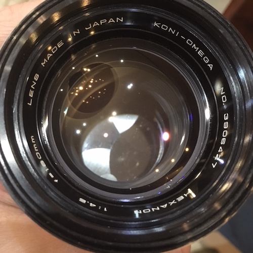

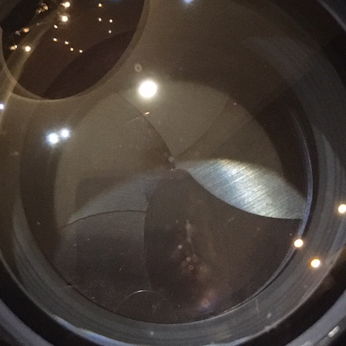

It came with the 180mm tele, sadly cleaning it it felt to the floor (credits to my left elbow) and the shutter blades went out of place... I have the service manual and I have written it down in my to-do-list.
I took the test roll today and Im waiting the results (done with the 90mm). I think nothing outstanding will come out but it was to check speeds, rangefinder, parallax, etc...

I'm on it already, I got stuck due lack of instruments for big lenses, I will pay a visit to my colleague here...

Btw the first roll is out, only 3 photos are "decent" I explain, when I got the camera my shutter speed tester didn't work so I was unable to test the shutter, I guessed the 125 would be accurate, wrong guessing, now after seeing the results I tried the tester and now worked, result is 125, 250 and 500 works as 500 and 60 near 100. The photo were underexposed by at least 2 stops so the meter seems accurate.
Only from those 10 pictures 3 "has been recovered" and their levels allowed so. As well the roll was a try-x expired 20 years ago.

Speeds are great, only 500 is a bit shifted (350 actually) the rest of them near to be nailed +-10%
Lens is great.
Only the viewfinder is a bit dim but pretty usable, I will open and clean it.
Now the 180mm has to be repaired and the only left is the 135mm which I have never seen any yet :)

Good news, I fixed the 180mm, lenses with leaf shutters are 90% from behind and I found they way in...
Tomorrow I will finish mounting it and I will post some fixit notes.
