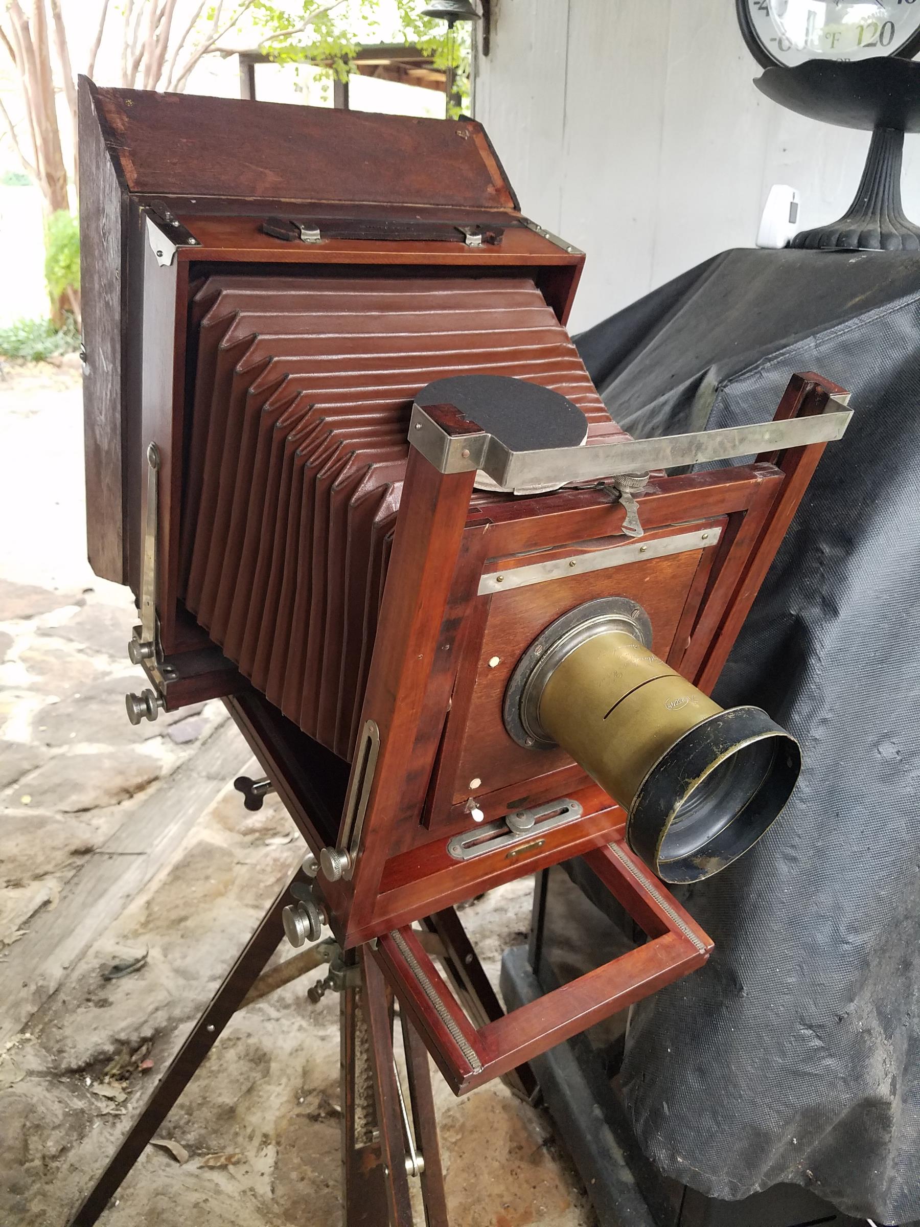

I learned also that the lens can handle up to 11"x14" fields when used stopped down (via a Waterhouse slot) or close up (the cone diverges enough to reach the corners in this case). I recalled a friend's suggestion one time that I might consider adding a rear adapter to my 8x10 view camera for large format, so I went to work. A 12"x12" wooden "canvas" from a hobby store was perfect for mating to the rear of the view camera. I cut up some luan plywood paneling to build the extension box, and quickly hacked together this extension. I decided to model the back side to accommodate the frame of an 11x14 picture frame from Dollar Tree since I knew that item would be a stable source of good, thin glass for wet plate coating. What was missing, though, was an actual working design for a plate holder and focuser.

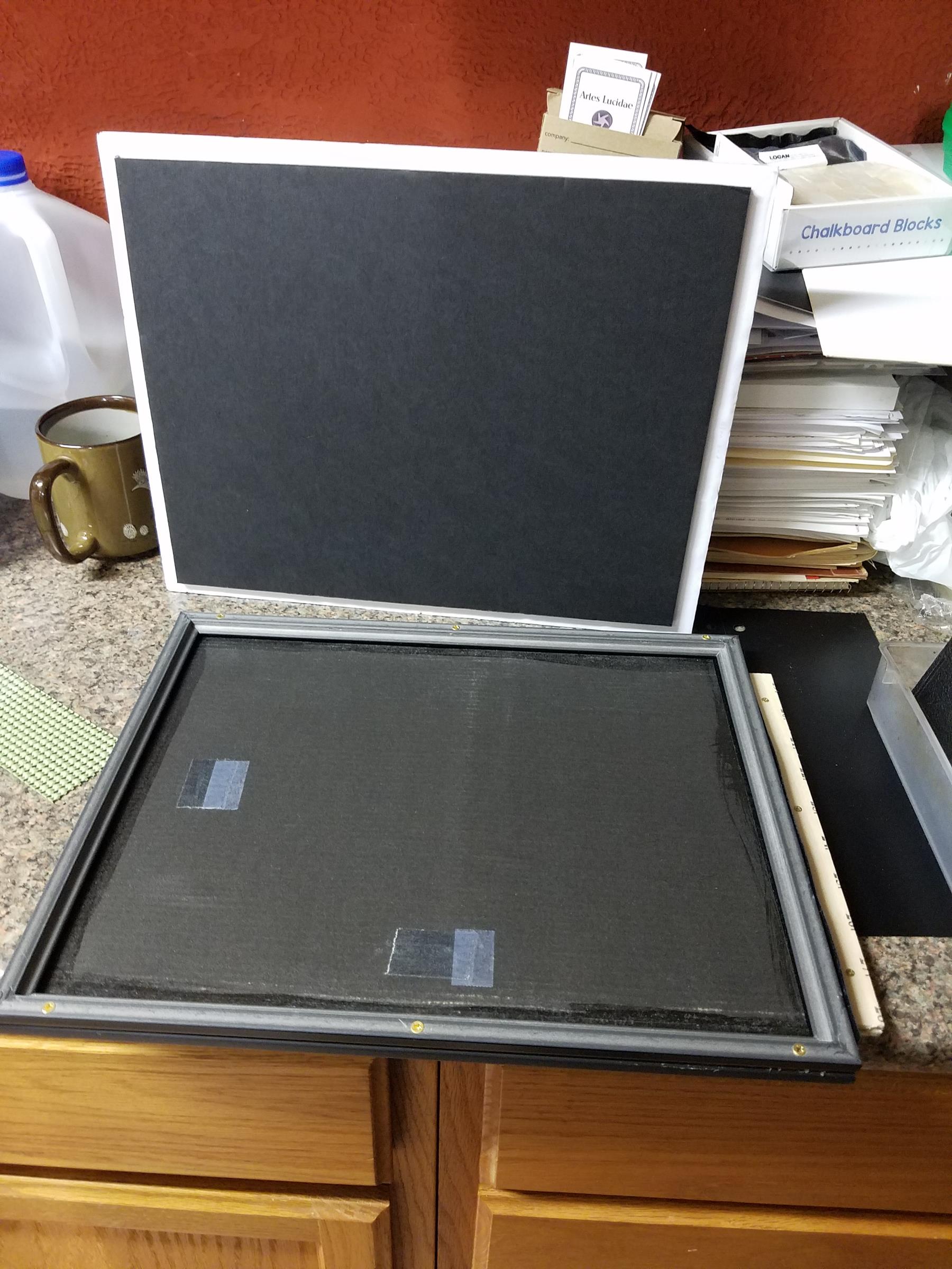

Earlier this week, as I gazed on the flimsy plastic frames I had liberated this plate glass from, I realized that I could stack two frames (secured firmly together by 3 #4 brass screws per side) as the cassette and use the gap in between as the guide for a dark slide. I used a table saw to dado a wide cut across the end of one frame for inserting the dark slide. Likewise, I could stack another two, and I had my ground glass adapter. The backing cardboard could be used as the dark slide since it was already cut to fit. A pair of the hanging hooks doubled as spring clips to keep the contraption in place. And Dollar Tree sells kitchen cutting mats, 2 for $1, that are 11x14" with a matte surface that drops right into the focusing frame like it was made for it. Today I got to try out this cheapo hack, and it did its job like a champ. My first effort was slightly underexposed, but it proved the concept of using an extension back to get new use out of a smaller view camera. This was also my first large format pour, harrowing to step up to but exactly like using the smaller sizes in practice.

Camera from front.
Camera from front.
Open plate holder, just two frames stacked and joined. A foam sandwich closes the back good enough--no light leakage that mattered for slow collodion.

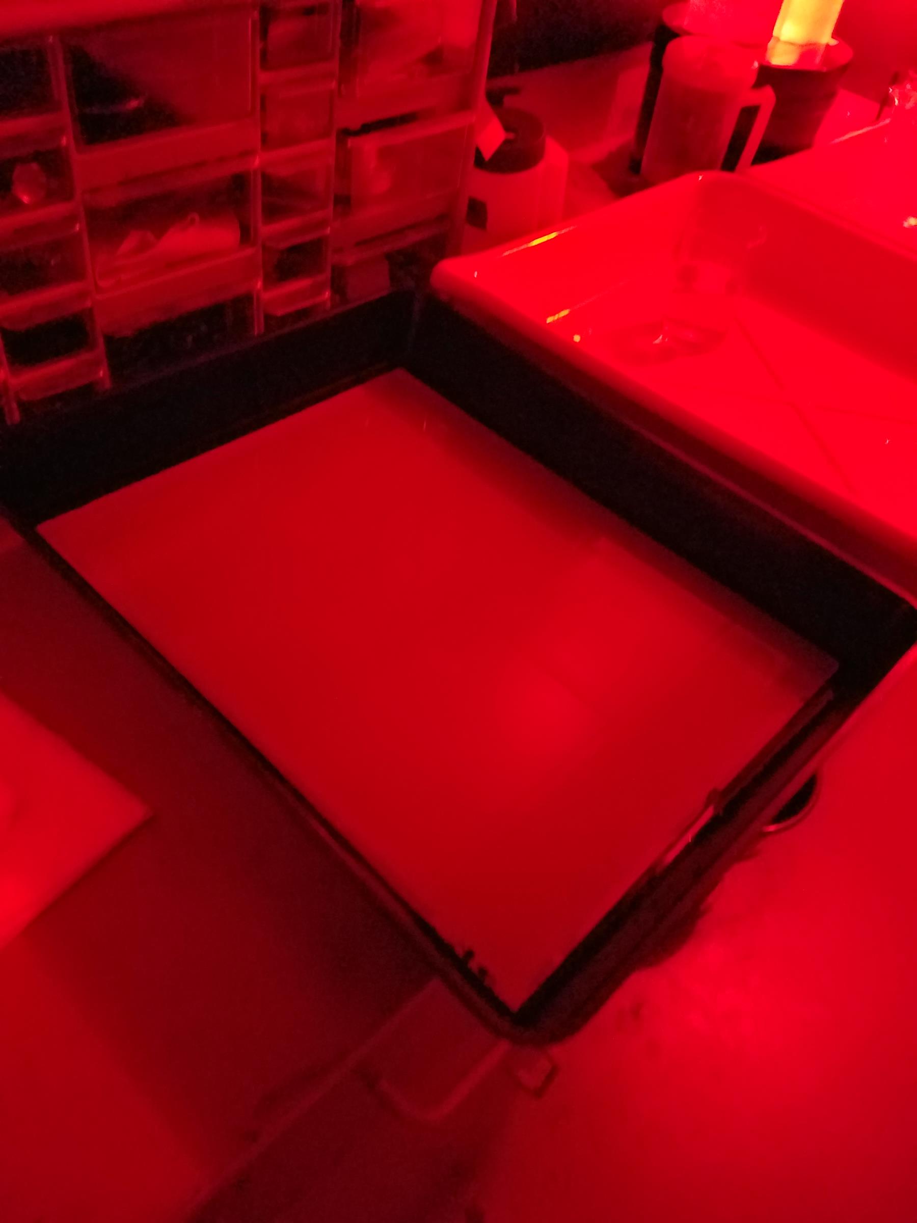

Plate in sensitizer. The whitish color is from the formation of silver halides in the collodion surface.

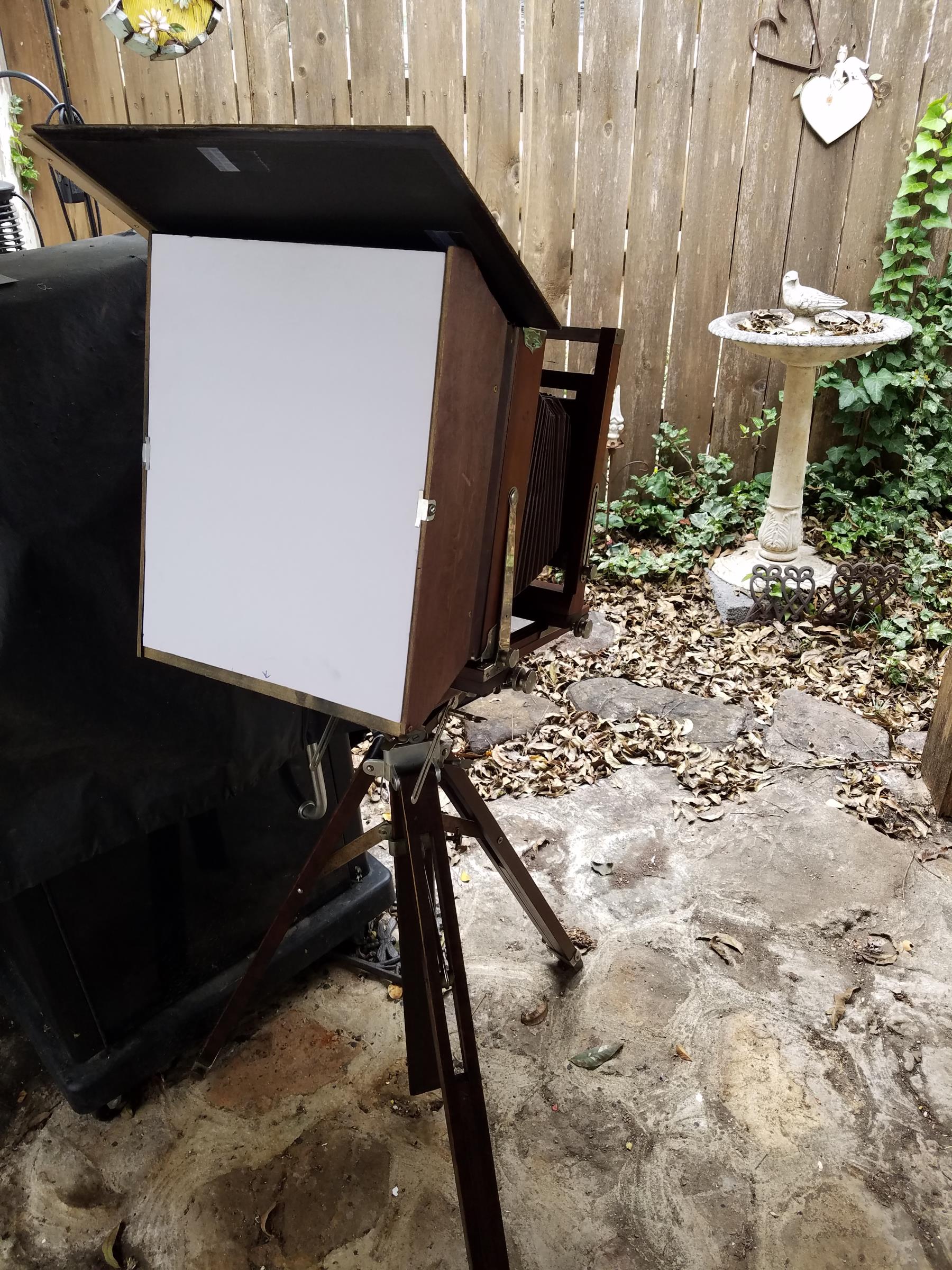

Camera from behind during exposure. Note the hanging clips used in a new way.

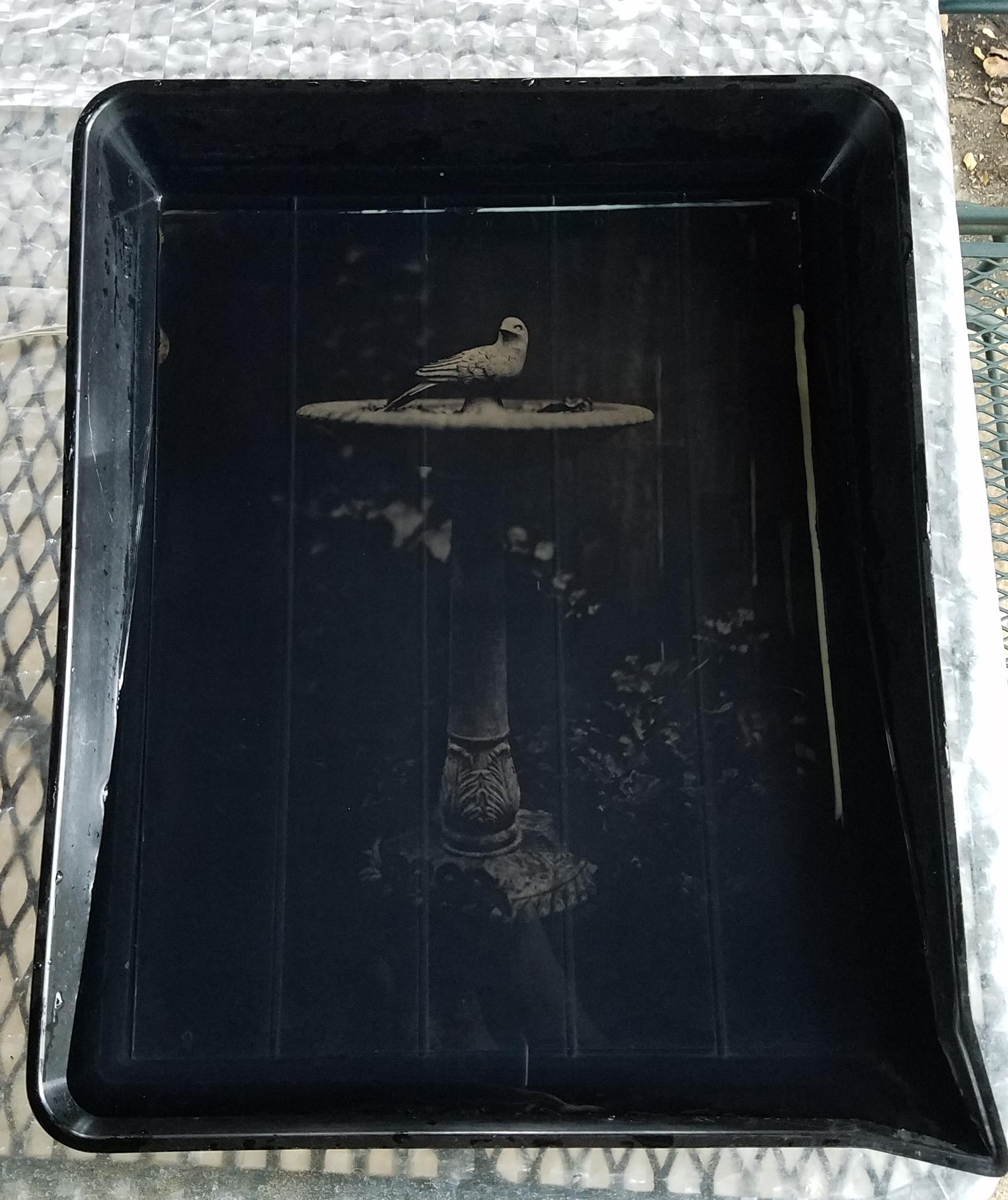

Image in fixer.
Image in fixer.

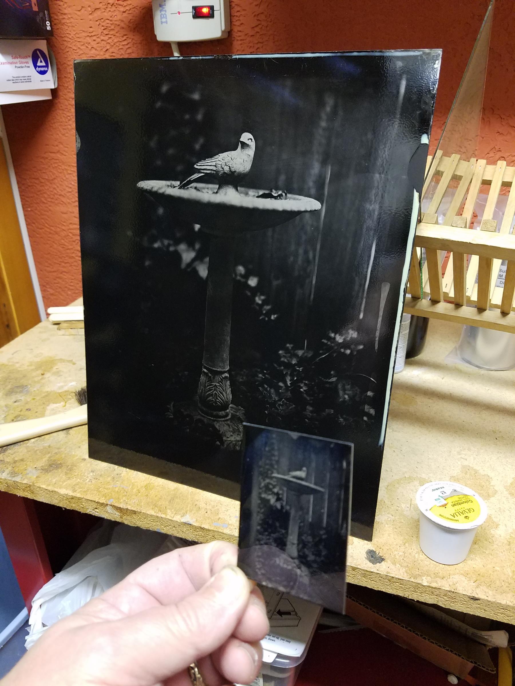

Varnished and backed ambrotype (with a ninth-plate test shot that had better exposure--sunlight changed between setups!).
