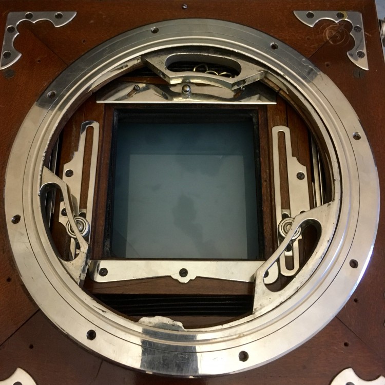

The lens has four elements, rear two cemented, front ones spaced. Still I need to clean them and fix the light leak from the lens thread at the wooden holder.

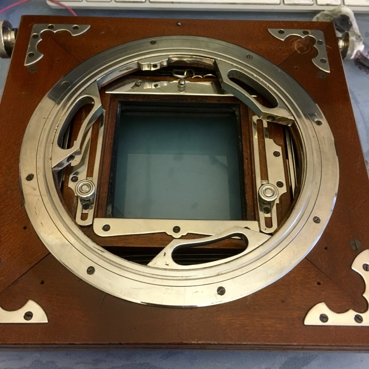

The cleaning will come after I fix(glue) the shutter plate guides at the front, some did force and both of them have cracks about to fall apart, so now the camera is opened and shutter holder plus bellows removed to avoid more tension on this part, tomorrow fine day, later cleaning and weekend shooting if I can place a 4x5 sheet inside in my dark bag. :D

It had the front wooden frame was broken, my guess someone closed this way:
And this two front knobs were pressed by the tripod holder tabs. This tripod has missing its locking screw so it can turn and if you are not aware after removing the tripod it ends this way, cracking the frame.
So I had to complete crack the whole frame to be able to glue it back (wooden glue) as wood has to be glued, letting the glue dry in both sides, stick and press during a day, no photos of how I did it sorry, cracks are still visible at a close look but it's firm now and I trust it will do fine.
This is how it has to be closed, I'm still looking for an screw to lock the tripod holder. Hard to get a bronze screw with nickel covering :)
