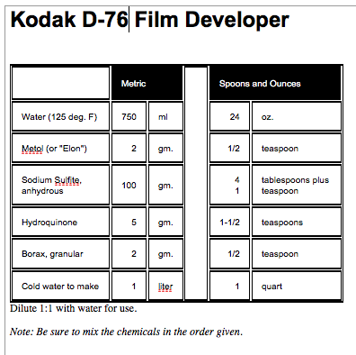

Screen Shot 2018-11-22 at 12.43.47.png (35.76 KiB) Viewed 16504 times
