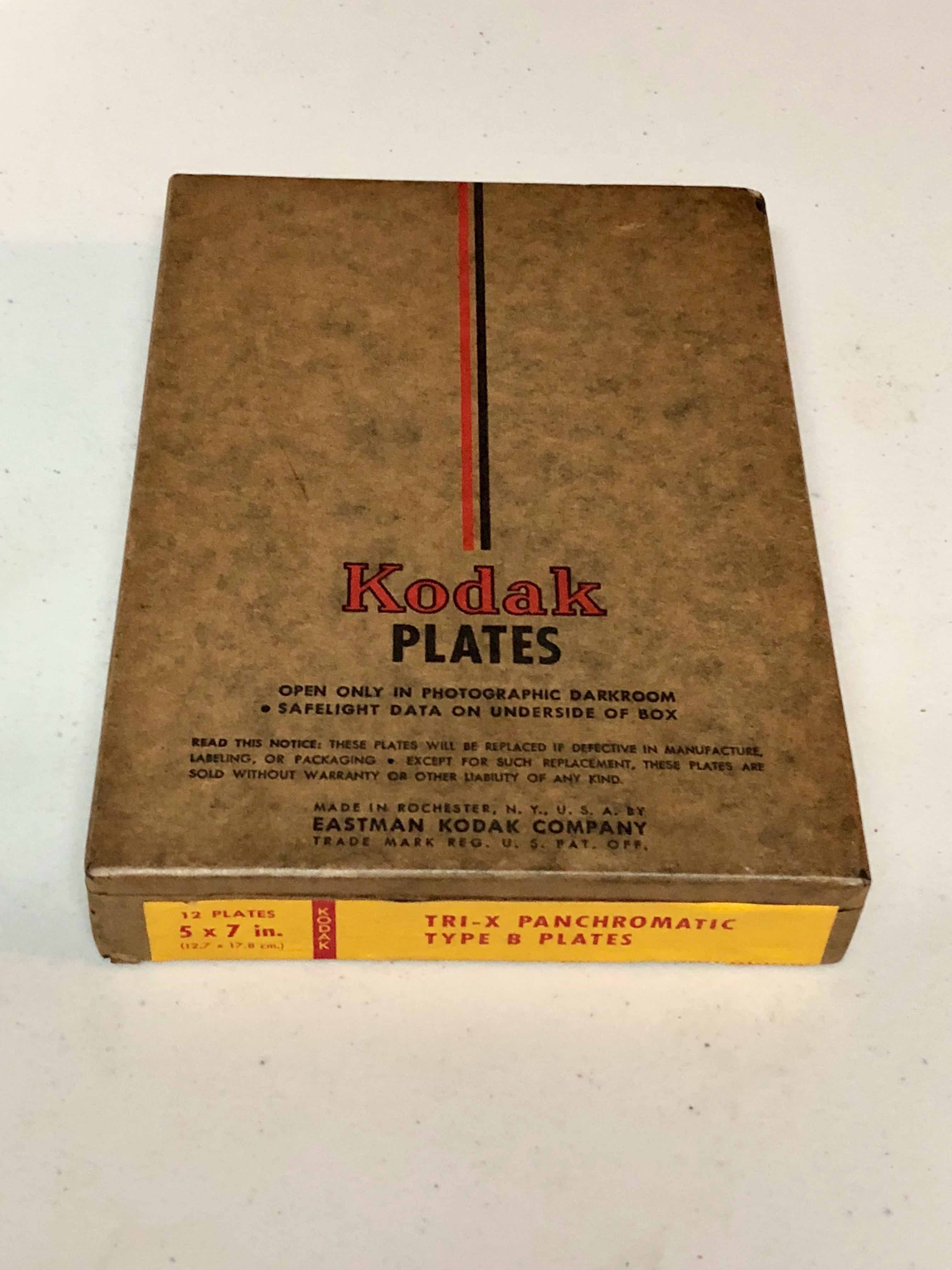

In my case, I bought a set of six boxes of Tri-X plates, from the look of the packaging, I'd guess late 40s to early 50s. One box was already opened, and while I think they were not light-exposed, they were somewhat mildewed, and the fog was pretty out of control. But the other boxes were all sealed, so...who knows? I suppose it's about time to open one up and try it.
