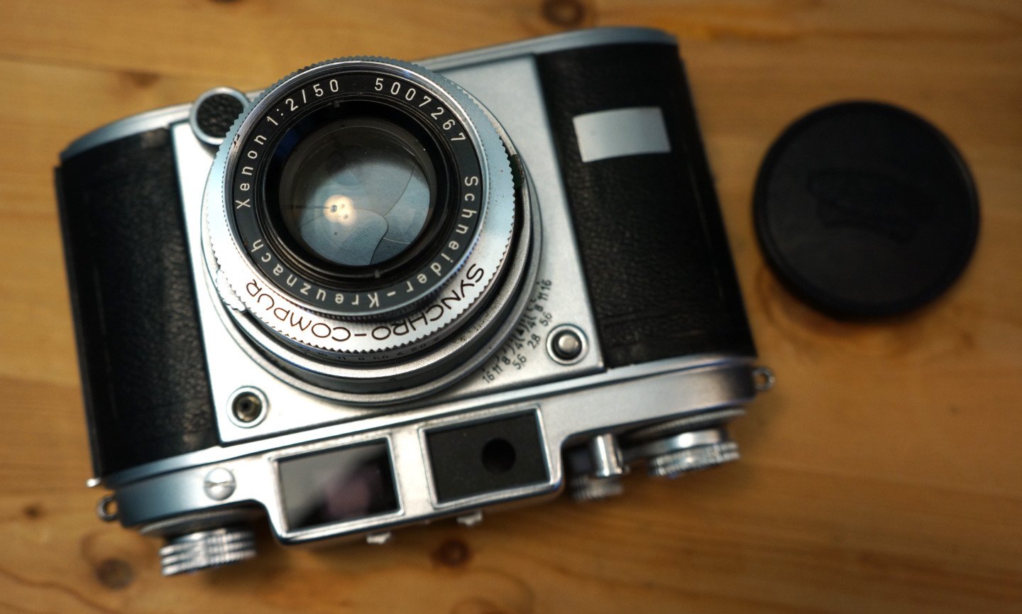

Do you mean the version with the lens that pops out? I have one of these somewhere with a Schneider Xenon (I think).
It was easy to service, although I never figured out how to disassemble the helical. I believe that I iforced some grease into it, and that worked.
I think that you remove the top deck by removing the strap lugs. I'm curious, so I'll search downstairs for it.
Re: Balda Super Baldina - Anyone work on one?
Oh yeah - I found it. It was on a different shelf.
This one does have the excellent Schneider Xenon lens. The nameplate has worn away. I had another version in better condition with a lesser lens. I don't know if I still have it.
When you push the button, the lens pops out. It "SNAPS" out with authority. I usually use my other hand to allow it to slide out with less drama.
Simply push the lens back into position, and it will stay retracted.
The lens must be extended to release the shutter.
The camera weighs 1 pound, 5 ounces (595 grams).
I serviced it but haven't used it. I wasn't able to process film at the time. Perhaps it's time to give it a roll (of film)!
