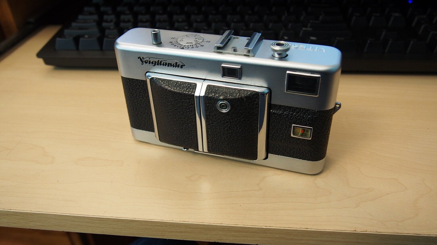

I located the third Voigtlander Vitessa.
The body is in good shape. But uh oh ...
With a pile of about 15 bins and boxes, I had no idea of where the lens was. It turns out, it's in my office in some tool containers.
This is the Color-Skopar, a very good Tessar-type four-element lens. This should be simple, but then I notice that the aperture remains wide open, and the shutter seems to be open, too.
The container holds the shutter AND aperture blades. This should be fun, I'm thinking sarcastically. Plus, there are some other parts that I no longer recognize, because it's been more than a decade.
I'm glad that I have the other Vitessas so I can use them as a reference. If you've never replaced aperture blades, it's a tremendous exercise in patience and a steady hand. Luckily, this has just five blades, instead of the 11 in older lenses.
Finally, the original owner was kind enough to scratch an ID number onto one of the barn doors in an amateur manner.
