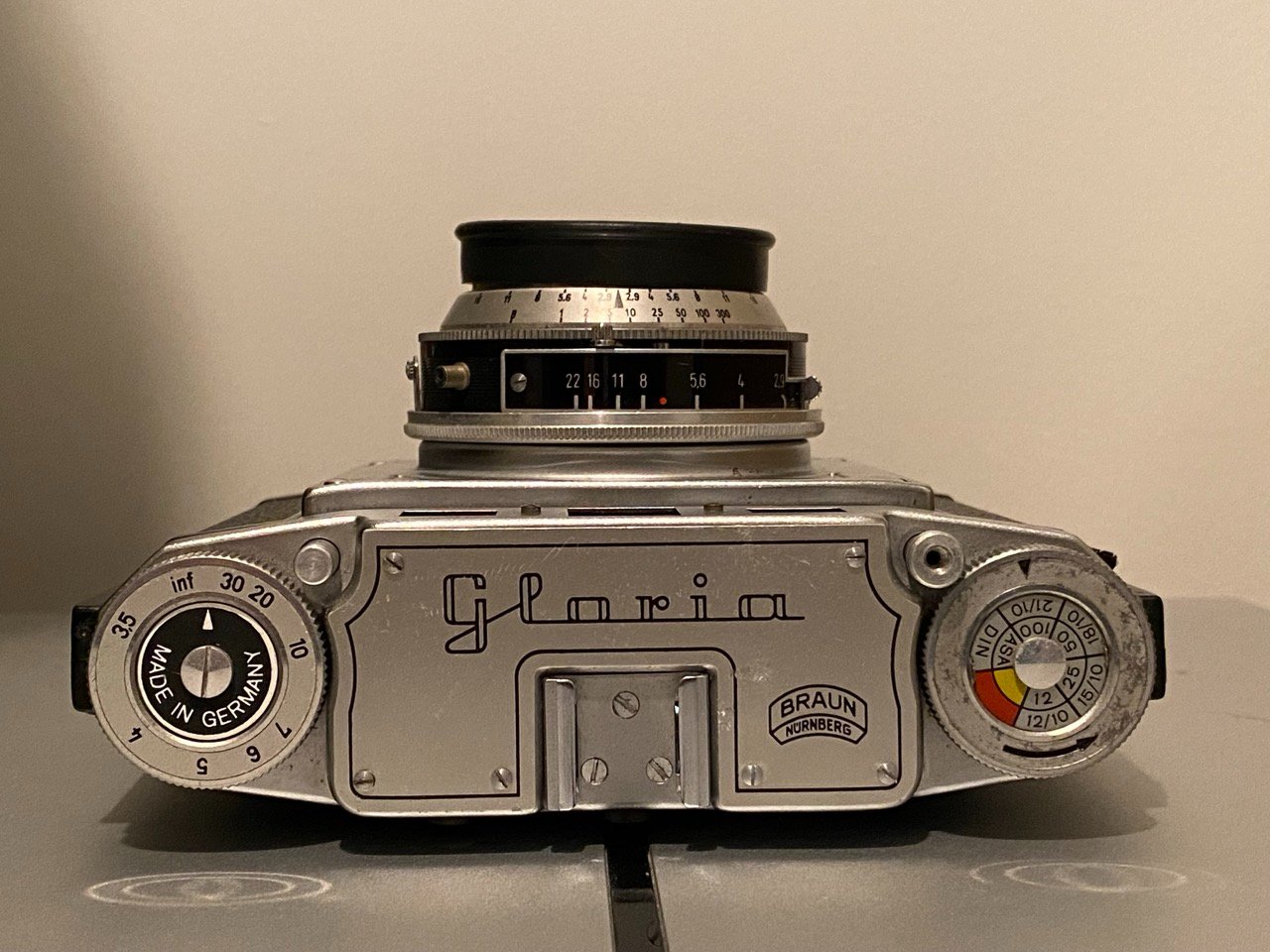

Not computer patching, but more patching of rangefinder mirrors that had lost the capacity to reflect anything.
This time round it was the Braun Gloria, a camera I bought earlier this year. I knew the RF mirror would need replacing as the seller said it was very faint.

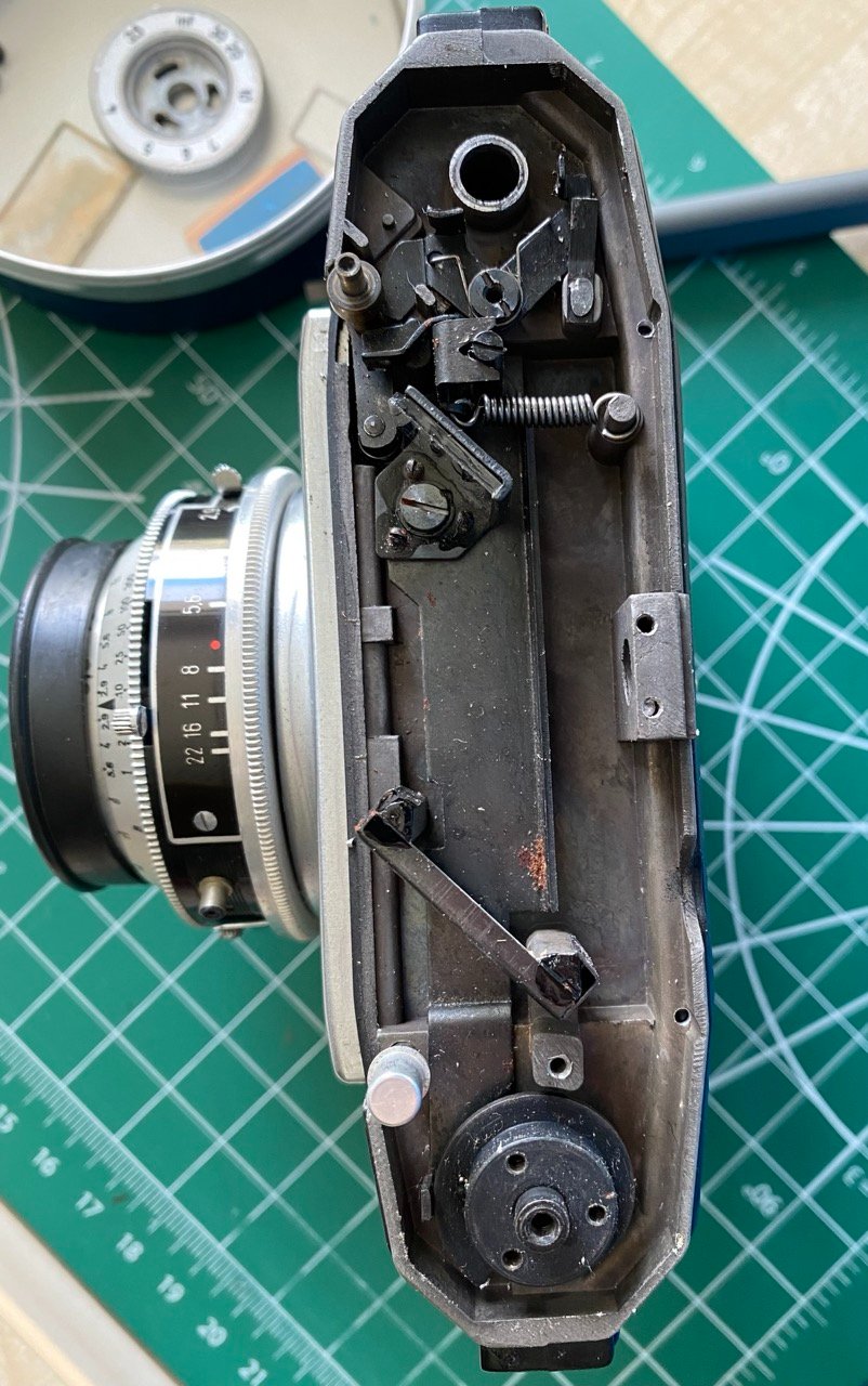

Once I'd got the top off, gently, I decided to take a few photos of the layout, just in case. As I reached for the phone, I just caught the shutter plunger and off it shot, along with at least one other piece. $#%^@!&!!. Oh, how unfortunate...
I found the shutter plunger, and a brass collar. It had a thin rim on one side, a wider rim on the other, but I couldn't work out how they fitted together. I tried a few options, nothing seemed to fit properly. The hole in the collar didn't fit the shutter release shaft size (hole too large), and I couldn't be certain the two parts even belonged together.
Oh well, on to fixing the RF mirror. The mirror is held in a carrier that slips over two posts (the larger, lower half silvered mirror in the preceding photo). A gentle pry with the handle side of the tweezers and up it popped, having first removed the lacquer on the top. It took a couple of goes to cut an appropriately sized mirror, but some lacquer to hold in the mirror, then slipping the carrier over the posts and it all seemed good. Now I just have to work out the shutter release mechanism.
I studied the top for a while, and there appeared nowhere else the collar could go, apart from in some combination with the shutter release. None of the combinations I tried worked, I couldn't get the shutter interlock to work properly. It would only work if I held the shutter release down while winding, and then only as long as I kept it gently depressed. Being a little depressed myself, I put it to one side.
While doing something else, I dropped something unrelated on the floor. Searching for that unrelated thing, I found a spring acting suspiciously under my desk. Under interrogation, it admitted it had indeed made a bid for freedom together with the shutter release and collar. It had good camouflage, so I only found it through feel. It admitted being part of the gang, but wasn't going to give up any more information. So, I tried some more combinations of shutter release, collar and spring before working out their relationship.

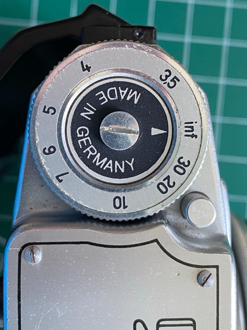

Finally, it all clicked <ahem>! Then just a matter of a bit of a clean, then reassembly and adjusting the RF. The uncoupled RF can be adjusted with the three screws on the RF wheel:
