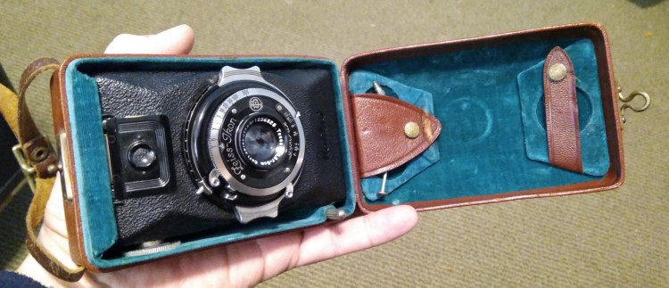

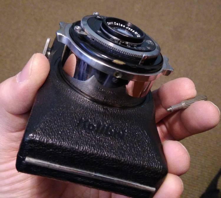

Regarding the Zeiss Ikon Kolibri, this came in two versions. You have the premium version with the Tessar and Compur lens. The lower-cost camera had a Klio shutter (I think) and a Novar lens.

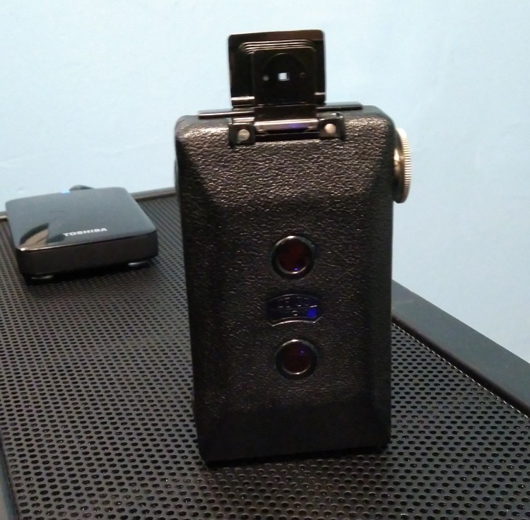

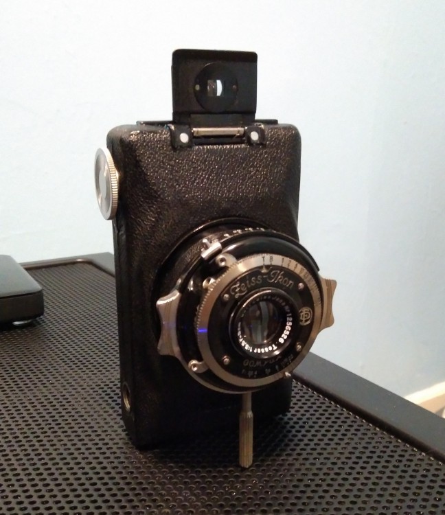

The Tessar on this camera is quite sharp. After I restored my Kolibri, I found that it is a bit awkward to hold when taking photos.
Portraits are taken with the camera held horizontally and landscapes with the camera held vertically. It's opposite of what you would expect.

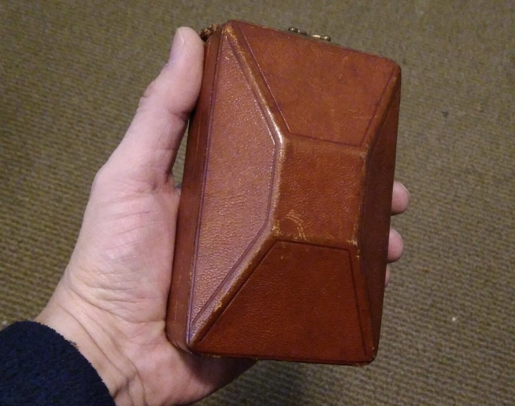

There also is a small post that screws into the shutter so that the camera can stand upright. There also was a very short cable release to help take photos. It all stored nicely in a fitted brown case, which had room for three filters. I don't have those although I believe they are standard 27mm thread (not 100% sure about the filter size - might be 25.5mm).
Sorry for the crappy mobile phone photos. It doesn't have a Zeiss lens. :)

Ohhh beatiful camera you have there Mike!! Yes the lens is goo enough and also yes the short cable release helps a lot.
Now I saw a Voigtlander Perkeo 3x4 and I want to get one for myself, same knob style as my Inos II. The Kolibri is from my friend and now that it's restored I want to publish the service and what I discovered about Compur shutters, every shutter something shows up :)
