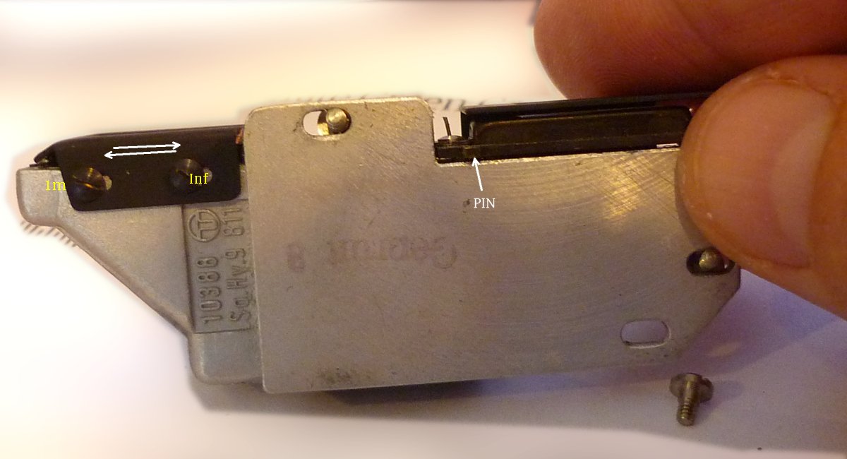

The RF unit was taken out to clean and lubricate the film transport/winding mechanism and is held by 3 screws (marked in yellow)

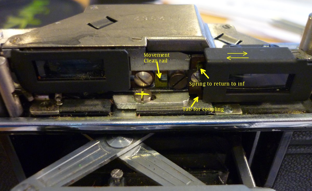

I looked at the unit and it was focused at infinity by default, and has a small pin/tab at the bottom that moves one of the sided for close focusing, and a spring returns it to infinity. Mine was sluggish to return and I cleaned the rail with a qtip moist in electrical contact cleaner (green Agfa goo).
When focusing a lever moves and pushes the pin, so after assembling I left the screws loose, and moved the RF unit horizontally (L-R) I got infinity right. Confirmed with 2m(6ft) and 5m(15ft) looking at a bookcase.

I didn't touch the unit itself, it was self contained
I looked through it and it was well focused to infinity, so that was a win
Then I tried to figure out how it worked and how it coupled, and from there it was clear that this adjustment wasn't too bad.
Alex gave me some pointers on how to clean the mechanism, and suggested to lubricate it with graphite
I was thinking on using a drop of blue threadlock in those holding screws but the amount of force exerted by the RF coupling is minimal
If this was out of whack I think you can adjust infinity by the screw on top of the one marked with the yellow +
Vertical adjustment would be a bear though

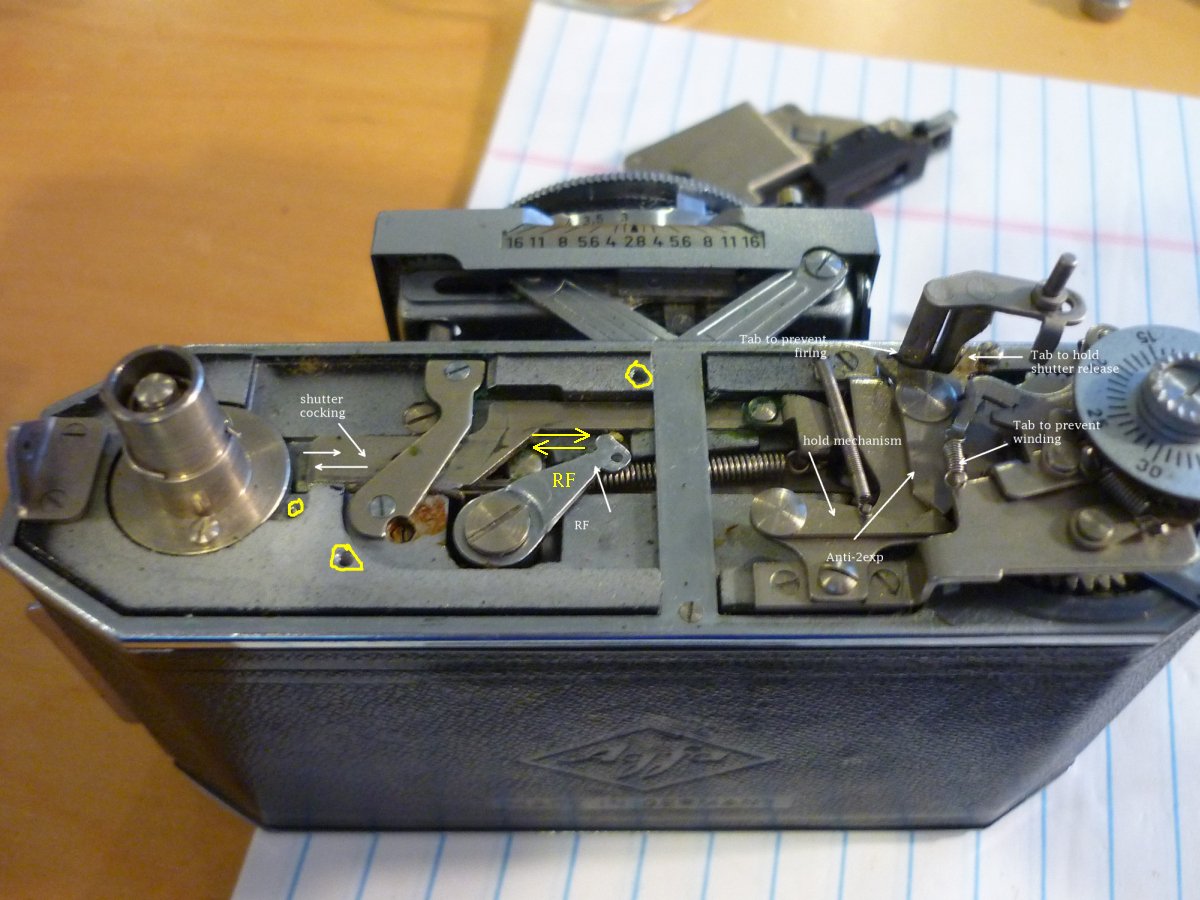

While working on a Karomat I made the mistake of removing the big brass screw that holds the RF-lever
It can come lose over time, so remember to add threadlocker to it during reassembly
I added some notes to supplement PFM pictures
