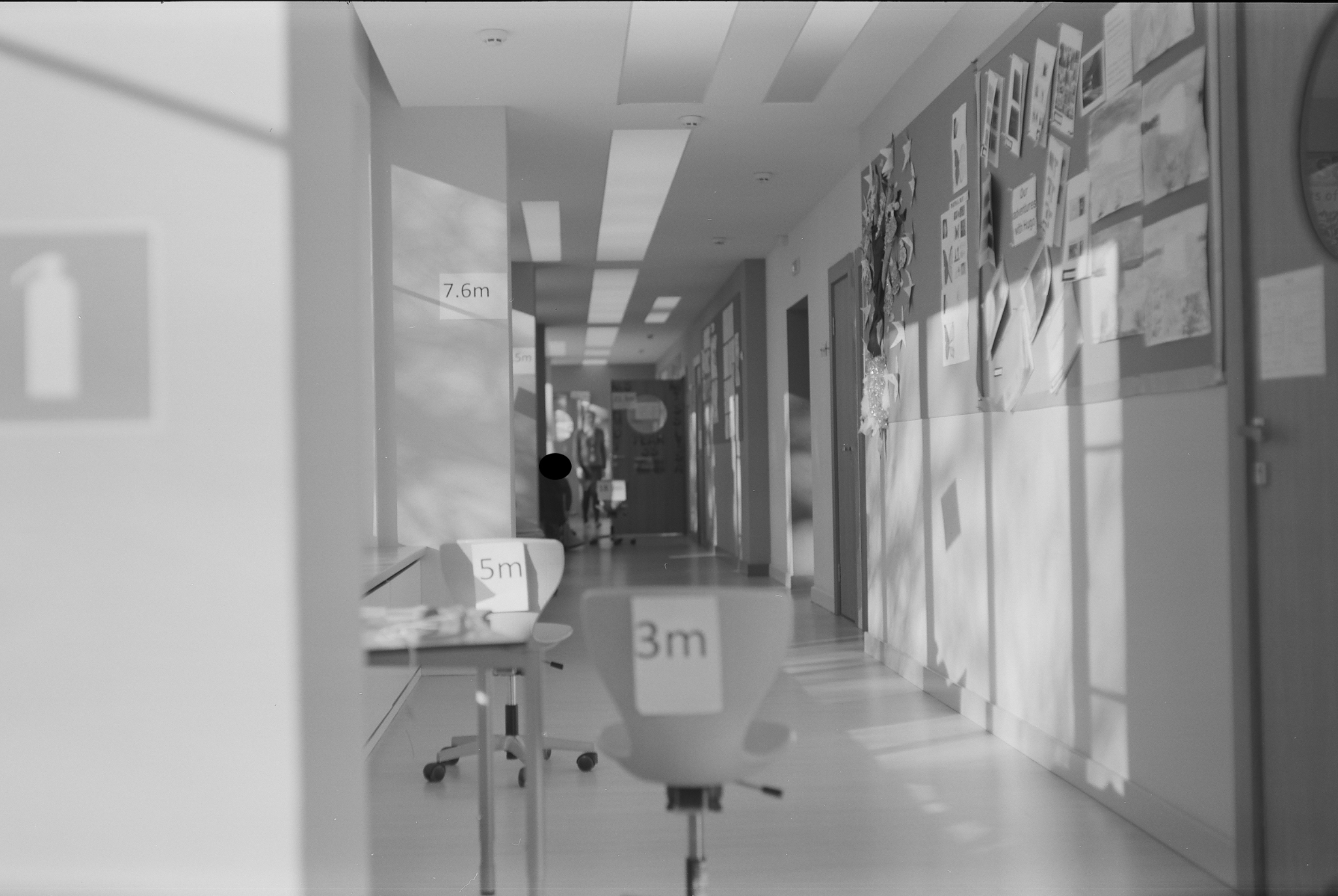

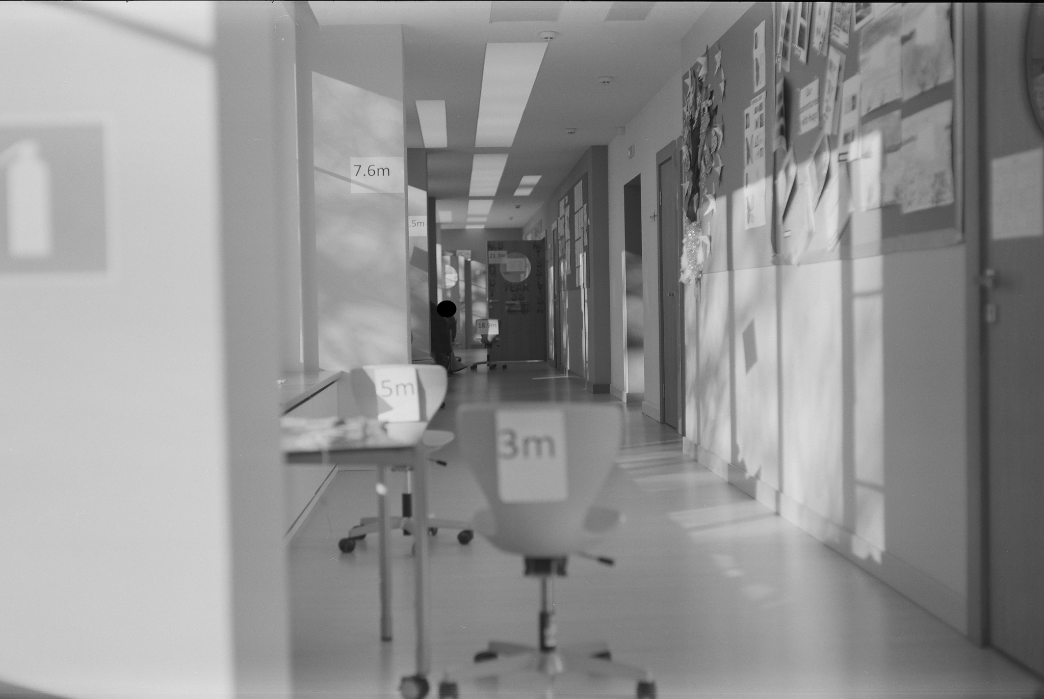

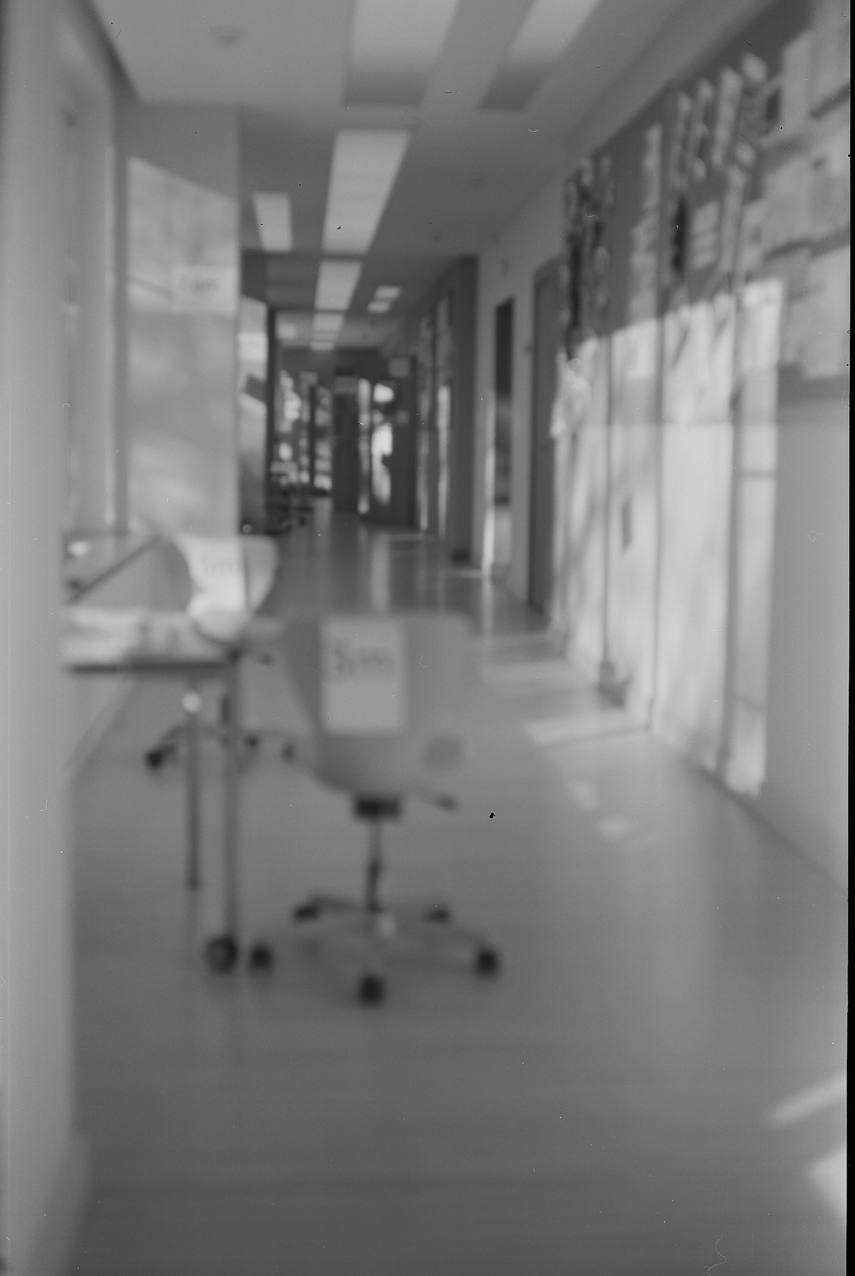

New test roll, I put some marks along the corridor with laser measure distances, with each shot I wrote down the setting on the camera's dial.
The collimation I tried with the digital camera said at 8 metres in the dial, inf is becoming sharp.
Film Delta 400 pull 1, 100 at f3.5 (I wanted maximum DOF)
Distances in the corridor are: 27.7, 21.3, 18.9, 13.5, 7.6, 5 and 3 metres. See A4 papers with numbers.

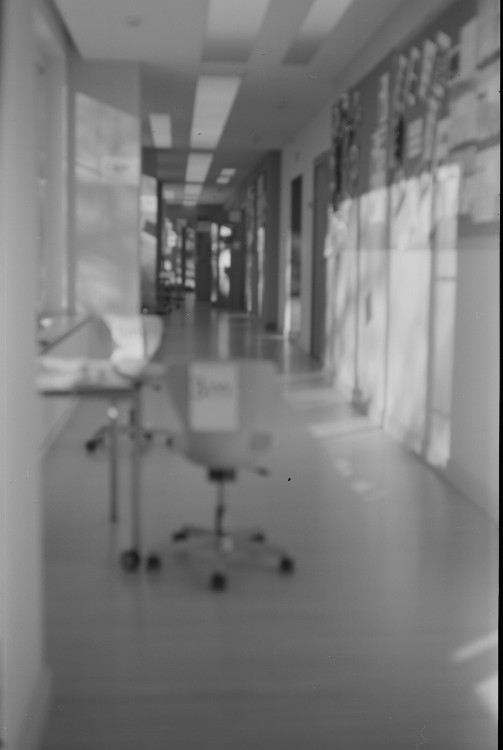

Dial at inf, we know the results

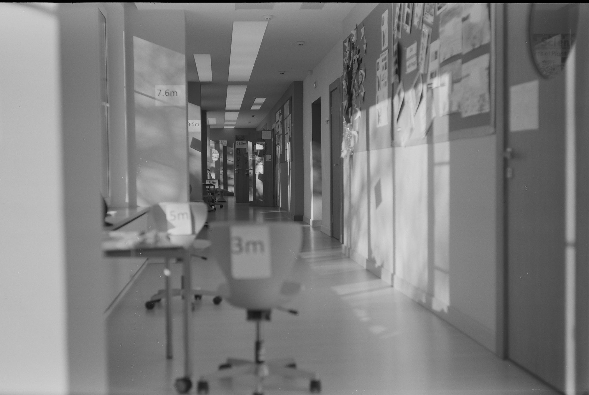

Dial at 8 metres
Dial at 7 metres

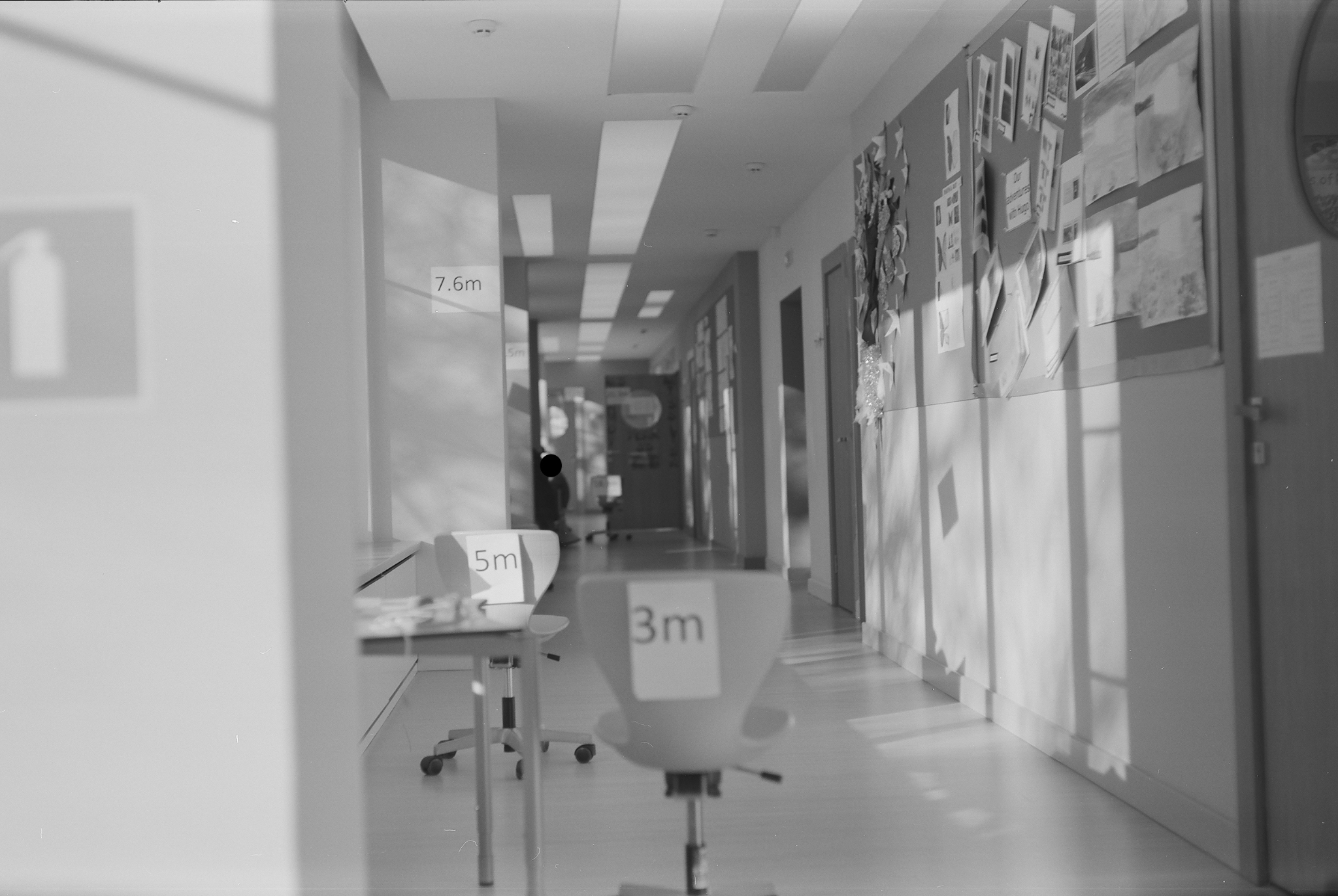

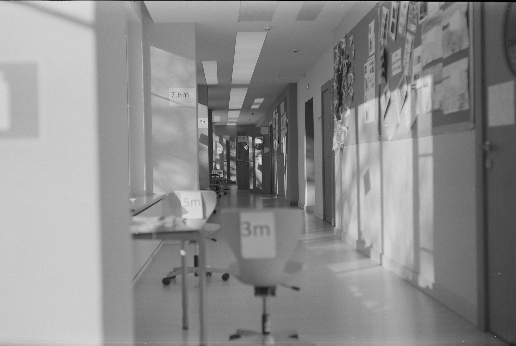

Dial at 6 metres
Dial at 5 metres

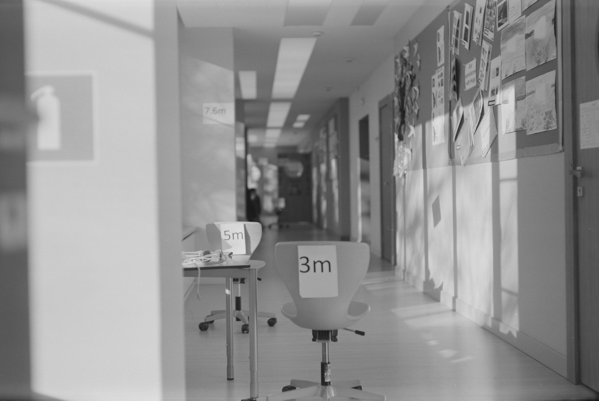

Dial at 4 metres

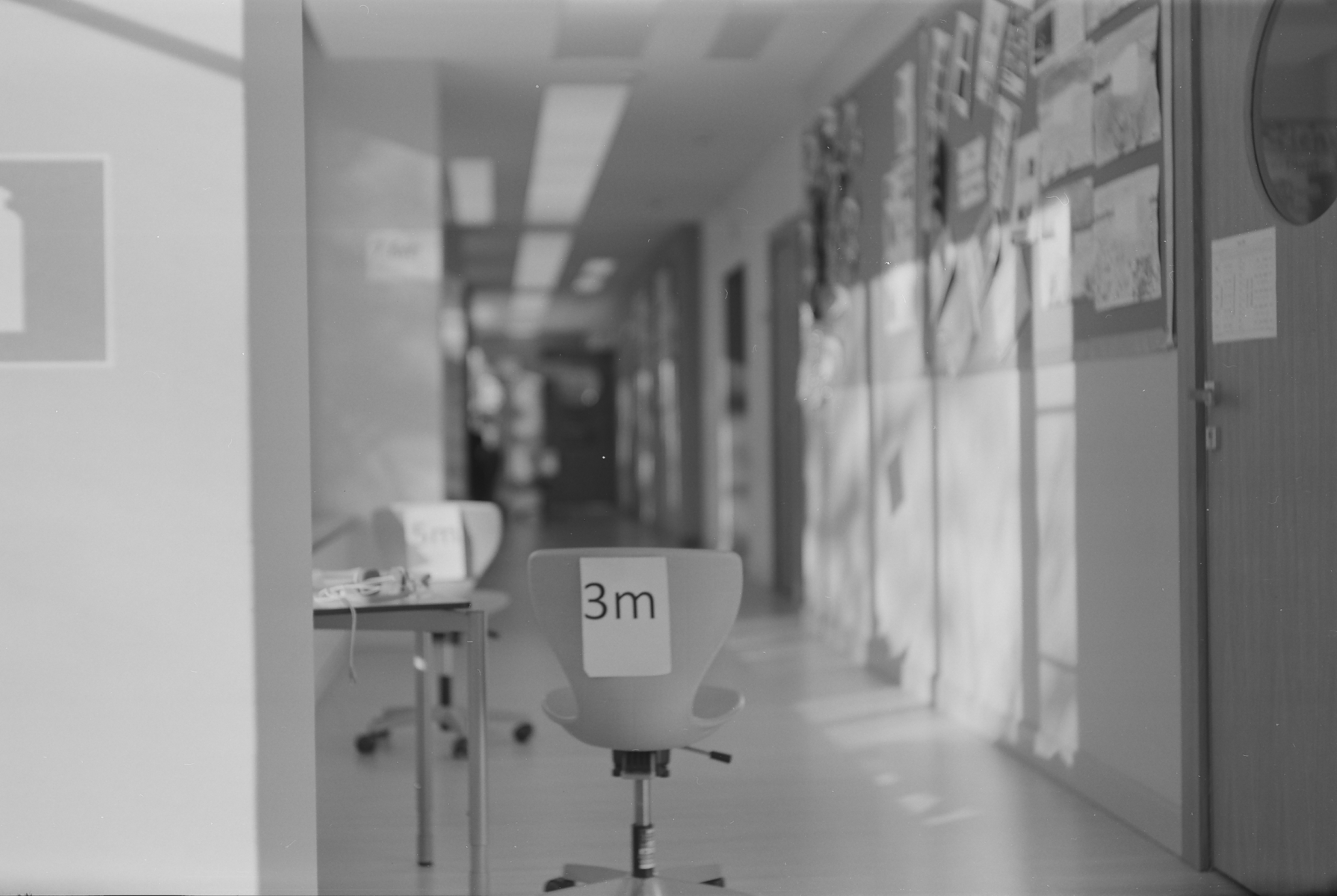

Dial at 3 metres
Dial at 2 metres
So, it seems that around 8m at cameras dial everything start to be focused and sharp at inf and for me the camera now its consistent, I mean "it works" but the lens its not in place.
How the lens could go to this position? My guess is someone opened it and put it back not very well.
