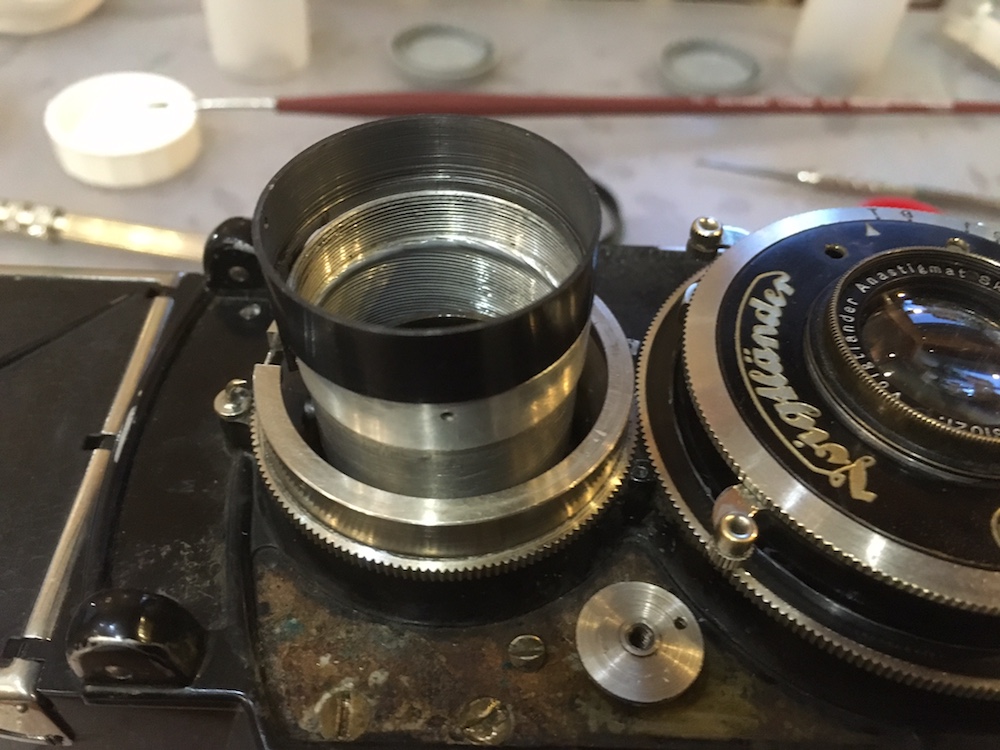

Now both lenses and shutter out, I had no idea how to take out the shutter, Im used to folding cameras so I tried what I know...
It seems I took out the rear lens, shutter remained.
Could be from here?
Wait! There is an helicoid and the focus is done by group, not only front lens. So I remembered how to take out the shutter from the helicoid with the Pearl III, it should be an screw somewhere, and here it was, below the focusing handle. This screw has two meanings, firstly not allowing to take out the shutter completely from the helicoid, this is minimum focus distance and to the other side another stop that is infinite and resting position.
Shutter and taking lens coming out.
Focusing wheel, super dirty.
After some cleaning. That vertical "monolith" keeps the shutter vertical and not spinning along the helicoid while focusing, so it goes in and out for focusing purposes.
Taking out viewing lens...
Three marks already! wow!
This is how the lens is taken out, focusing you move this knob which the viewing lens is attached and the movement thanks to another helicoid take the lens in and out for focusing purposes.
How the external aperture wheel is connected to the inside of the shutter.
And moves this...
Ok, now everything is out, cleaned and ready to be assembled again.

Next is to collimate viewing lens, the guide ring.
The holder.
And the lens, this is the first to do now, without the guide, need to find the correct helicoid thread to make coincidence "infinite focus through the normal procedure" without moving the focusing ring AND one the three marks of the viewing lens we saw before.
Coincidence made!
At this point I though I got it, assembled everything and the day after I checked again and the collimate of the viewing lens was not correct, again to to this part, 4 tries later I got all in place, I did some close focusing and the reading taken from the Superb and my DSLR were pretty close.
