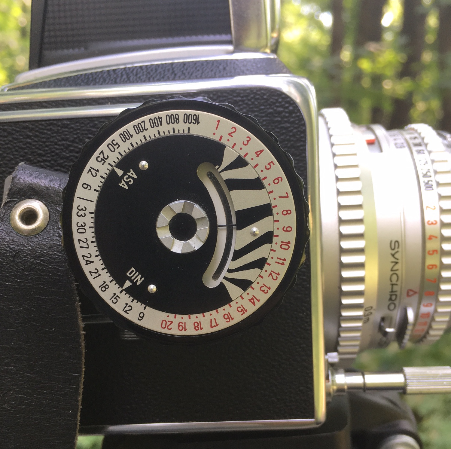

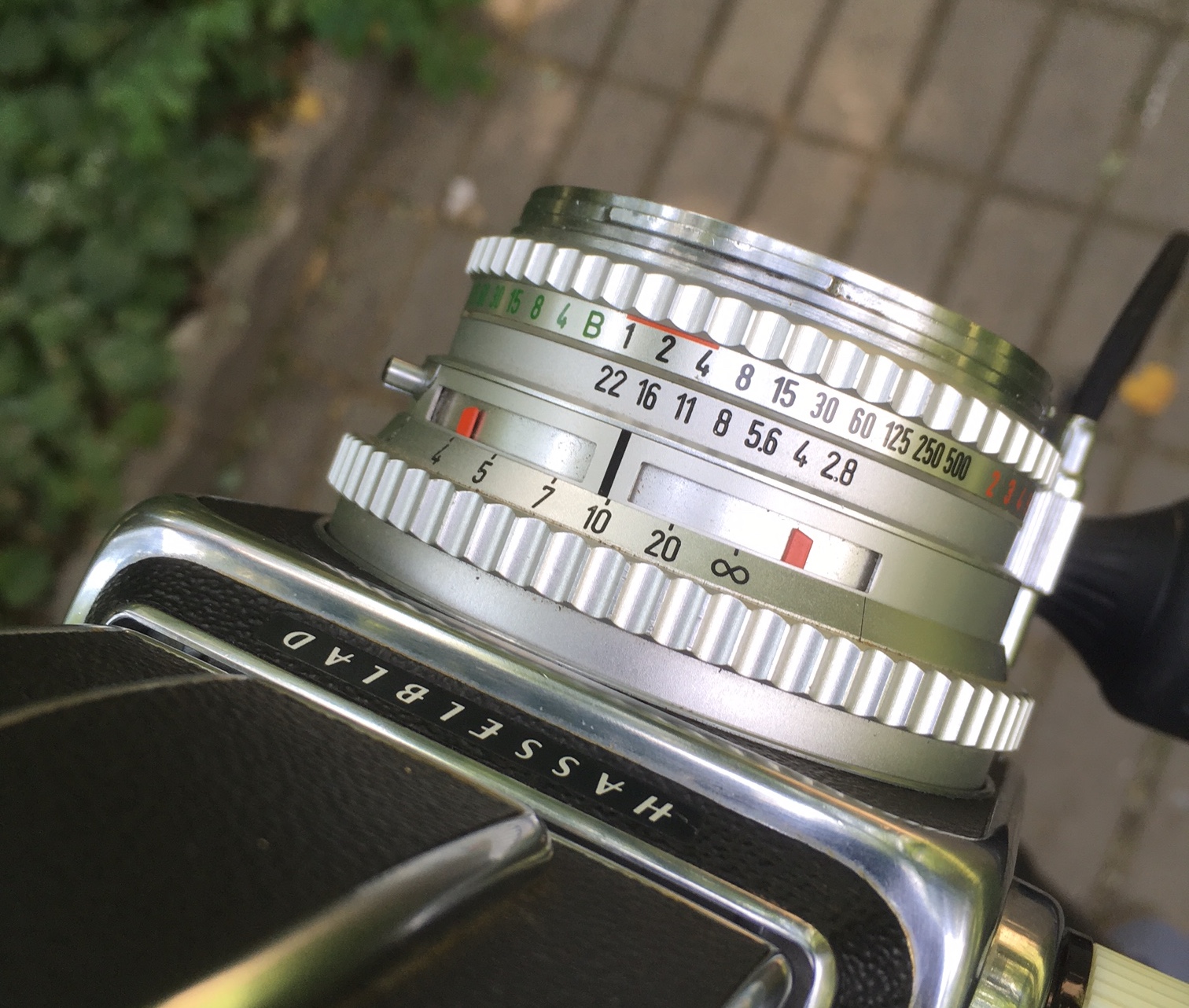

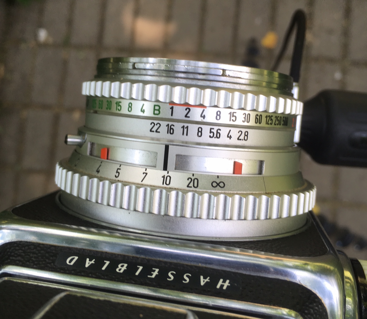

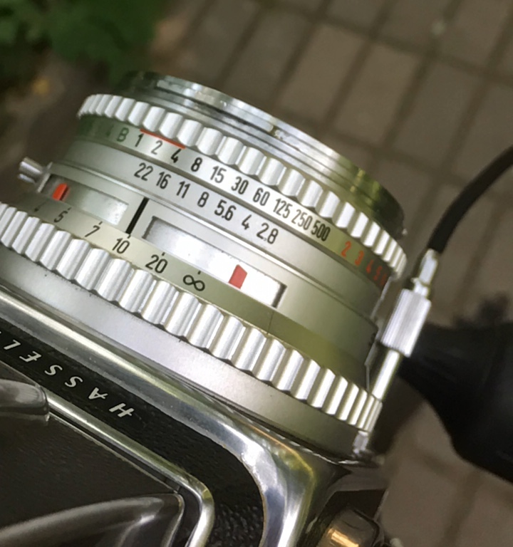

I did the test of this film, here are the settings:
I used ASA 25. The meter is accurate, incident light.
And started to shoot from what the meter said.
And start going up one speed at a time.
I post no more since they become already dark.
I think the two rolls like this I have I should use ASA 50 and use incident light metering, any suggestions?
Thank you in advance.
