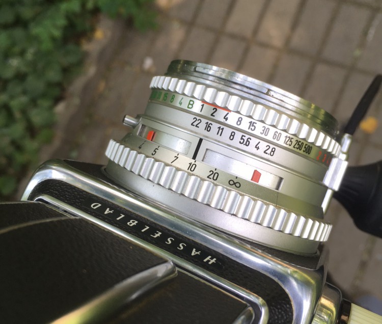

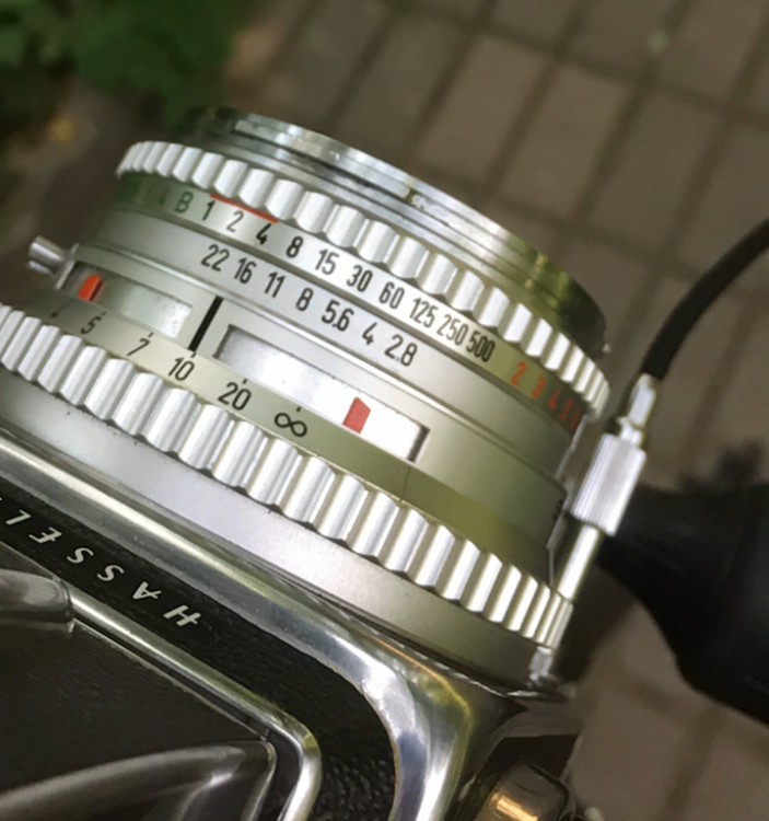

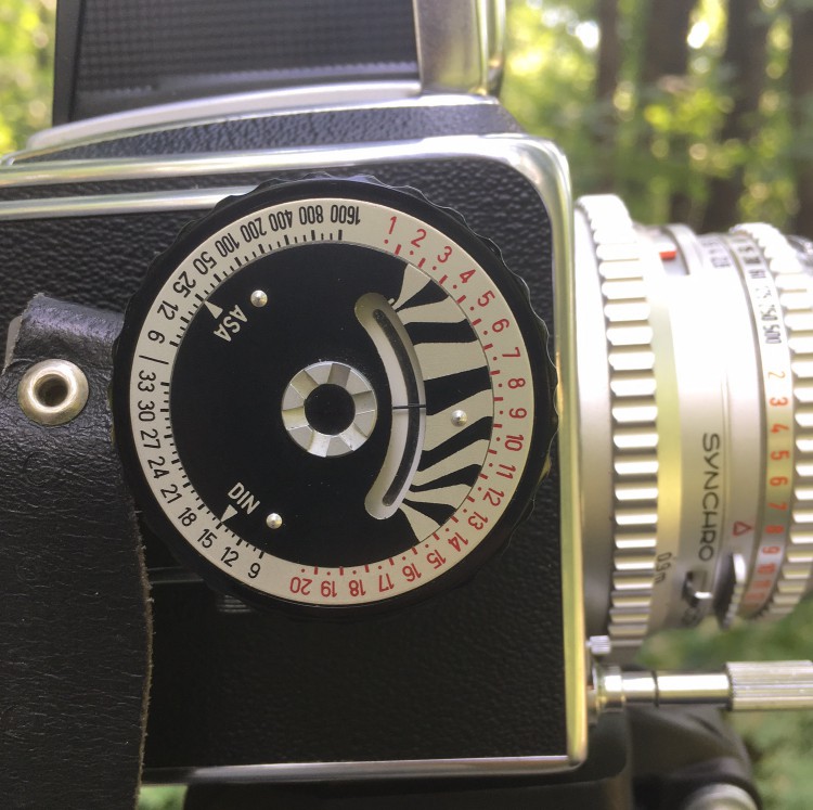

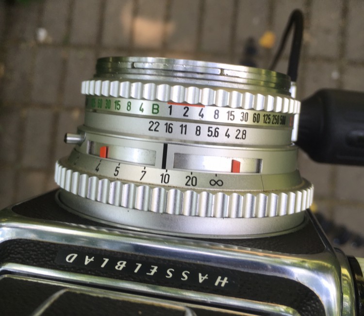

I did the test of this film, here are the settings:
I used ASA 25. The meter is accurate, incident light.
And started to shoot from what the meter said.
And start going up one speed at a time.
I post no more since they become already dark.
I think the two rolls like this I have I should use ASA 50 and use incident light metering, any suggestions?
Thank you in advance.

I said 1/2 sec @f16 due the histogram, more complete, I agree the 1/4 @f16 fits better with what I remember of that scene.
So if 1/4 @f16 correcting to f8 speed should be 1/15. Anyway its two stops more open that the meter said, if I rest one stop due the age still would be one more stop that meter said.
I will test the meter again with the different options I have around to see what happened.
Thanks for the tips
