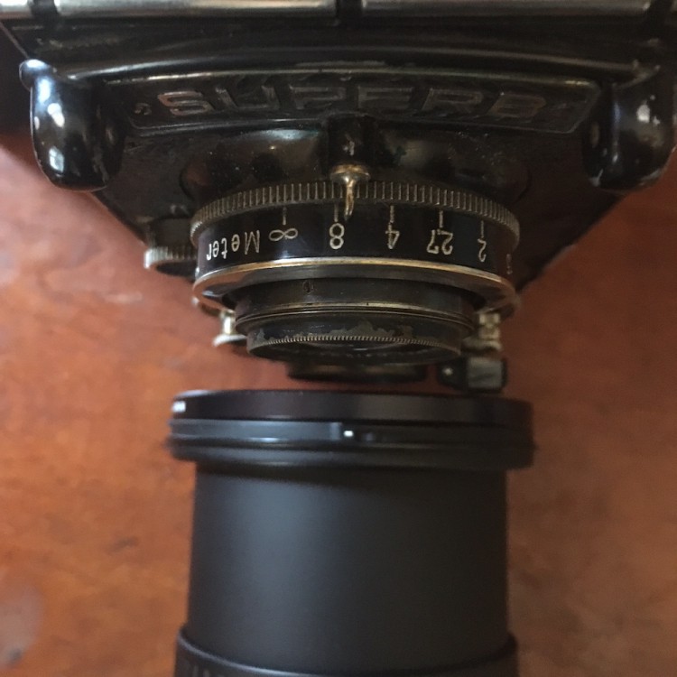

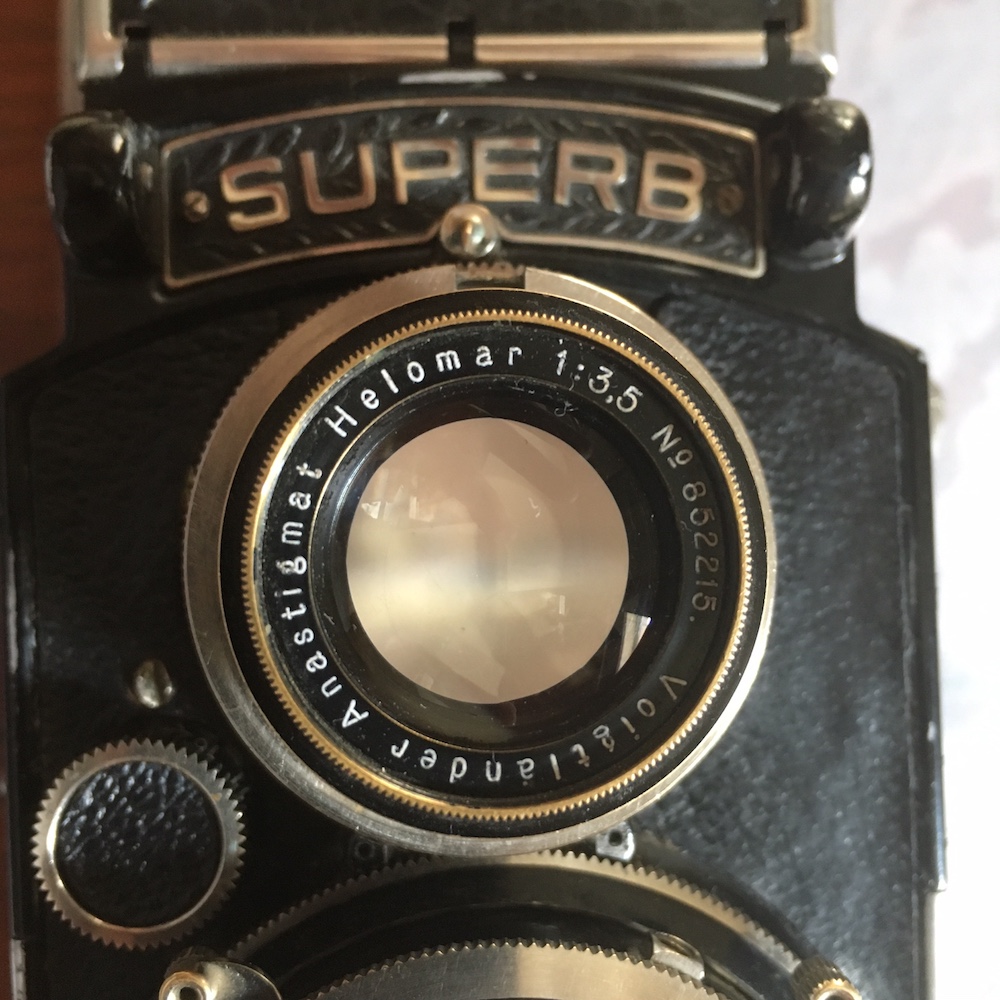

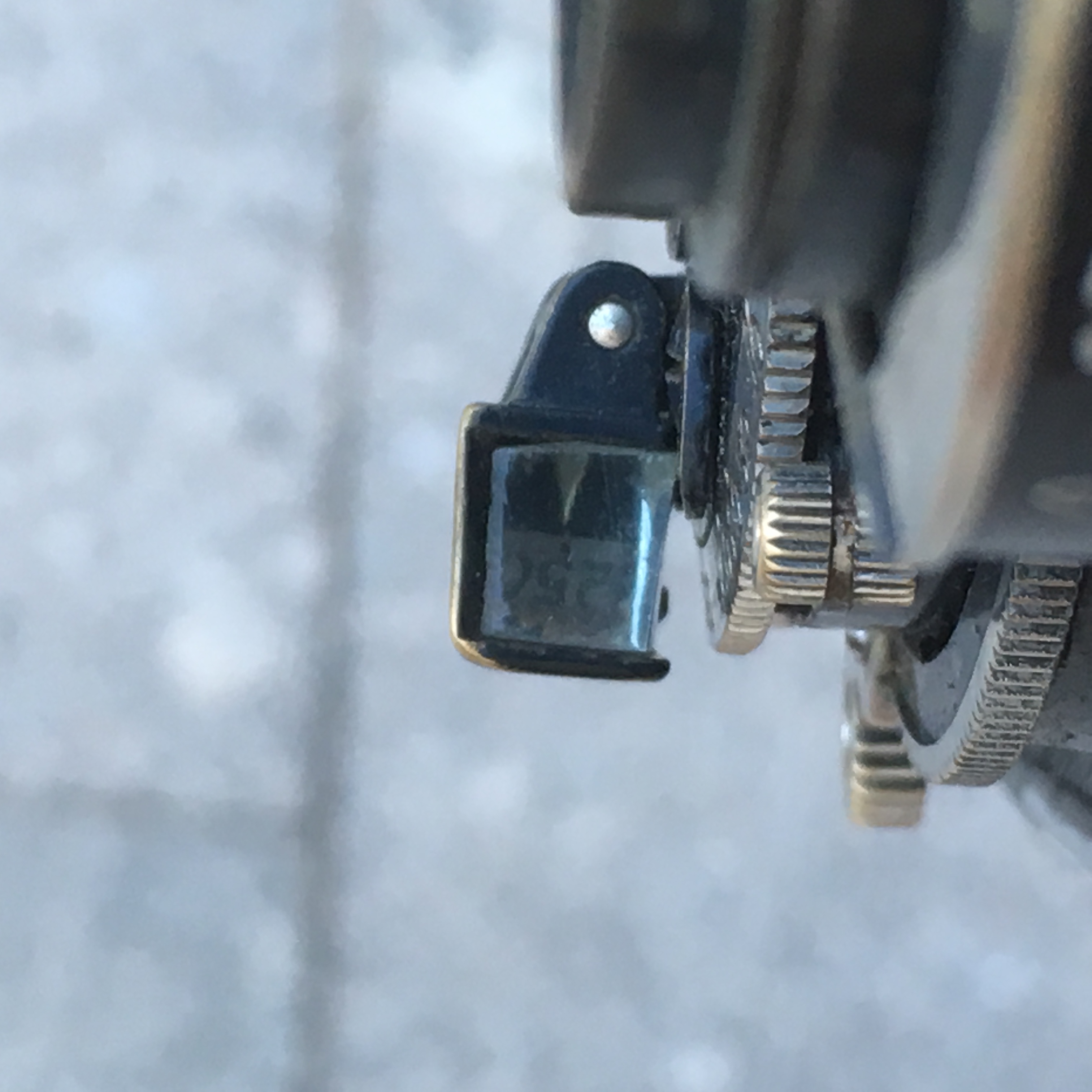

Because with TLR we look down and some clever guy found out this would be cool to add:)Philip wrote:Nice camera. Good luck with it.
One thing puzzles me -- why are the numbers and letters on the shutter speed ring backwards?

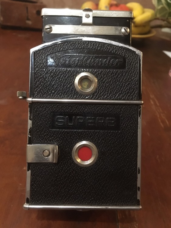

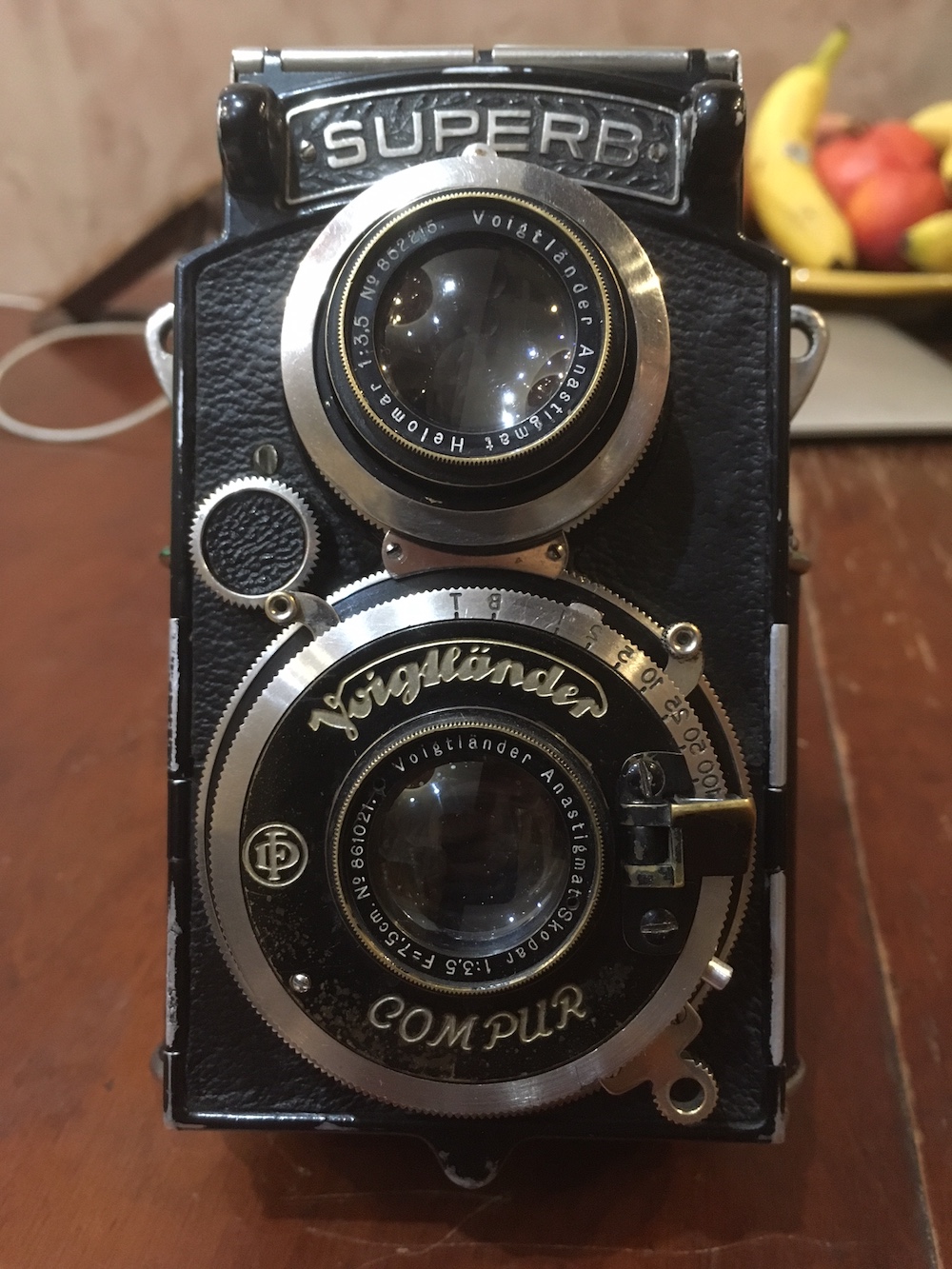

Voigtlander Superb Model I - Skopar
Ohhh, verry clever!

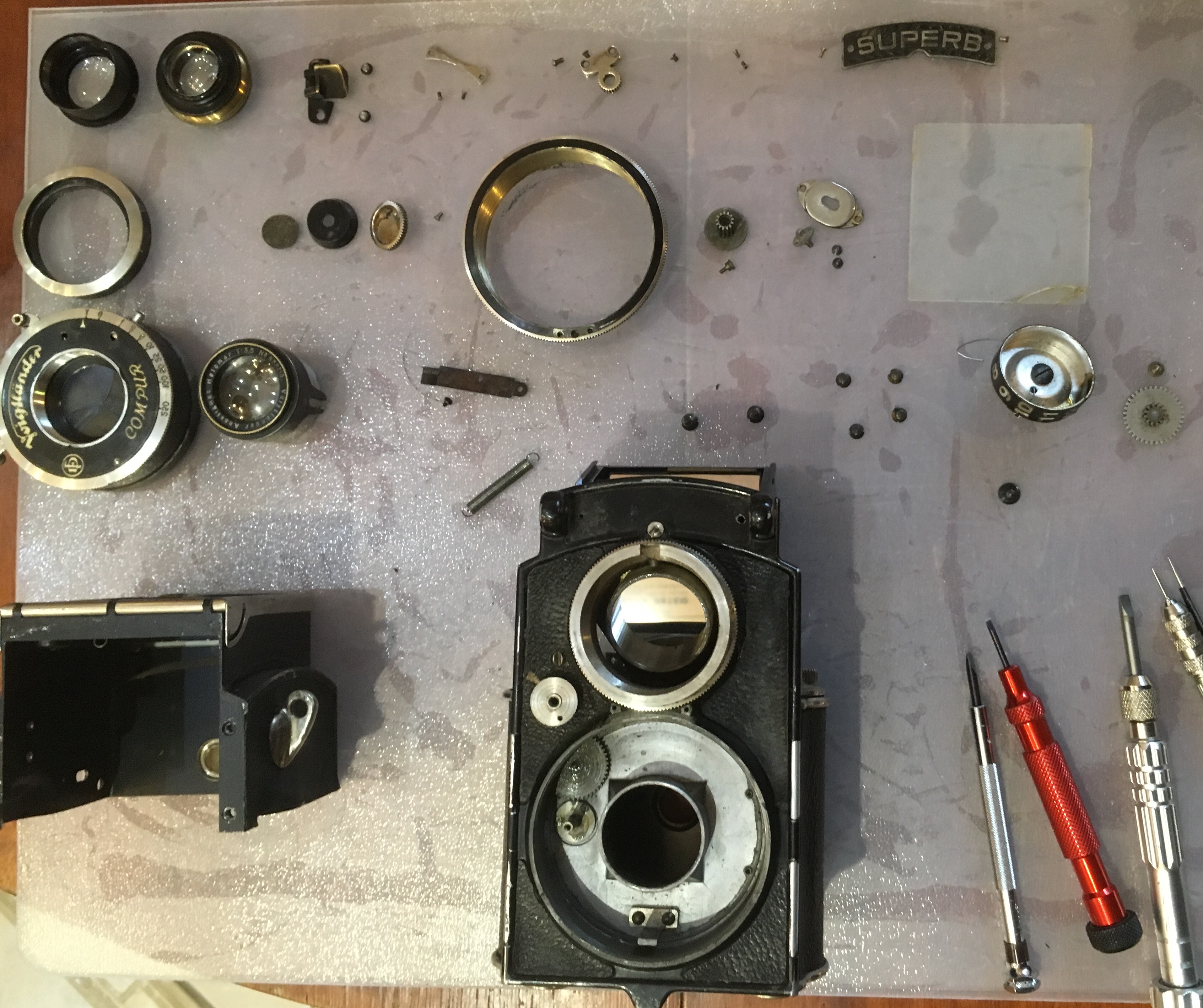

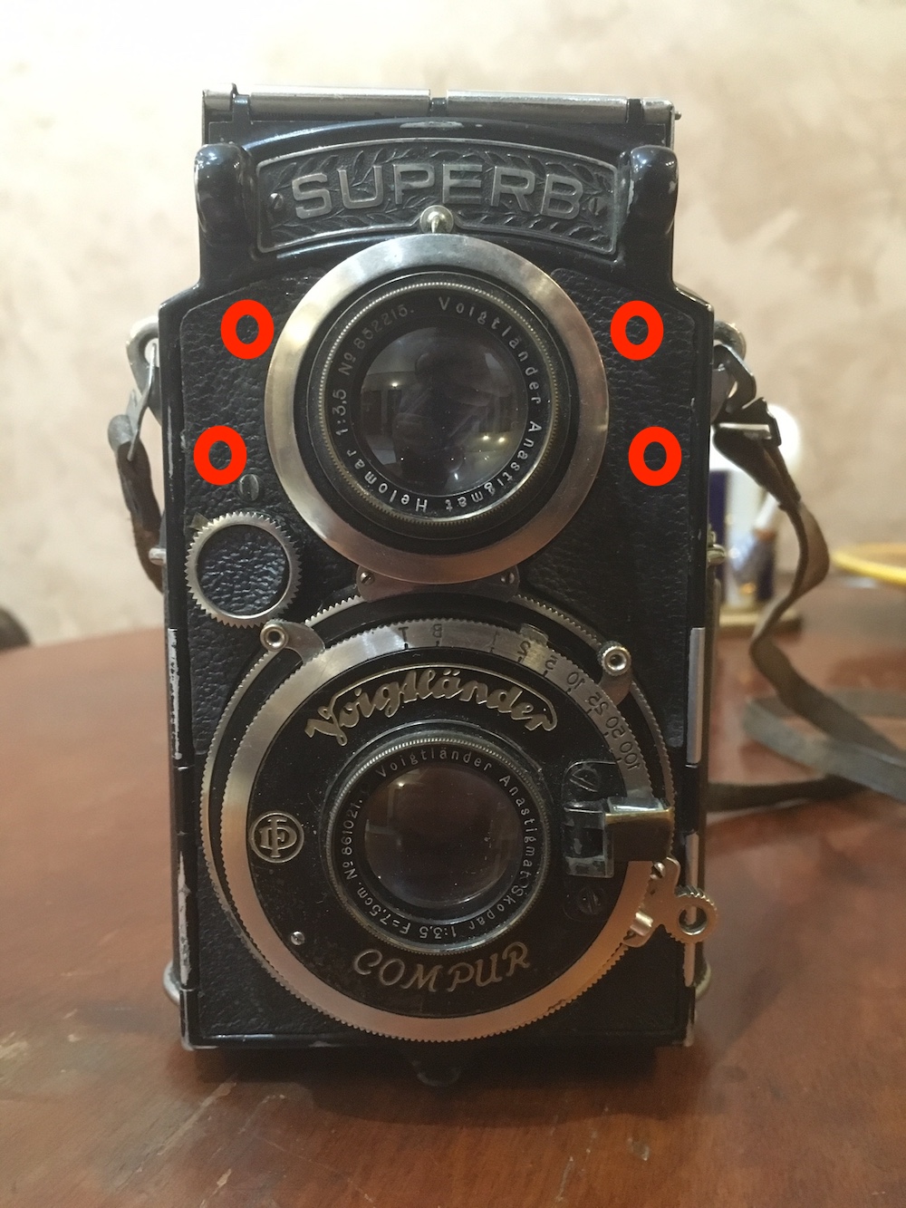

Let's go, step one, how to access the mirror, ground glass, counter mechanism, parallax and aperture wheels.

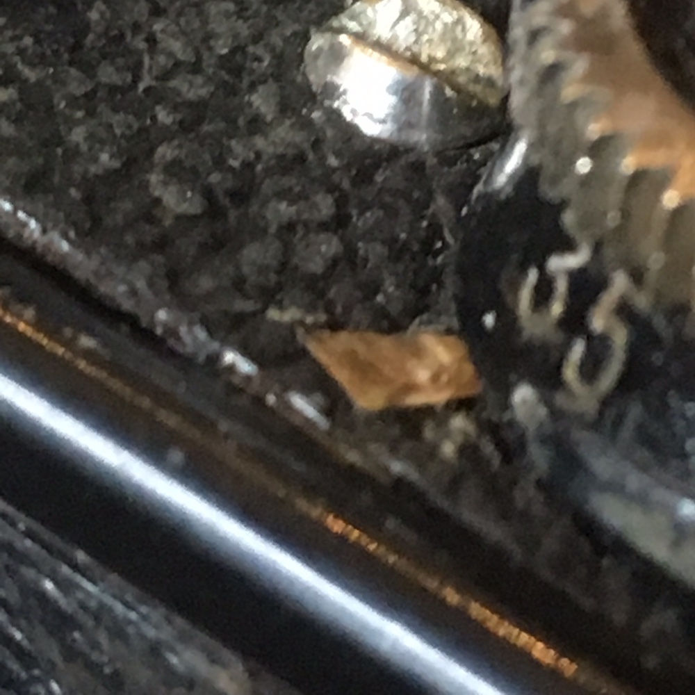

Some hidden screws, carefully skin the leatherette injecting small portions of Isopropanol to access those screws. Here it could be wise to remove the film counter reset leveller before. Thank you "josulgerman" from photodotnet to upload how to remove the upper case.
Now I went absolutely with no guide from now, I asked 3 guys from flicker who own/owned this camera but or they sold it or had no info about it.

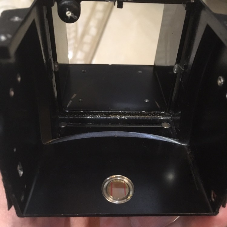

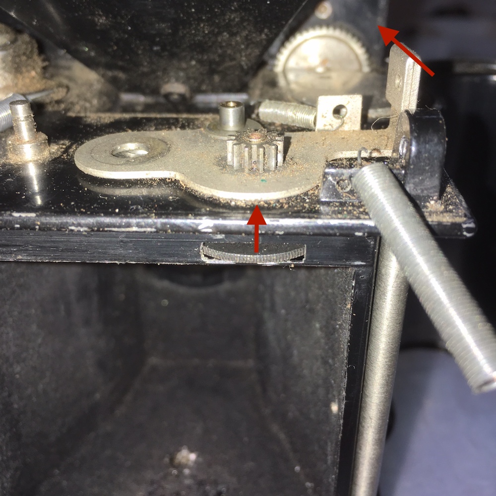

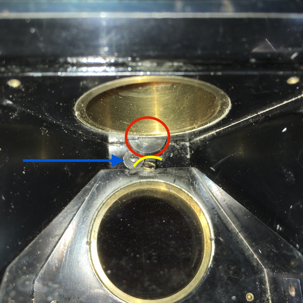

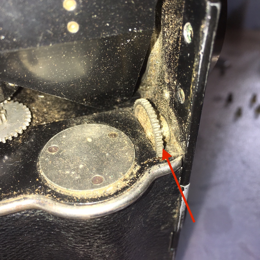

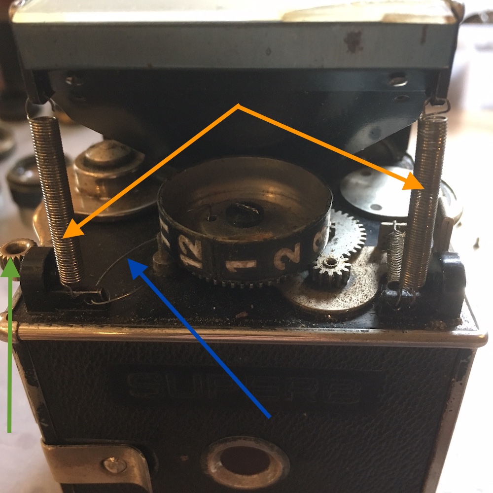

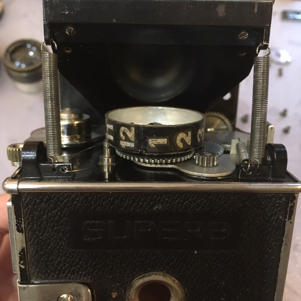

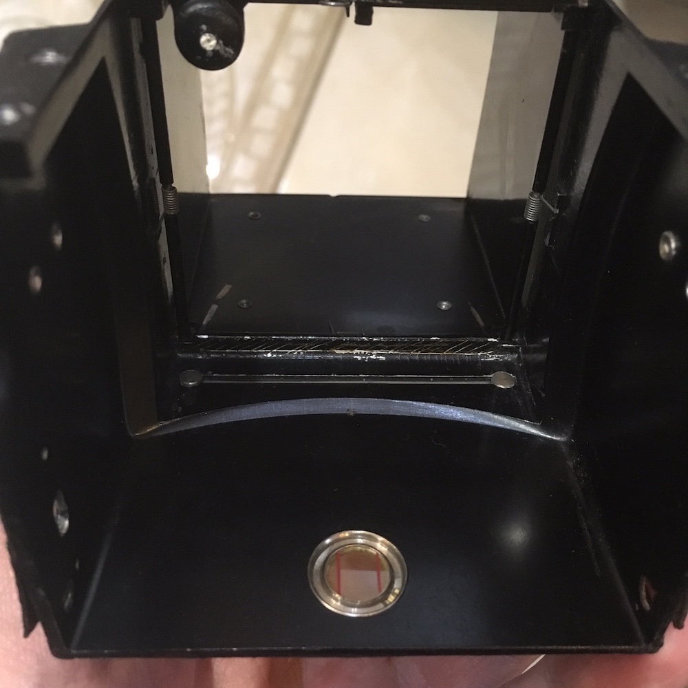

After removing the upper case this is found, wind leveller, springs pulling from the ground glass+mirror for the parallax correction and a flimsy spring that barely could reset the frame counter. Pulling that thing to the right you reset the frame counter to 1, I had to pull it 2-3 times to make the spring work. Attention to that wheel in the film chamber, its triggered by the film being advance and making the frame counter go to the next number, pulling right the external leveller makes this wheel go inside so the "flimsy" spring will take the counter to 1.

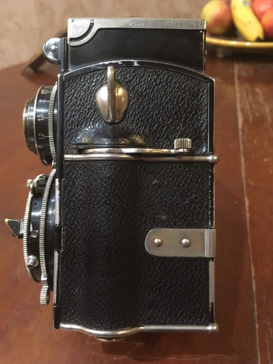

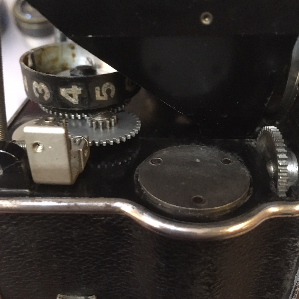

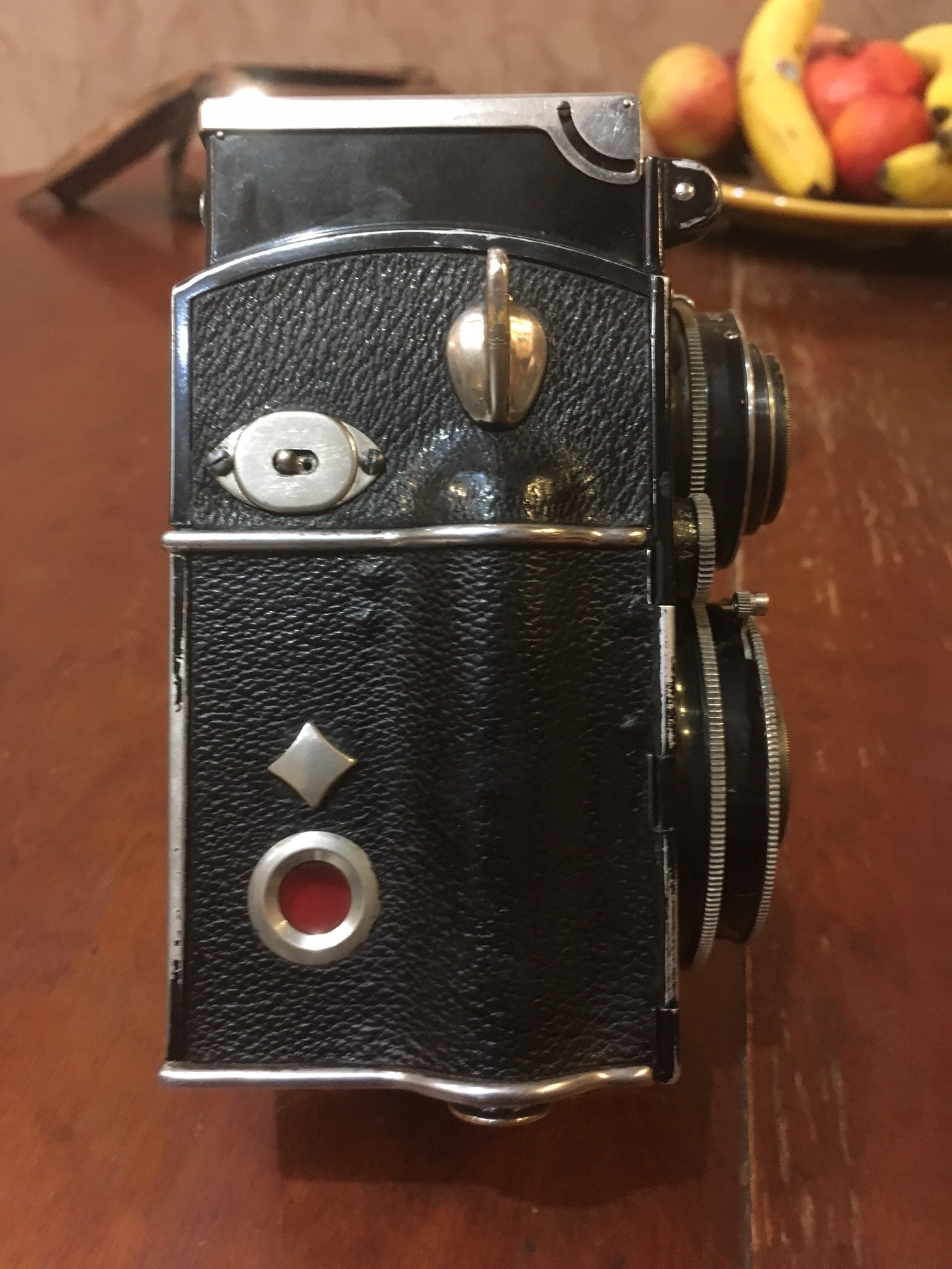

There is no automatic mechanism to stop you every frame, the red window is still the best way to place your next frame, the wind leveller can be moved till the end of the swing or wherever you need. If you use the leather ready case you still have a visual of both numbers (counter and red one), it could be useful in dark conditions. Dent wheel connected to the external aperture ring. A lot to discuss here but later.
Camera was a bit dusty inside. Eccentric ring connected to the viewing lens for the parallax correction, that small circular metal turning part can be adjusted for more distance from the mirror. So if the viewing lens is "marking" from 1 to 4 metres the viewing lens goes out and down forcing the parallax correction. From the mirror, parallax can be adjusted from unscrewing and moving it to the right taking the wheel to even more ahead producing greater parallax corrections. Now all clean, film counter spring is no longer flimsy and in one strike can take the counter back to 1. To be continued...

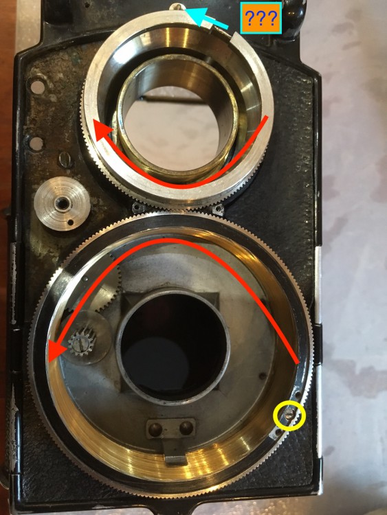

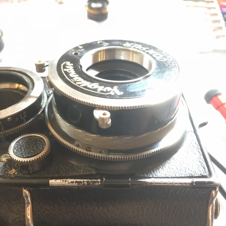

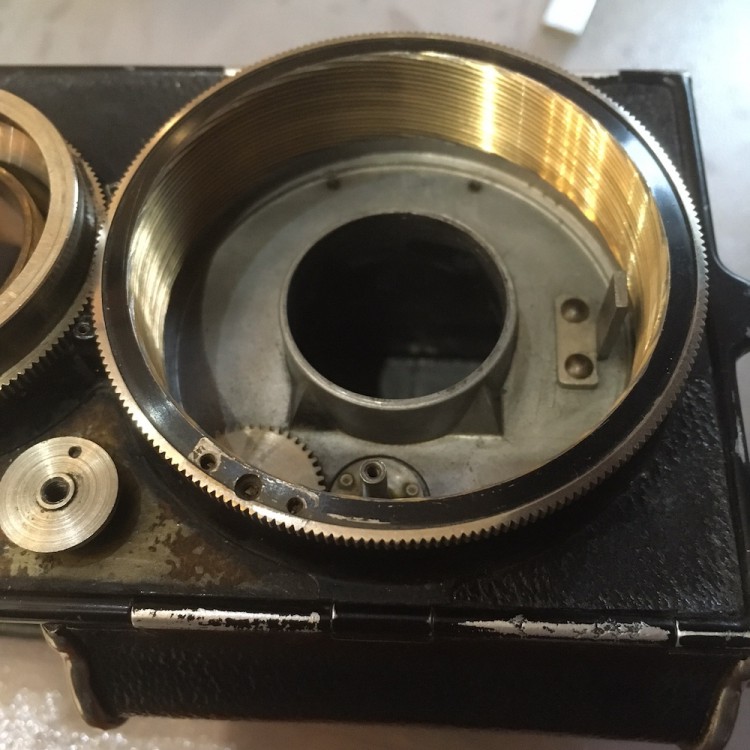

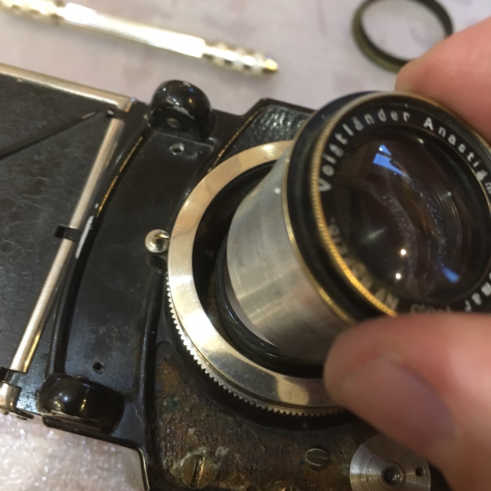

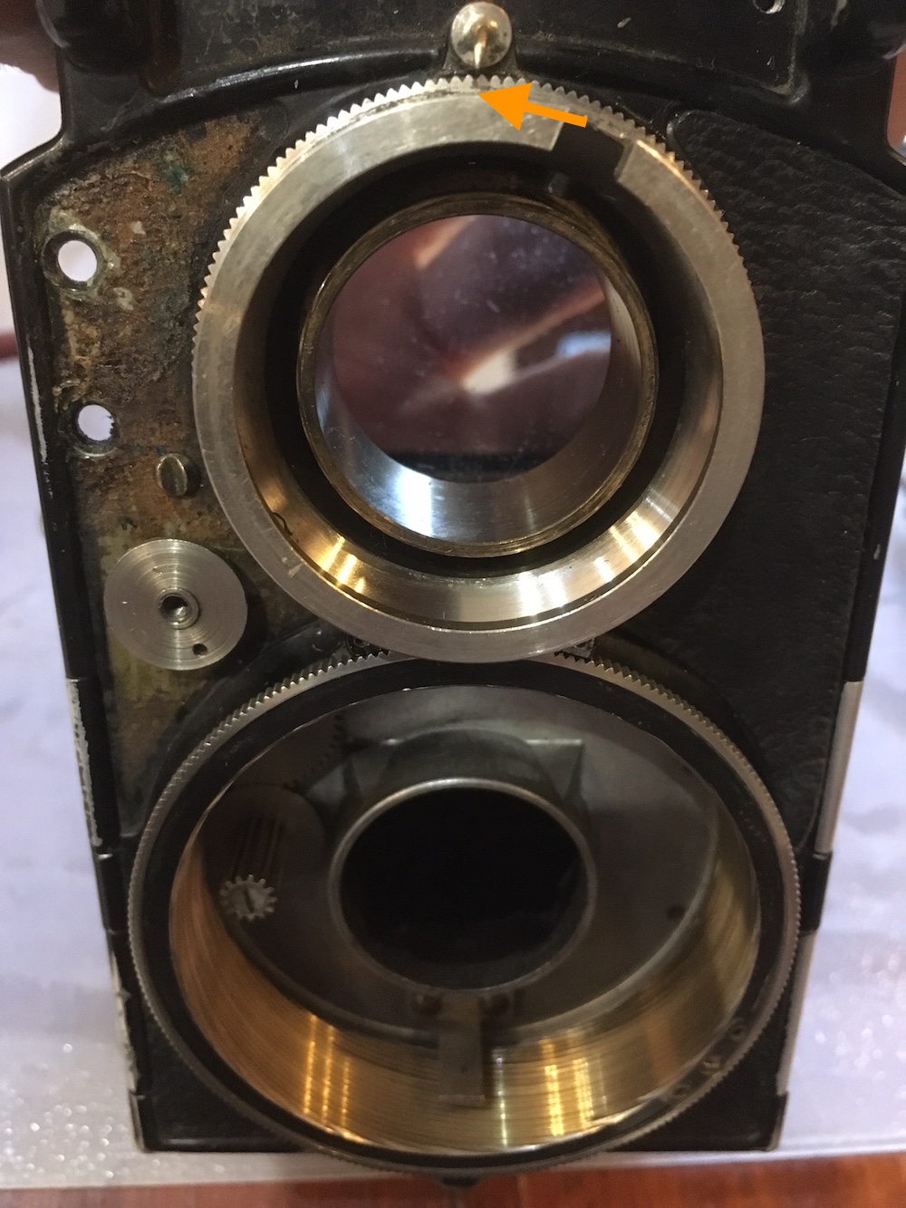

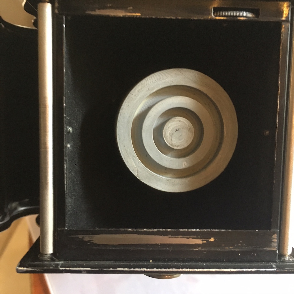

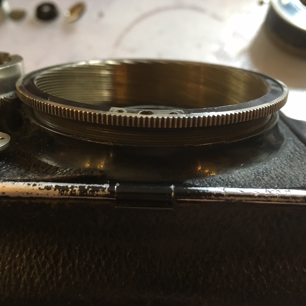

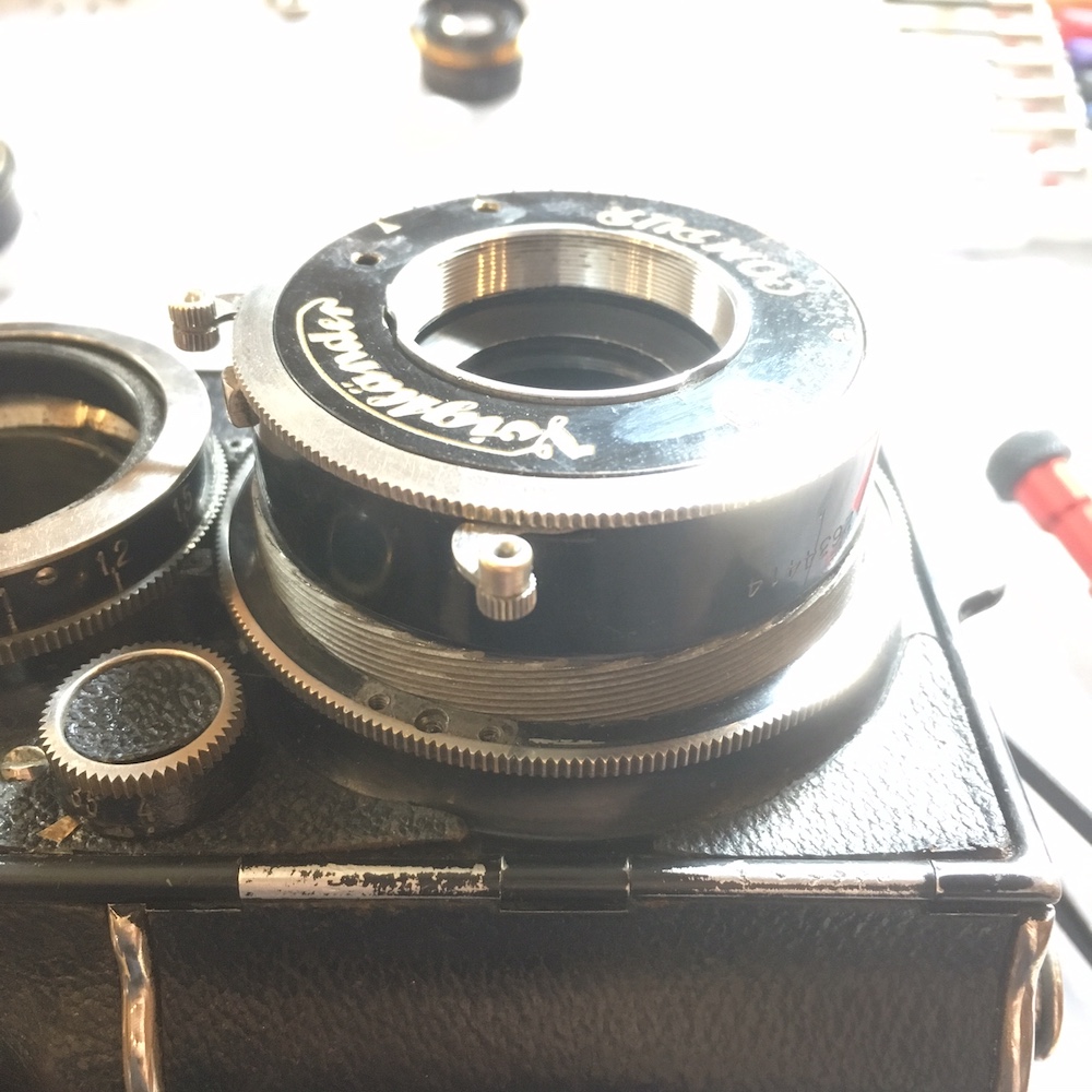

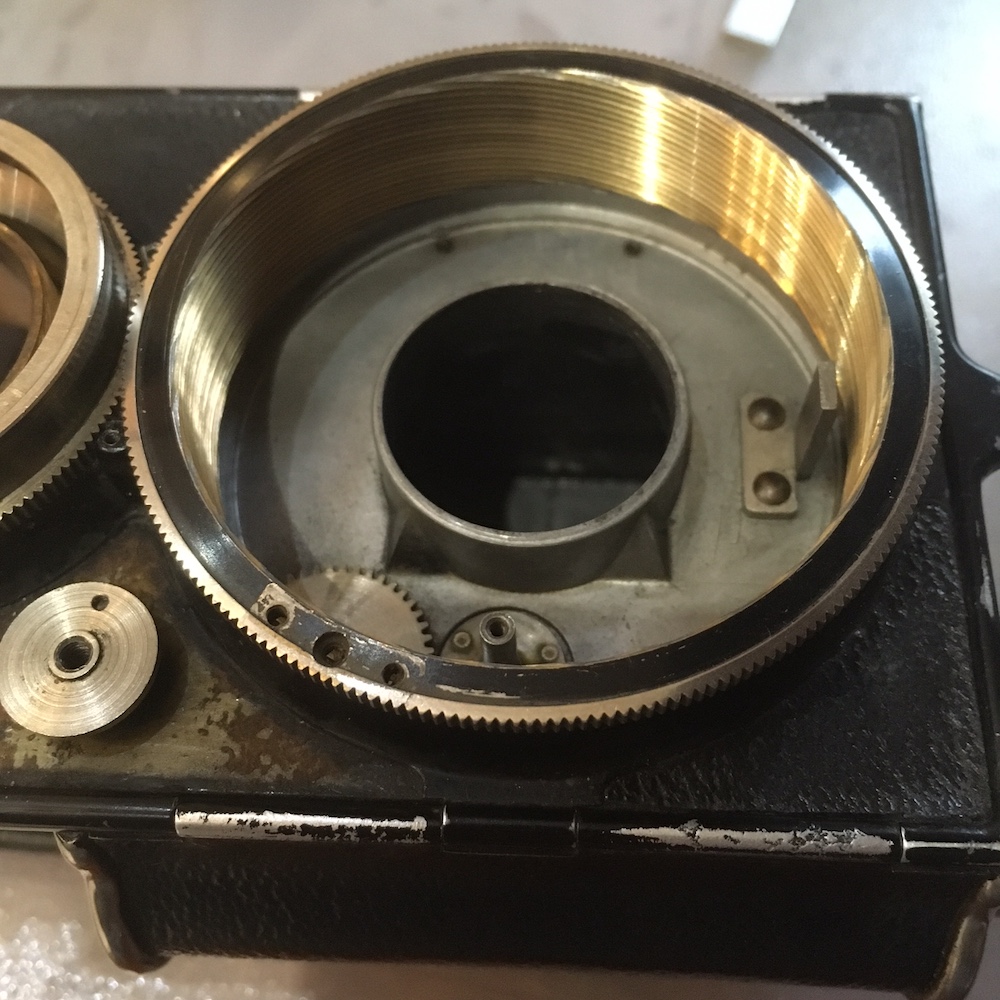

Now both lenses and shutter out, I had no idea how to take out the shutter, Im used to folding cameras so I tried what I know...
It seems I took out the rear lens, shutter remained. Could be from here? Wait! There is an helicoid and the focus is done by group, not only front lens. So I remembered how to take out the shutter from the helicoid with the Pearl III, it should be an screw somewhere, and here it was, below the focusing handle. This screw has two meanings, firstly not allowing to take out the shutter completely from the helicoid, this is minimum focus distance and to the other side another stop that is infinite and resting position. Shutter and taking lens coming out. Focusing wheel, super dirty. After some cleaning. That vertical "monolith" keeps the shutter vertical and not spinning along the helicoid while focusing, so it goes in and out for focusing purposes. Taking out viewing lens... Three marks already! wow! This is how the lens is taken out, focusing you move this knob which the viewing lens is attached and the movement thanks to another helicoid take the lens in and out for focusing purposes. How the external aperture wheel is connected to the inside of the shutter. And moves this... Ok, now everything is out, cleaned and ready to be assembled again.

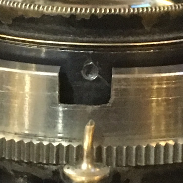

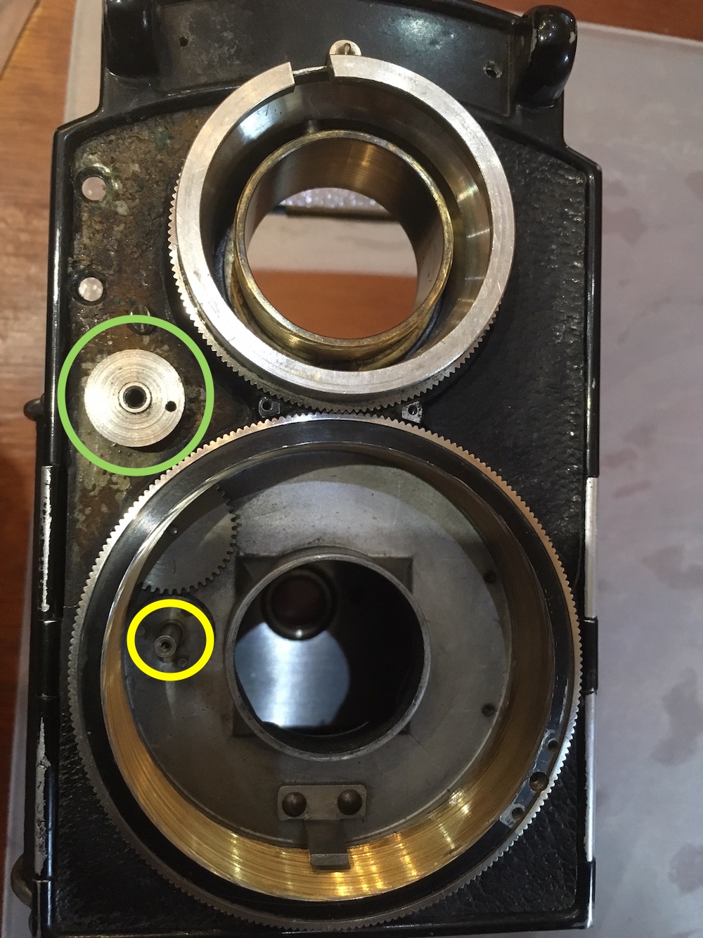

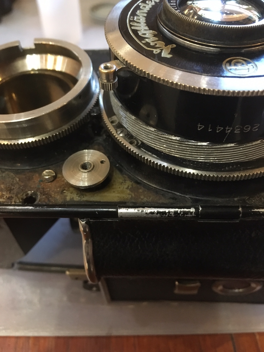

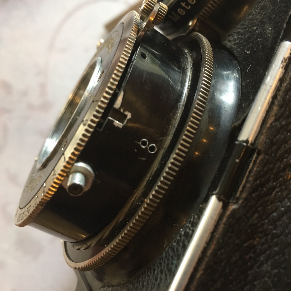

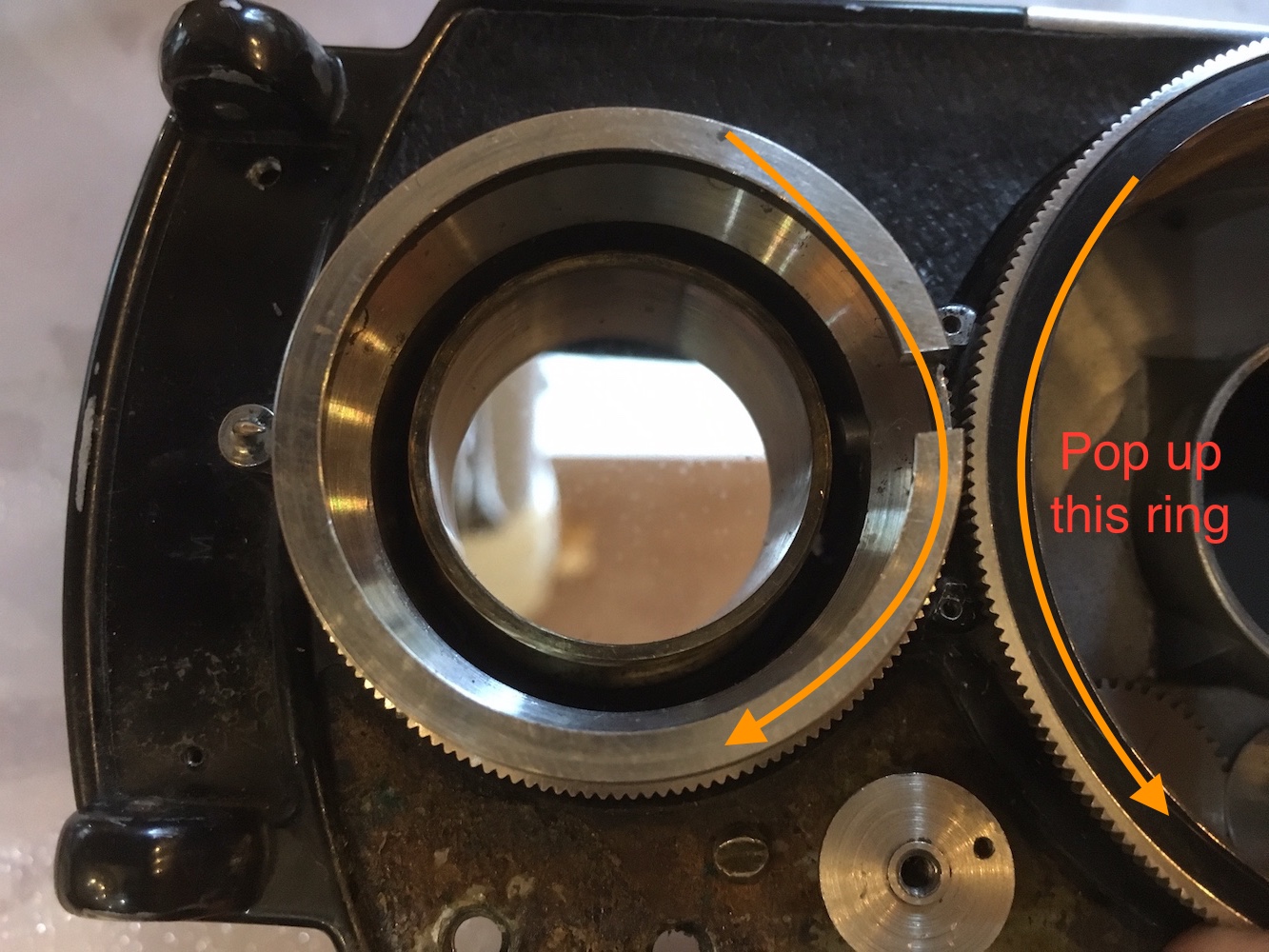

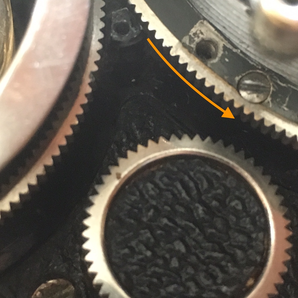

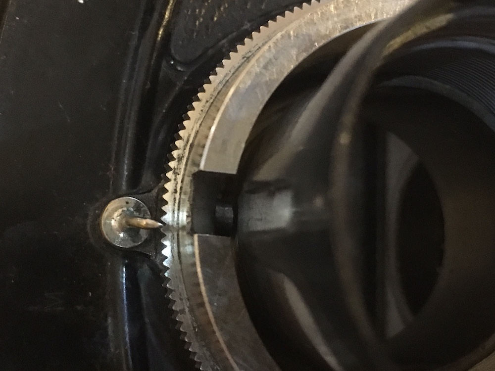

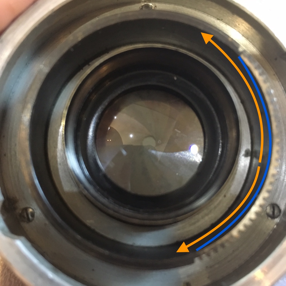

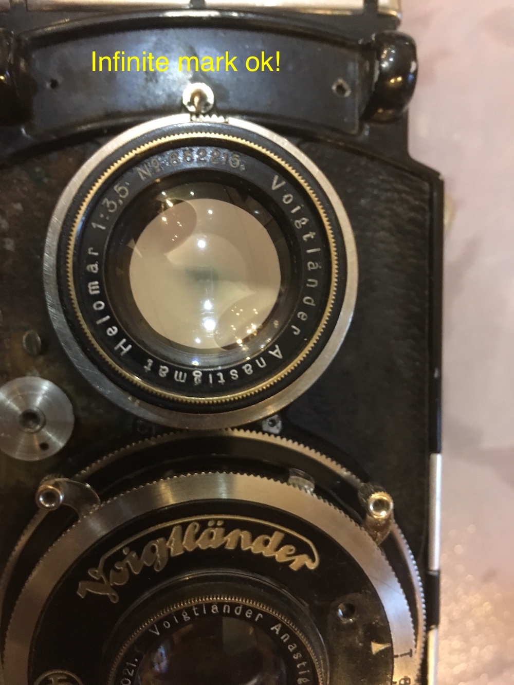

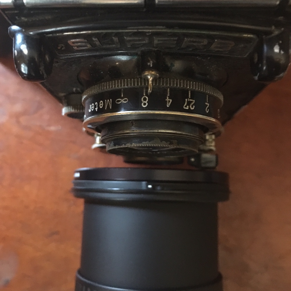

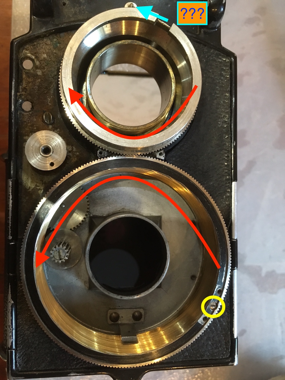

So we have 4-5 variables in play, collimate taking lens, collimate viewing lens, dent wheels go along, infinite/rest point and infinite mark at viewing lens.

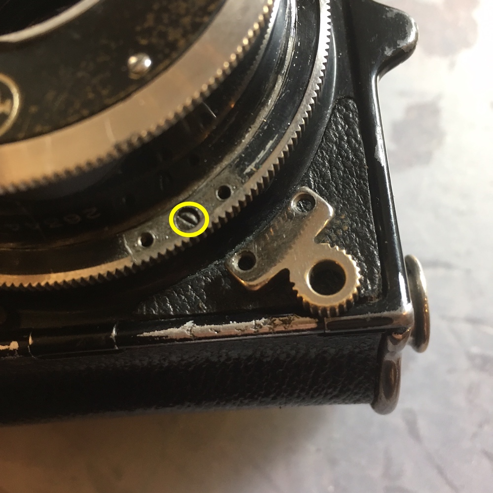

This reminded me to that circus performance where the artist makes some plates spinning in some steel rods and all have to keep spinning no matter what. Sooner or later the infinite mark at the viewing lens has to be setup, your place both rings and then you count how many dents left to that point. Now the tricky part, the focusing ring has a little gap up and down, half mm, click-clack so I used it, turning the focusing ring out there will be one moment that both rings has no contact, what I did was put some pressure to both rings while I was turning out, when I felt that they were about to loose dents I stopped turning and raised the focusing ring keeping the viewing ring still, then I tried to move this last one to see if dents had no contact any more, if I felt some resistance I pressed and continuing turning some more, I try again raising the focusing ring and moving the viewing ring, if I could then I counted how many dents left or right had to move in order to put the infinite mark in place. The first attempt was not good

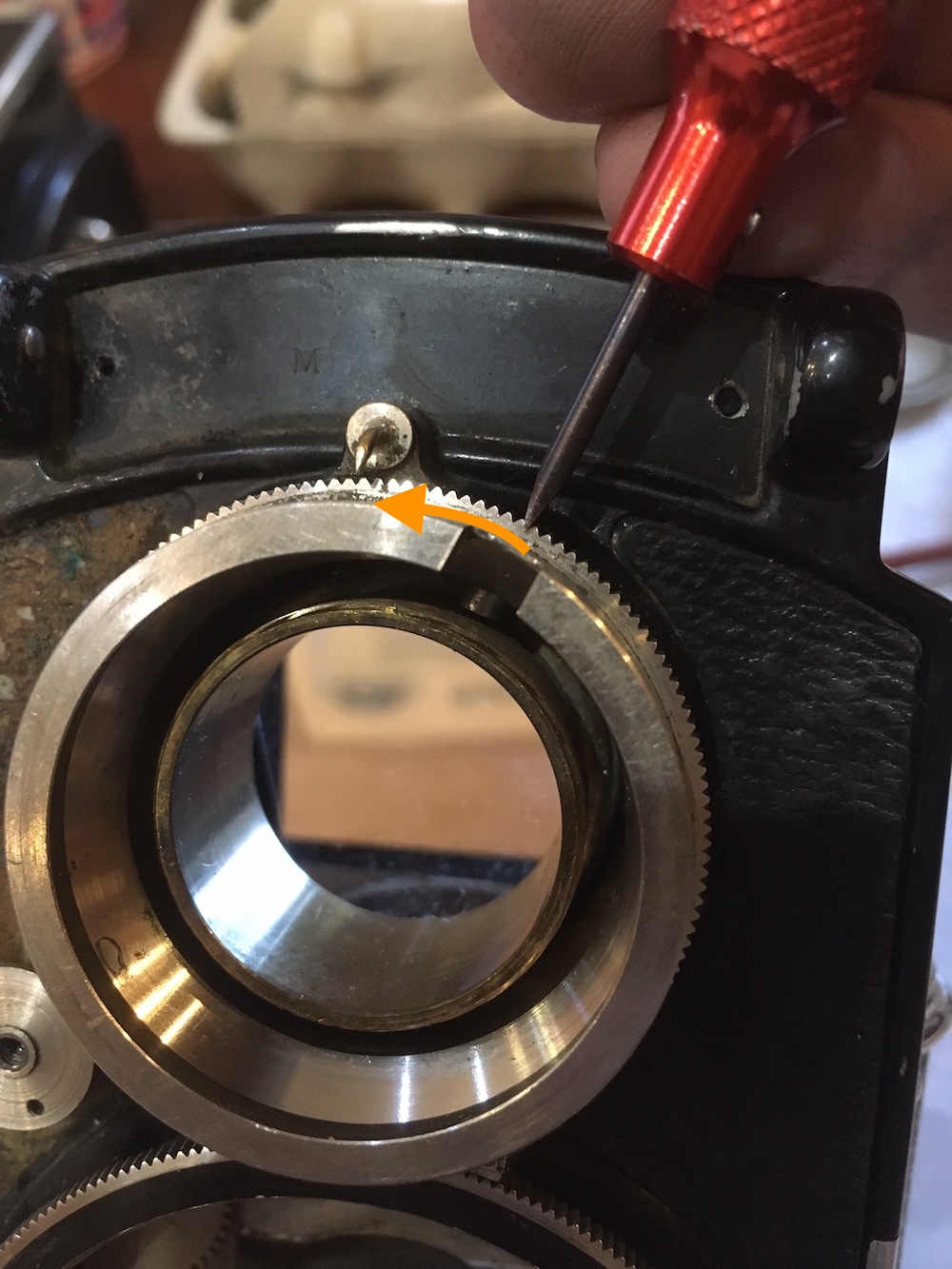

Again loose a bit this screw and start over again.

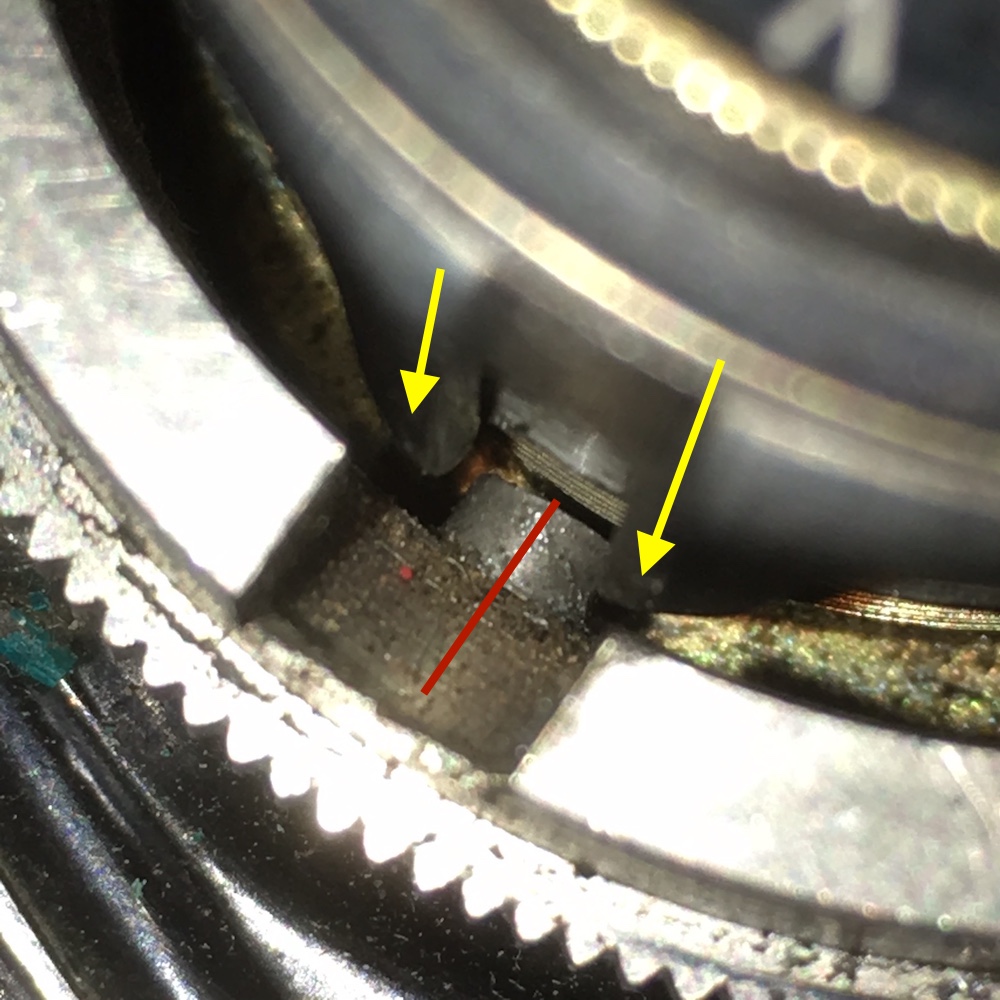

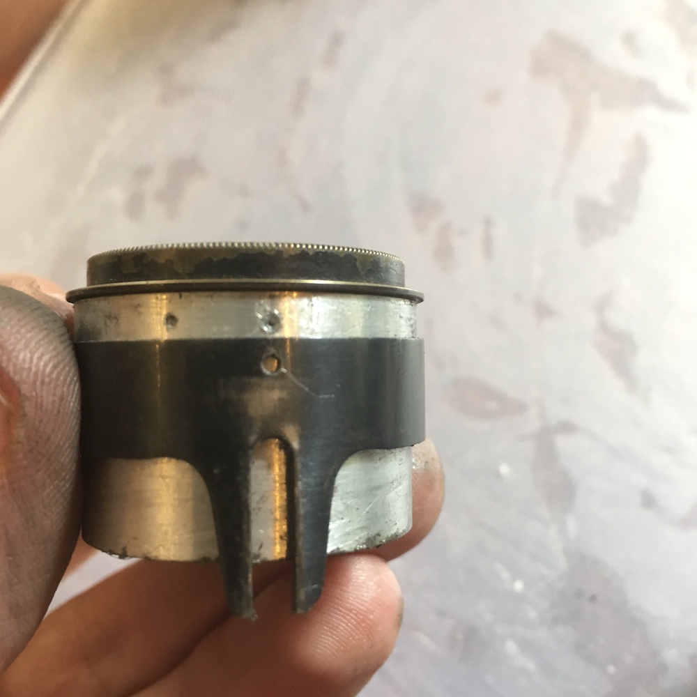

Once you get both rings "synchronised" its time to collimate the taking lens, after many tries I found this position would be the one to introduce the shutter into the helicoid.
Another way to calculate the correct position of the focusing ring is to count more dents, from the middle till the screw, 10 dents were correct!
Now taking lens is collimated and infinite mark at viewing lens on place. This looks good!!

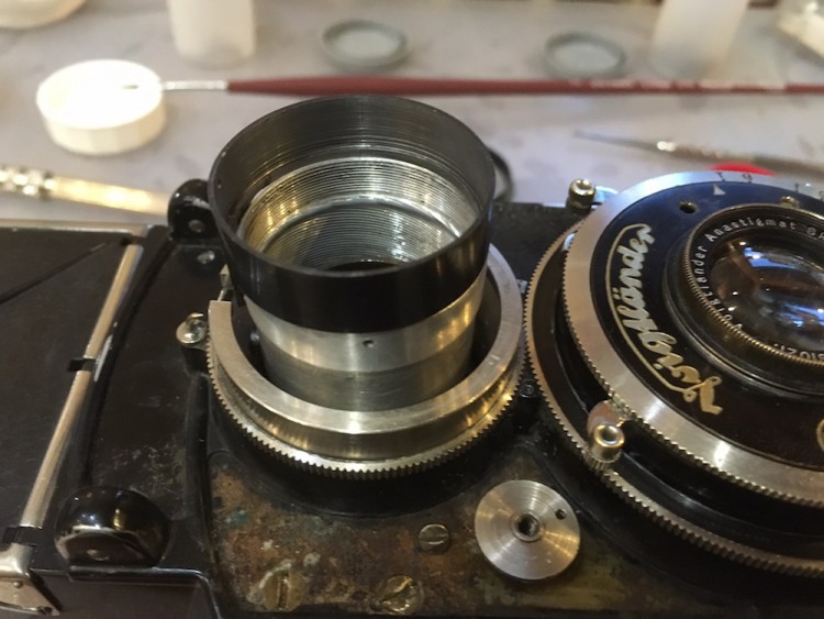

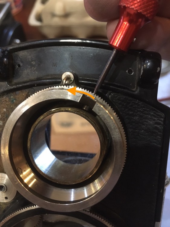

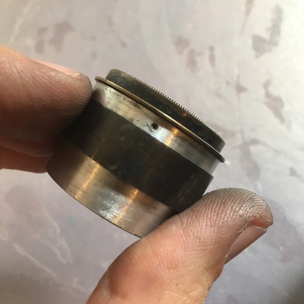

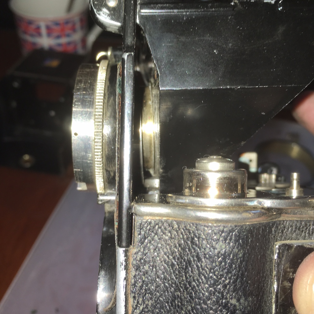

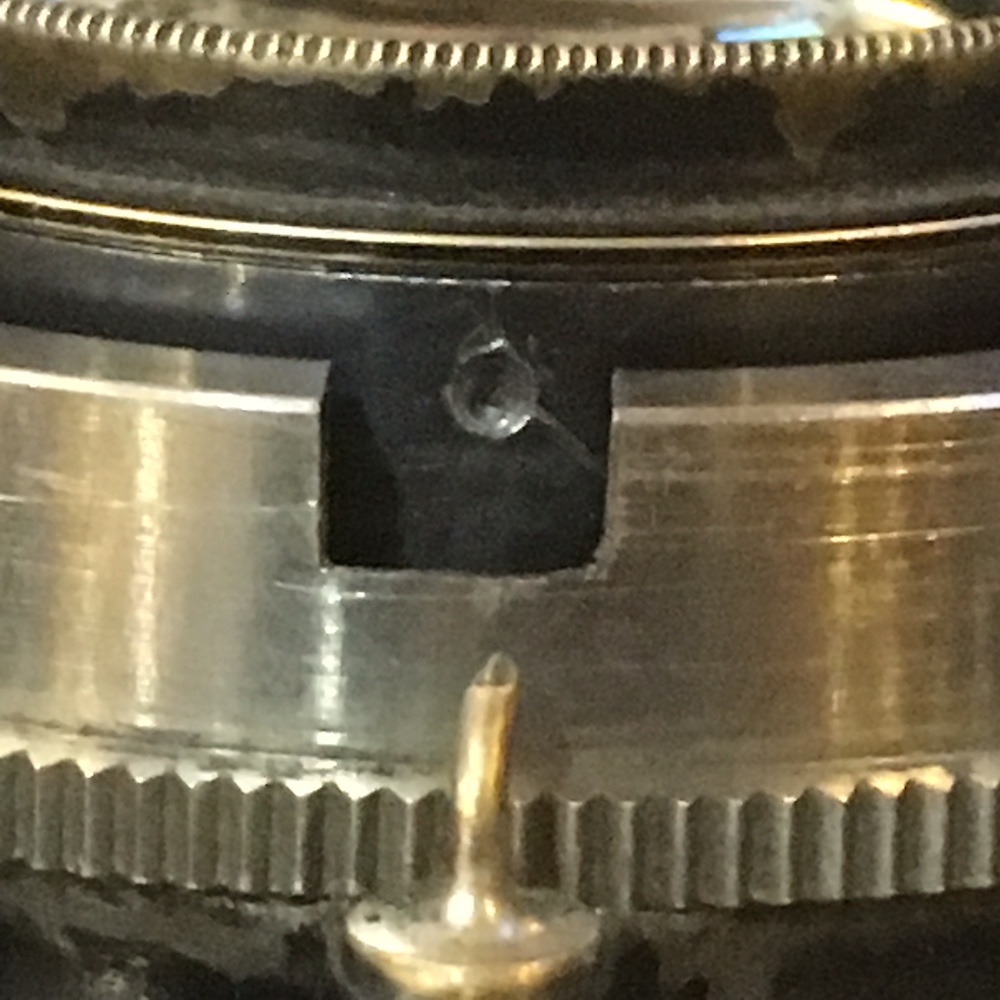

Next is to collimate viewing lens, the guide ring.
The holder.

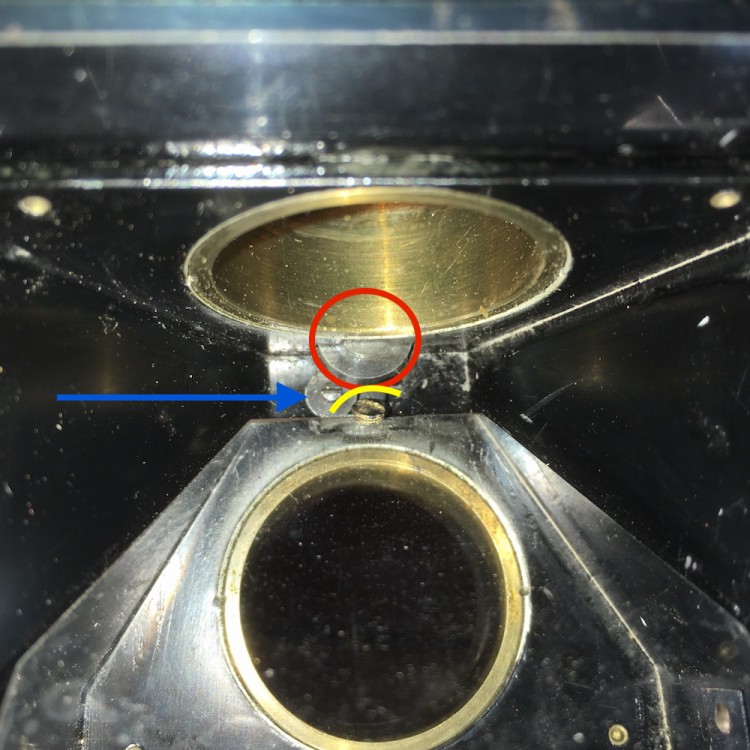

And the lens, this is the first to do now, without the guide, need to find the correct helicoid thread to make coincidence "infinite focus through the normal procedure" without moving the focusing ring AND one the three marks of the viewing lens we saw before.
Coincidence made!
At this point I though I got it, assembled everything and the day after I checked again and the collimate of the viewing lens was not correct, again to to this part, 4 tries later I got all in place, I did some close focusing and the reading taken from the Superb and my DSLR were pretty close.

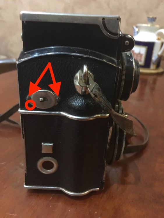

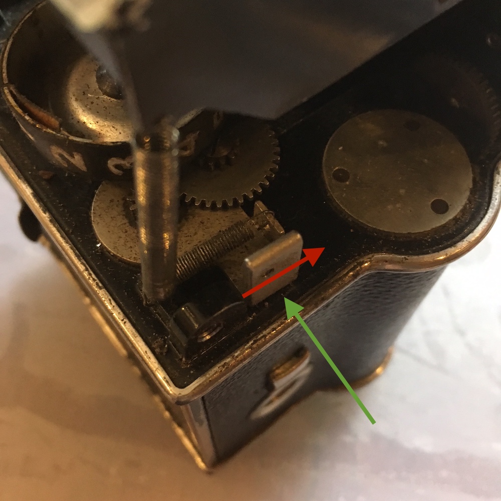

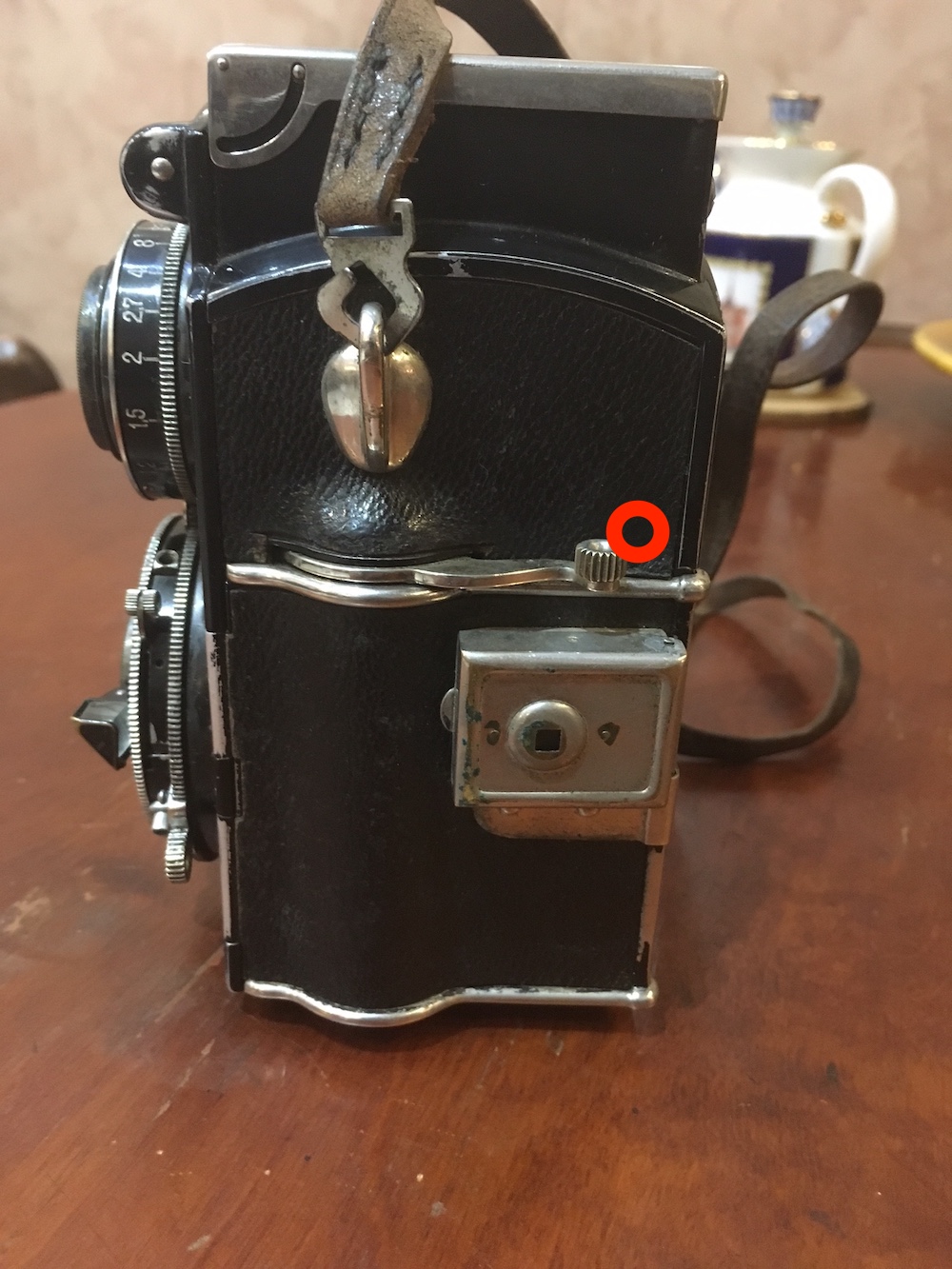

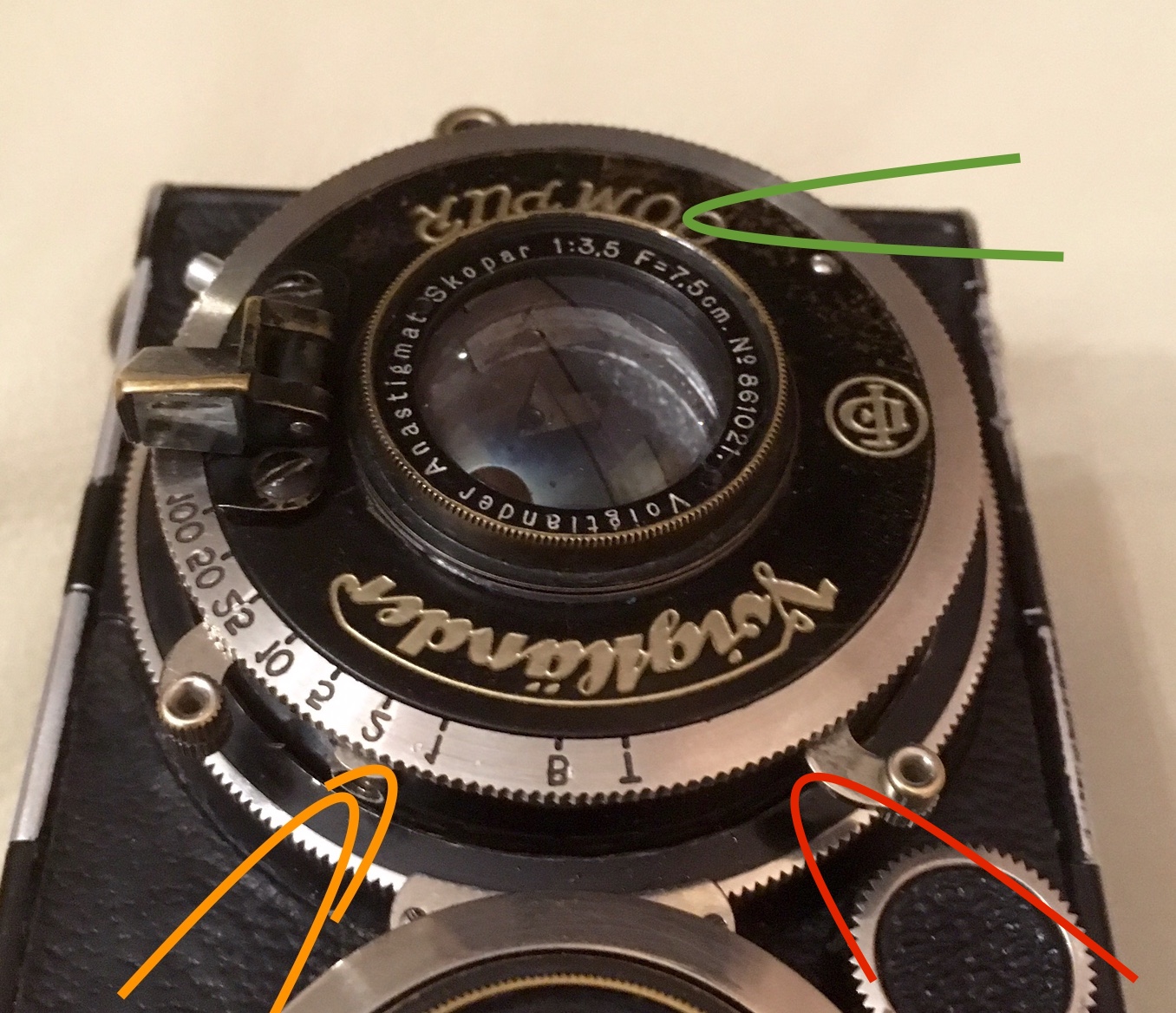

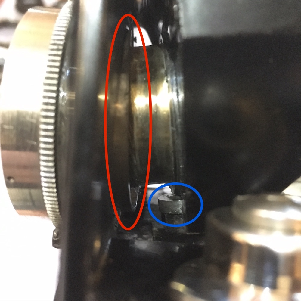

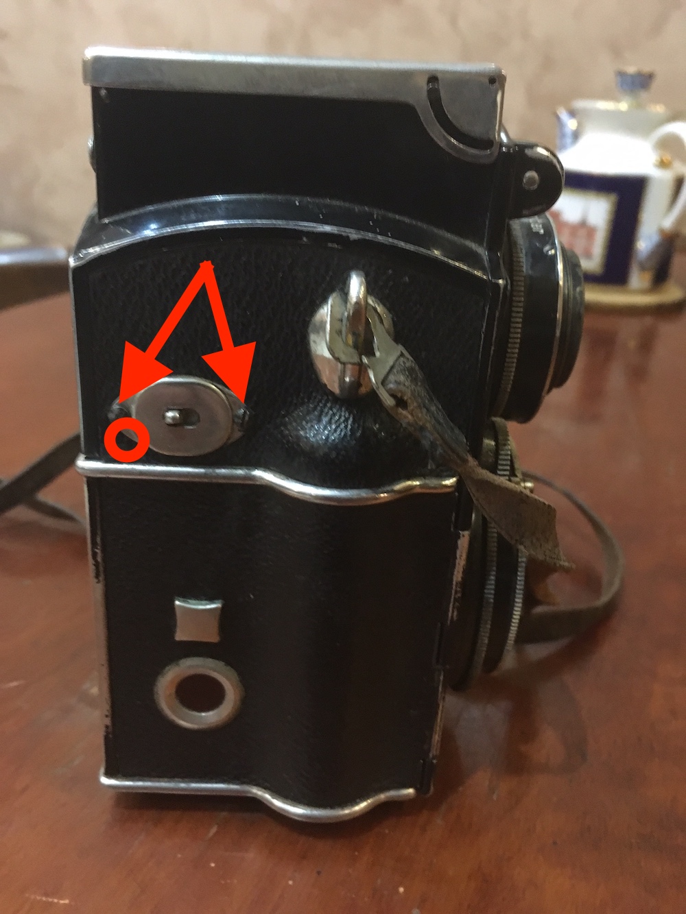

As you can see the centripetal force makes the shutter/lens move CCW, I guess this is the blurred effect I got in some of the photos. After several tests I found the way to fire the camera without this shaking.
Orange is left thumb pressing down against the force done by the shutter release leveller, green is right index finger pressing the top plate, red is shutter release with right thumb. This way is a safe way to shoot.
Still I have to check the screw at near the green "finger" if something can be done there or it's just how the(my) camera works.
