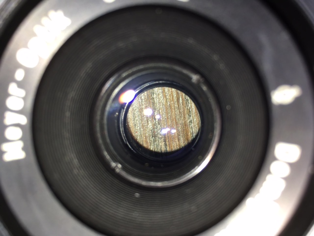

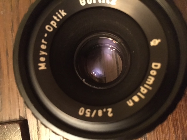

I would like to start and clean this lens:
So far I have a wrench spanner and the usual set for cleaning the lens from the outside, microfibre cloth, the spray, blower and the dust removal.
What else do I need:
Slotted screwdrivers? Size? 0.8 mm, 0.9 mm
That rubber things to take the front spiral?
eBay? anyone from Moscow? )
Thanks :)

I think that you can use a wide rubber plug to remove the front part of the lens. What works well are the rubber caps for a crutch or a cane. You might be able to find them at a drugstore.
Be careful when disassembling the lens and aperture ring, as there should be small ball bearings that make the aperture "click."
I probably would try to go in from the front. Remove the front face of the ring, and the rest of it should unscrew easily.
I think.

Not familiar with the lens. From your picture it seems that the dirt / damage is in the front element, so I would start from the front as MIke said. Good luck.
There are several videos in Youtube about disassembling the Domiplan but in M42 version; probably the aperture mechanics are somewhat different for the Exakta version.
Mr. Subbarayan_Prasanna in photo.net has many posts on cleaning / repairing Exakta lenses and cameras, you may check with him.

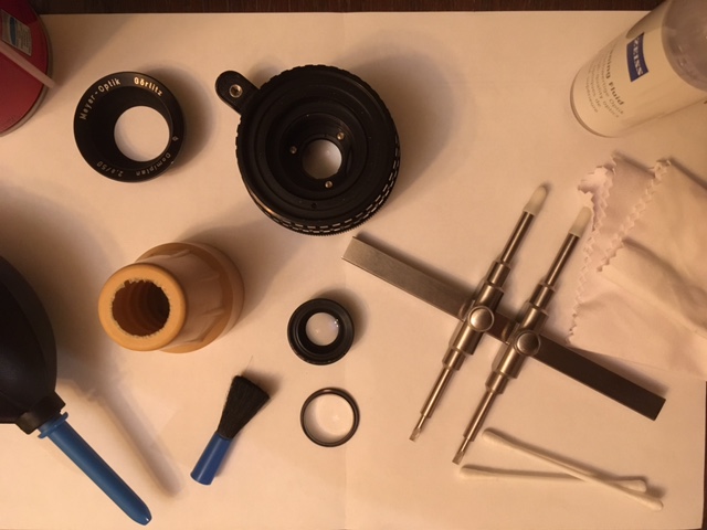

thanks for the tips Julio and Mike.
I tried as the videos about the M42 but the outer ring its not just 'pop' with an screwdriver, I will look for the rubber thing and take a look in photo.net.
Re: Domiplan 2.8/50 opening
Who has a friend, has a treasure - Someone said.
Thank you!! My first lens!! :D
The question Im facing now... How to was the microfibre tissue? :D

That looks clean! Now, to test it! :clap:
And then you will find the Exa limitations and need an Exakta body.... :twisted:
